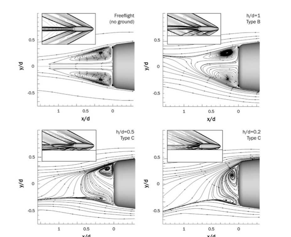

    in this example.. the aerodynamic lifting body (bullet) is unbounded on one side.. and in aerodynamic 'ground effect' on the other..

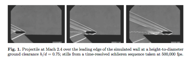

    The projectile was discovered to experience a marked pitching moment, initially nose-downwards at the high end of type C reflection interactions, then more strongly nose-up with contin- ued decreasing ground clearance, as the pressure distribution over the rear of the projectile was increasingly distorted by the build up of high pressure behind the series of shock/ground interactions.

    but as you can clearly see in the research, a bullet shot over a fixed surface within a caliber definitely is acted upon by its shock wave
    its not my paper but was referenced in designing future hypersonic 'things' if you get my drift
    here you can see clearly that at a height of .75 of projectile diameter the shockwave reflections are interfering with the body, and the tail is loosing lift pointing the bullet up, at 1.77x diameter the reflection passes behind the projectile
    projectile shape effects mach cone shape, effect varies with ogive shape/ bullet length / velocity / atmospherics etc... for example here.. if the bullet were much longer, even at 1.77x diameter height, the reflection would hit the tail of the bullet.

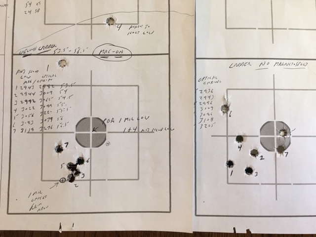

    I was doing testing and break-in on a new barrel for my 6.5-284.. it dumps a lot of gas and un-burned kernels of R26 because they gave me the wrong twist rate and the bore feels a bit oversize as well.. its on its way back to be looked at.. but here was an interesting fiding
    my previous barrel from the same maker would group .25-.35" groups at 54g and a 53.8-54.2 spread at 2 seating depths would group inside .5 so a very nice node at 3050fps... this new barrel is 150fps slower at that same powder load so something is off with the barrel.. any who..
    the last range trip I decided after 50 rounds to shoot another velocity ladder x2 since nothing was grouping with this barrel and I didn't know it wasn't mfg right yet.. . one for velocity data from 53.5-56.5 which is normally over 200FPS spread... the results were bizarre talk about tuning device...
    I fired some fouling rounds the first 3 grouped just around .5" and the next 3 were a diagonal string almost an inch.. not looking good
    strapped on the bayonet and shot the first 7 round string, on the left target. shot 1 I didn't hold low with, forgot the shift, and 4 forgot as well.. the rest were shot holding 1 mil low at the center of the target, shift was right about .7mil .. but look at that group...
    a 200 FPS spread and with the 2 shots superimposed back into the group by dropping them 1 mil.. I can cover 5 of the 7 shots with a quarter
    the target on the right was the same loads and seating depths shot again with the bayonet off... its all over the place...
    the barrel was allowed to cool fully between groups.. now some of that could be the barrel fouling since the powder is burning dirty .. no pressure seems to build with the wrong twist and possibly slightly oversize bore diameter.. also its melonited, a first for me on a precision barrel and that is supposed to be slicker but this barrel tends to slow down after some shots not speed up like most. again I am figuring its fouling but look at that group or lack thereof..
    POA is the center of the target with no hold..
    and you can see my optical crony struggling with the lighting conditions magneto speeds on the left optical on the right. on the right target optical only
