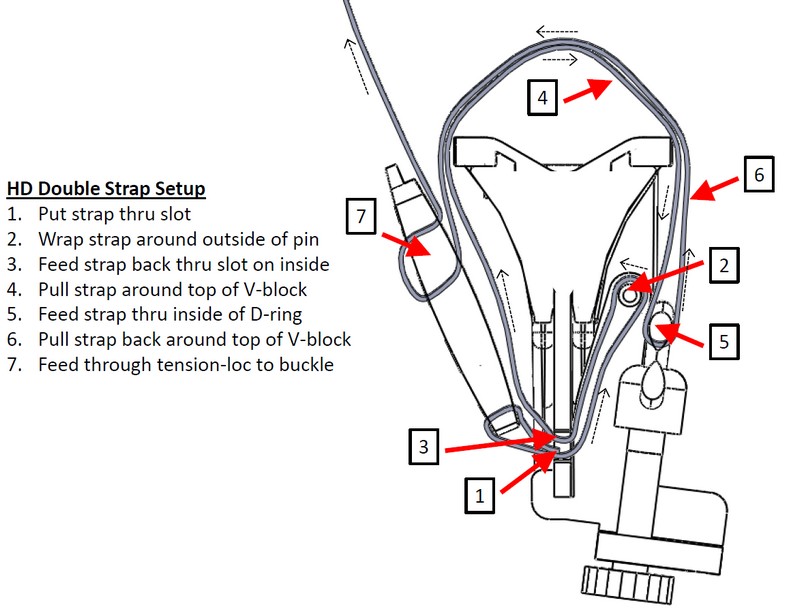

Make sure that you bayo is tight to your barrel and not moving when the rifle recoils.
I had to re-route the nylon strap as it was loosing after a few shots.
