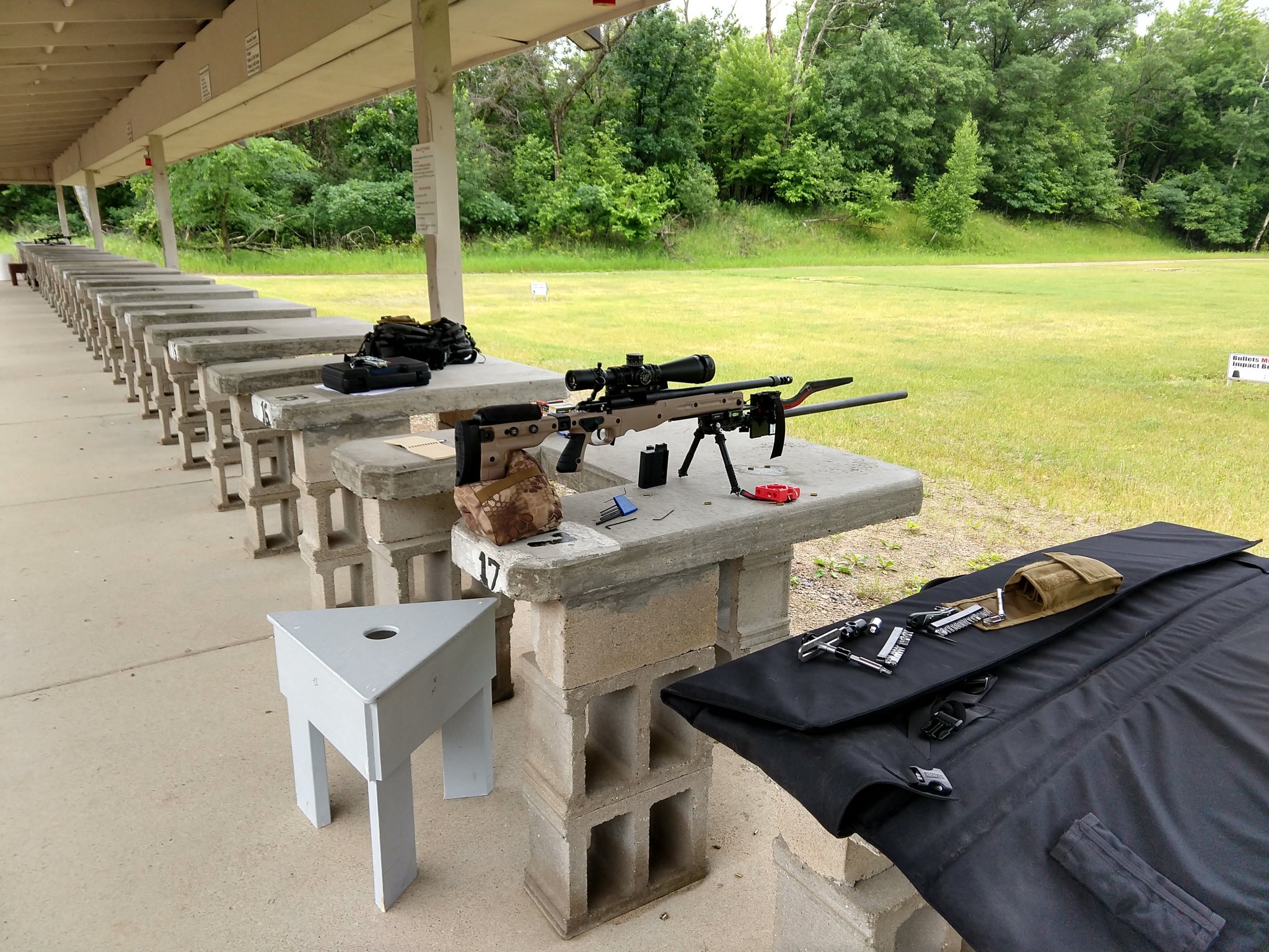

I have the wiser precision and highly recommend it.
7102335
It looks long enuf for suppressors. The rod looks super light weight.
My concern there is the bayo mount to the rod. Looks flimsy / may move under recoil. Your experience?
It is plenty long for a suppressor. I have ran it on my 308 26" AE MKiii shooting 185 Juggernauts at 2780 with an area 419 brake and have never had an issue with the bayonet moving under recoil. The screws hold it tight.
Reactions: garandman
I know this is and old thread but didn’t want to start a new one.
I’ve looked all around but before buying a Wiser Mount looking for some help. I have a MPA chassis and a Manners PRS2 with a full 419 arca rail. The rail on the Manners doesn’t sit parallel to the bore, will the mount allow adjustment so that the magneto sensors will be parallel with the bore?
Thanks!
Thanks!
There should be enough play/adjustment to get it level. My foundation bottom isnt parallel to the barrel and I can get my wiser mount and bayo to line up.
Reactions: Browerka
