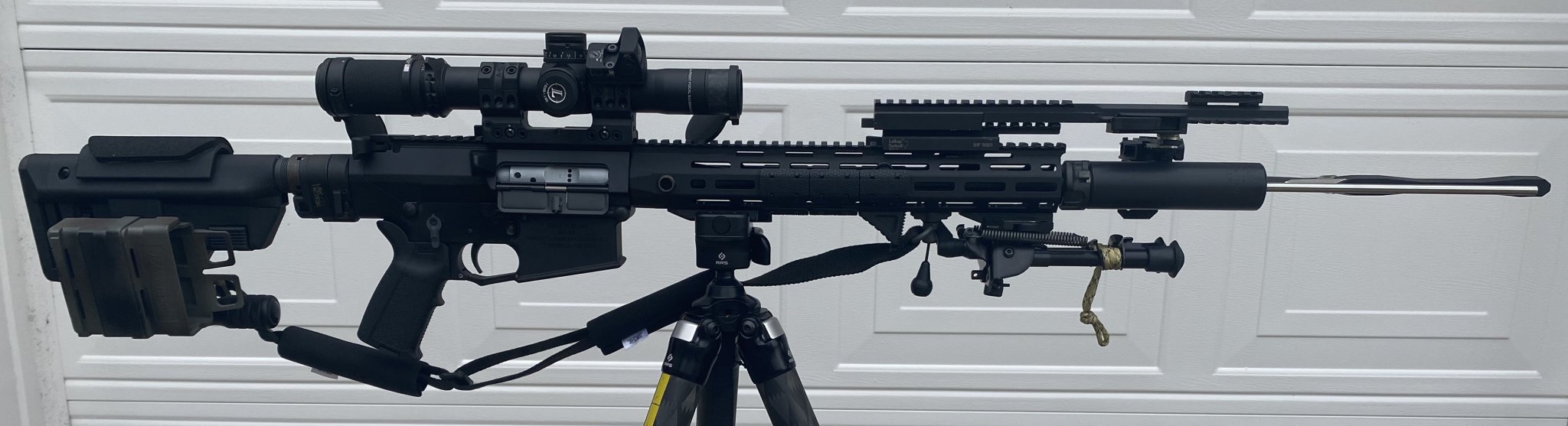

I've been using my MSv2 since they came out in 2013, but the inconvenience of it, has been my only real gripe with it. So I just bought one of these...
It's basically a LabRadar, but pocket-sized, and bluetooths to your phone to store your shot strings and data. You can even make profiles for each rifle, and it will store the shot data and weather conditions data using your phone's GPS under each profile.
And a nice solid & sturdy aluminum Neewer mini tripod on Amazon and a Sunwayfoto 3" pic rail ARCA mount.
Mini Tripod
Sunwayfoto 3" Pic ARCA Rail

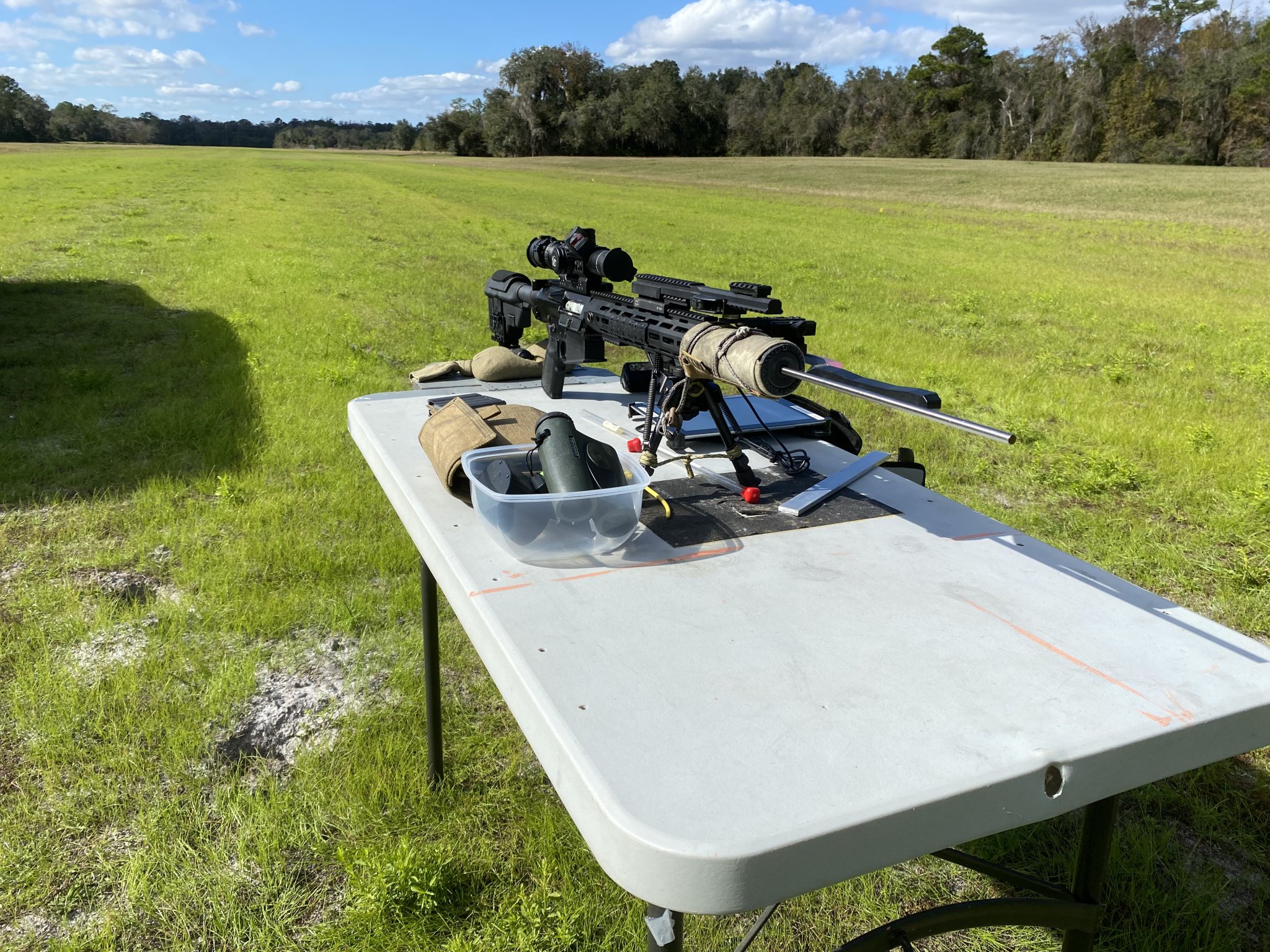

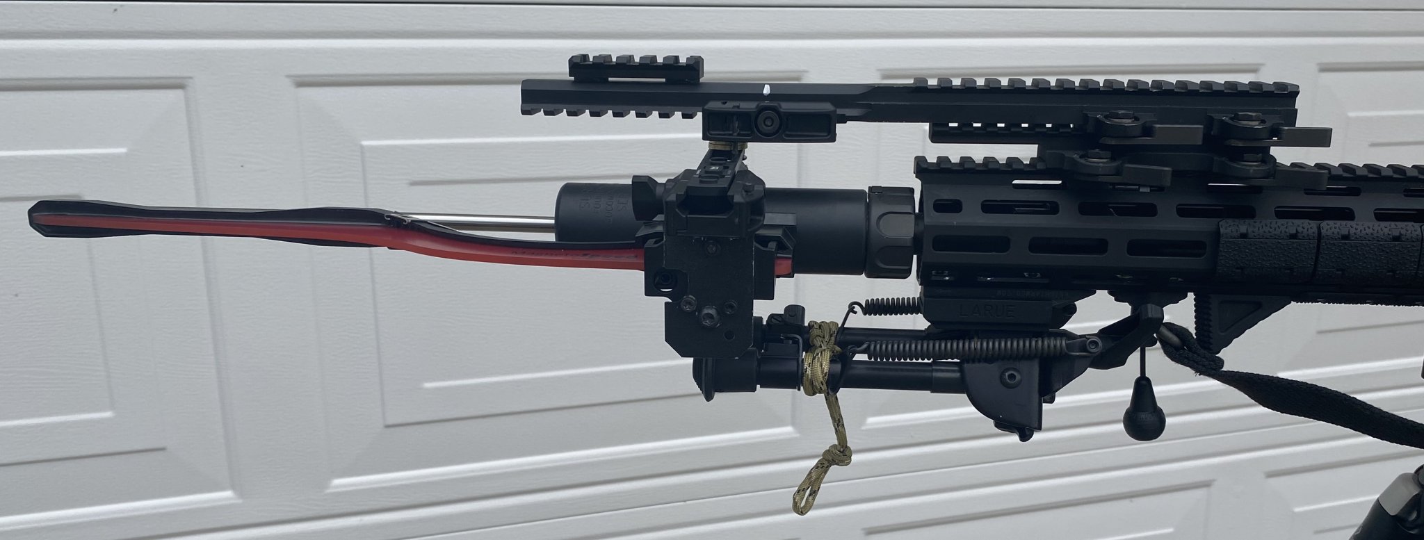

I am using the Labradar now so the MSV3 just sits. A few years ago many of us were configuring off-the-barrel alternatives for using the MSV, especially with suppressors. Combining some simple picatinny rails you can easily fabricate a 3-axis adjustable system.

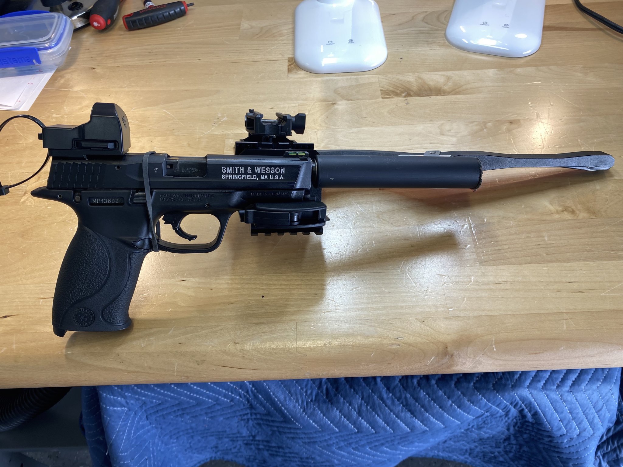

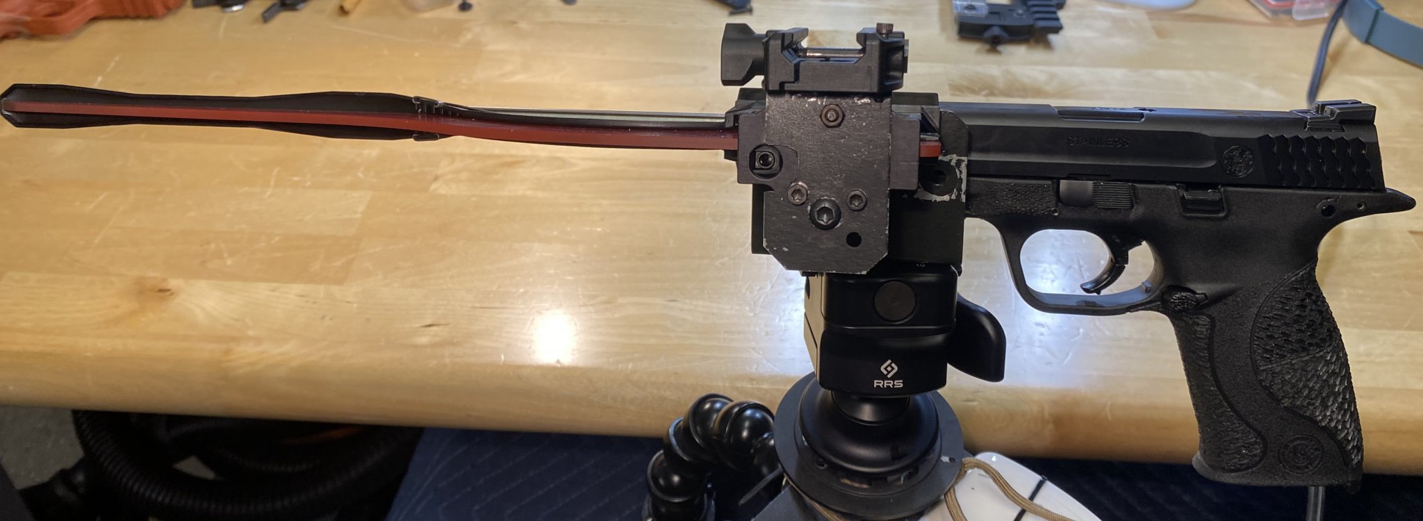

A simple L-bracket and a QD mount allows for use with pistols supressed as well.

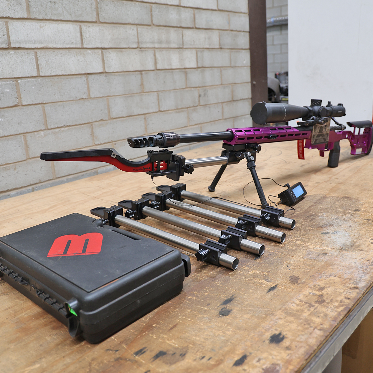

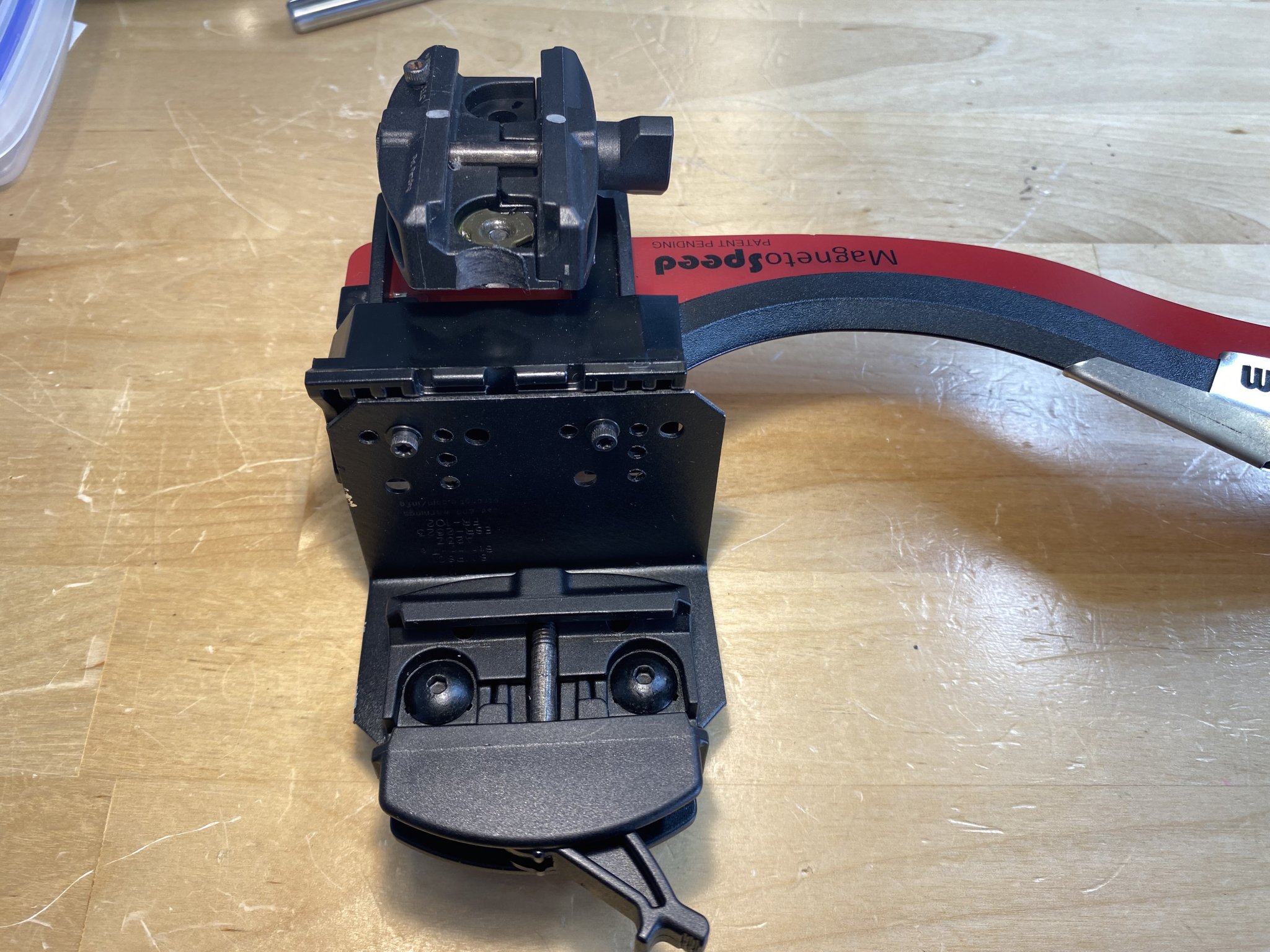

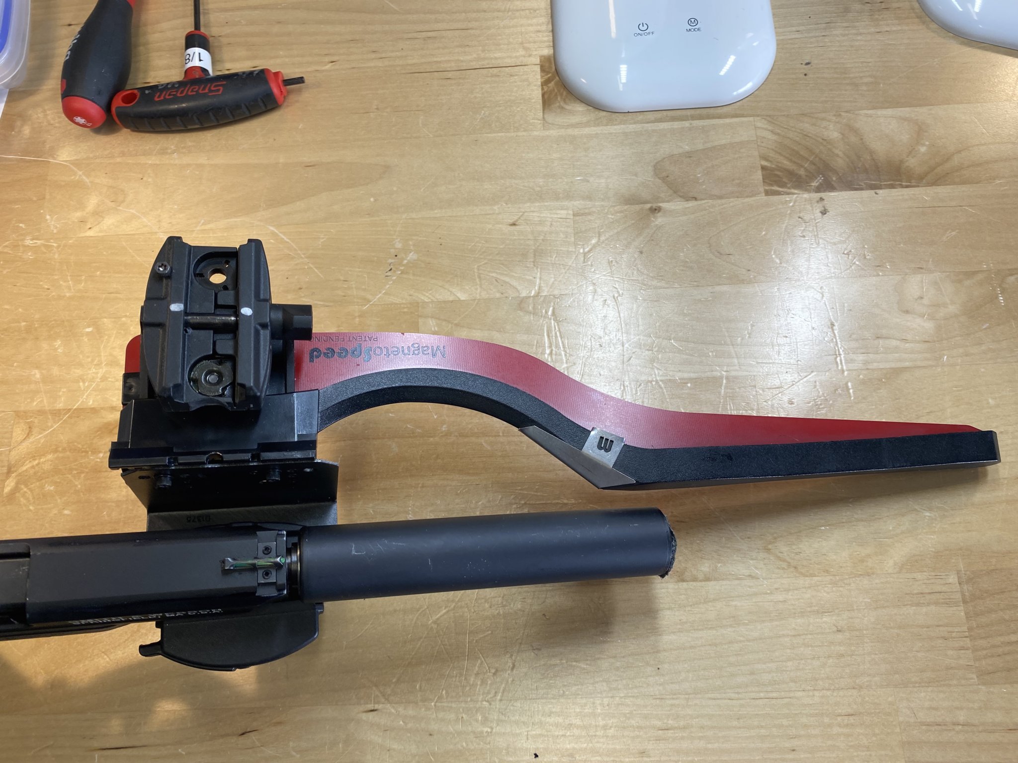

I made it because I needed one. I made a few spares for mates. Attaches to a pic rail on your stock or chassis, and I used a arca->pic rails adaptor for my chassis.
The magneto unit is held on via 2 screws, once you remove the fabric strap. The 3.5mm jack can be put in the bottom or the back, both work and have clearance. The block that the magneto attaches to is arca on the back, so can easily slide up and down for vertical adjustment. The long stainless tube also can slide in and out of the clamp at the back, but having it with an arca mount made it easy.
I have designed a display unit mount for Mlok, but haven't made it yet.

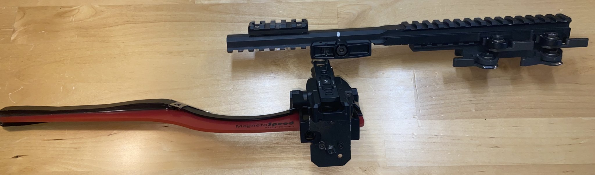

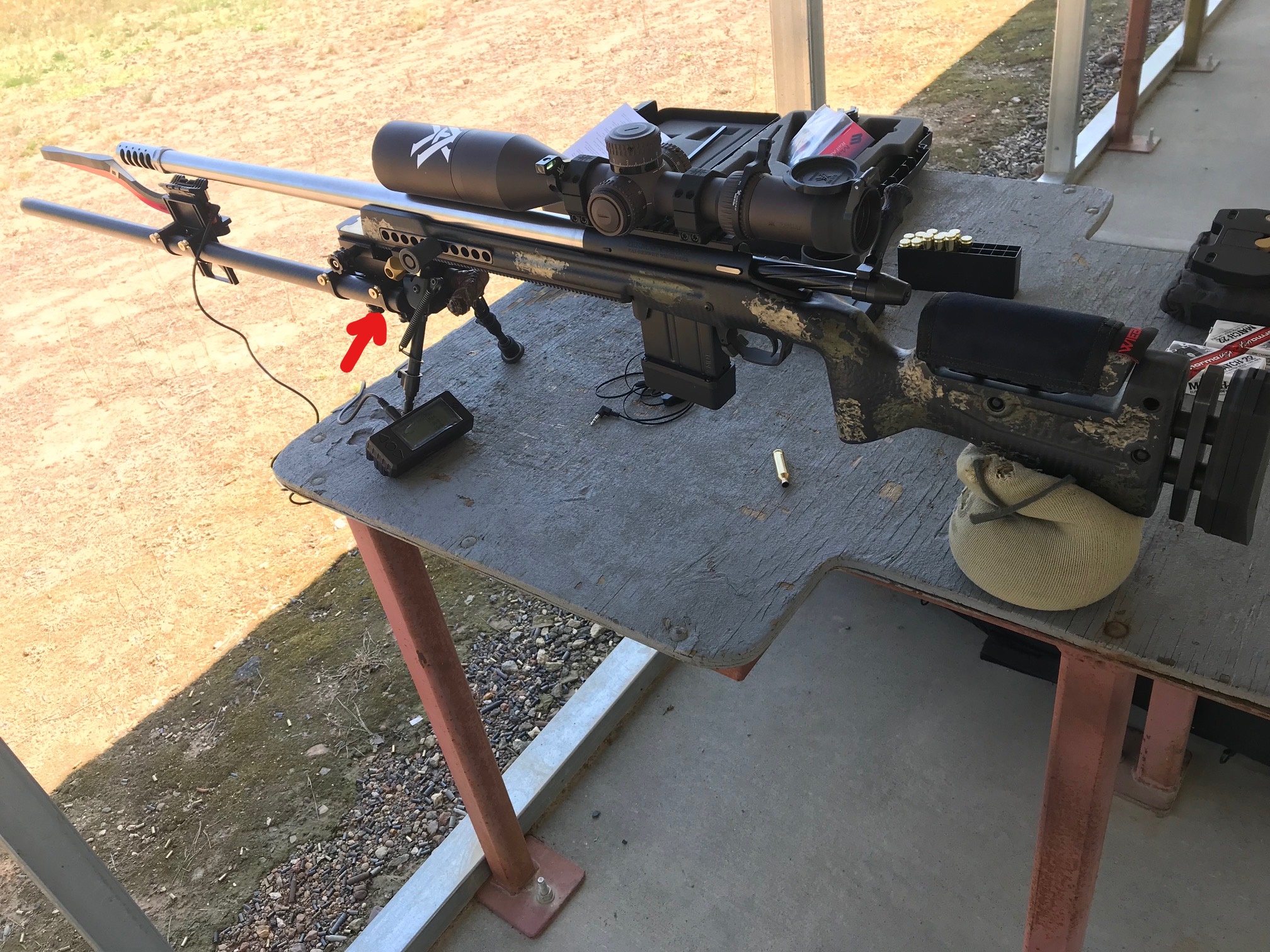

I use the Wiser and like it a lot. I use it with everything from an 18" Vudoo out to a 28" 6.5 Creedmoor. With and without brakes and suppressors. I like the Wiser has an angle adjustment so if you have a different angle on the forend you can adjust the bayonet to be flat. It's easy to slide it on and get it adjusted.
