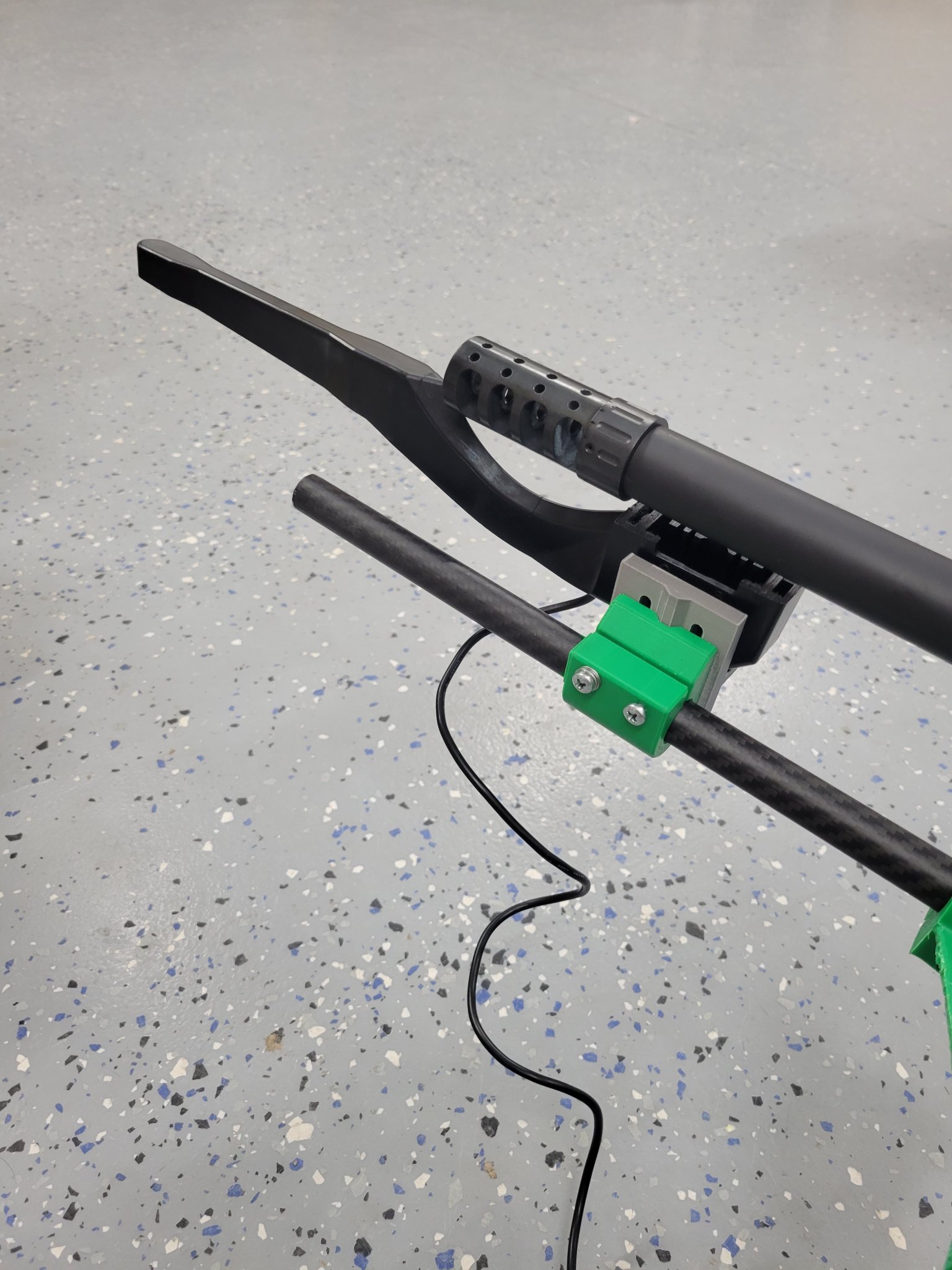

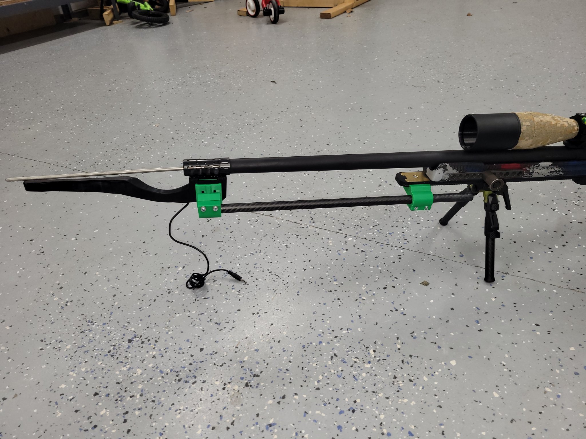

I 3D printed a mount setup for my magneto speed which includes an arca and pic mount. The support rod is a carbon fiber rod I got off Amazon.
Hopefully I'll report good results tomorrow!
A little more progress but yet some tweaks still need to be made .
I did have to cut the Sporter strapoint back about 3/8" to get it close to the larger barrel and to work for suppressor. I know it was intended for that but it is now

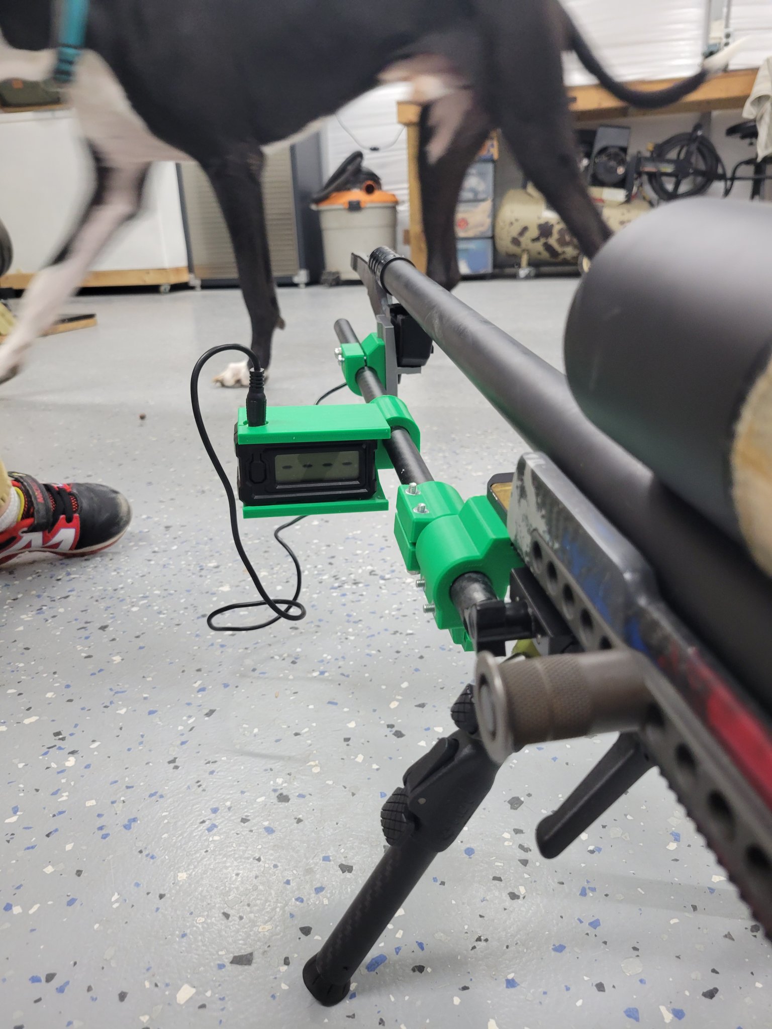

I redesigned the magneto speed mount for more travel,and to work with the modified Sportster bayonet. I made a display bracket that will attached directly to the carbon fiber tube to keep everything together.

One thing I really want is the readout mount for my carbon tube. That is one of the best parts of your "design/mod"
