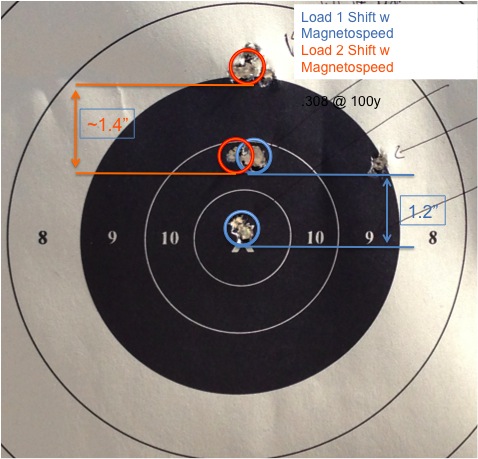

Have any of you guys shot in the rain with it? I was out in a field trying out some new loads, when a light rain hit. Well immediately my shots stopped hitting paper (or going through an existing hole, but doubt it). Water was beading up on the bayonet and I think when the bullet hit the water beads it deflected upward above the target.
Something to watch out for...
I've also stopped using it for initial load development, and only throw it on once I have load that shoots the best at 300 just so I can get my come ups. I'm 90% sure it doesn't affect groups as long as it's on snug and doesn't shift, but I've had it shift on me a few times and it will move POI enough to turn a 1/2 moa group into a 1 moa group.
