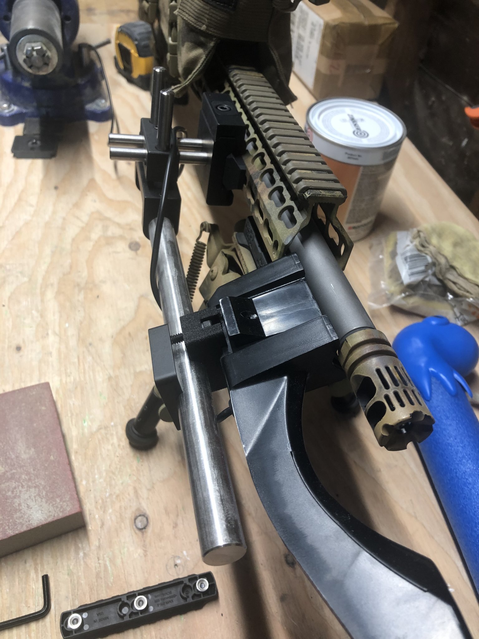

Any chance you can post a pic of it mounted to an AR?

It doesn't work with some slim rails, not enough clearance. I can't remember if it was my fix and hybrid that didn't work or srs and 338 ultra. I swapped out the offset rings it came with some cheapo high or extra high rings from Amazon.
Other than that it's easy. I just leave the magnetospeed and everything on the rod. Clip it on the gun with qd levers, tweak the bayonet position and shoot. No tools required. It's very stable. Works fine on a 24" barrel + suppressor, 13" handguard 6.5cm.

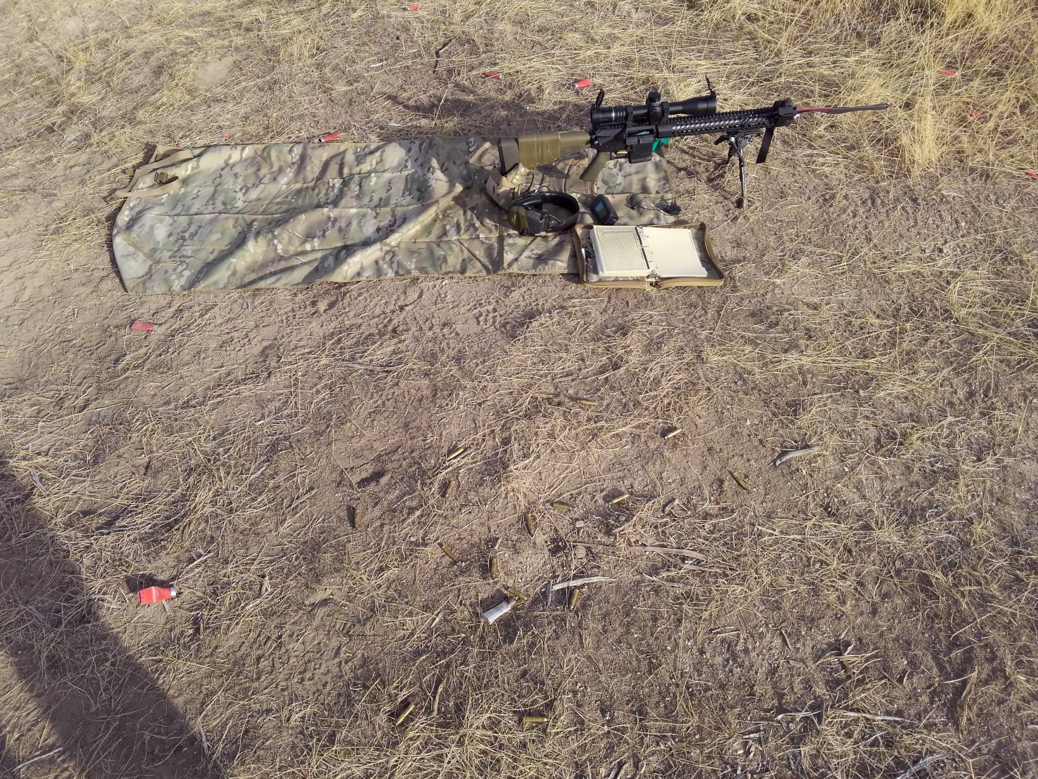

I've always used the existing strap setup. I position the unit @ 1:00 so when I crank it down, the strap tries to pull the mount toward the top rail. It stays straight and doesn't move on me when shooting my 5.56 gun that has a seekins 15" handguard and 16" barrel. Sorry, this is only pic I have
