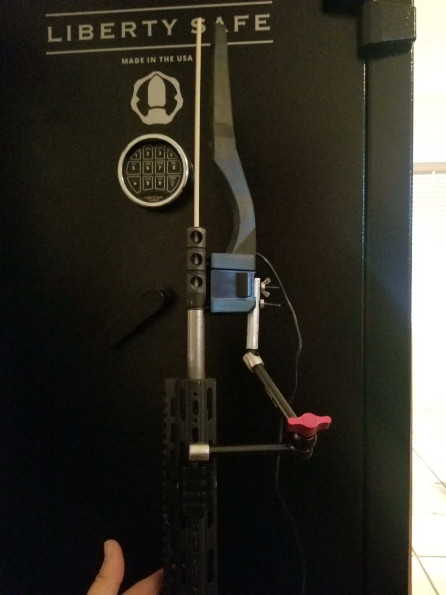

I have the Wiser precision and it gets the job done, however I think it could be redesigned and more user friendly. Switching from a parallel stock or chassis to a stock/chassis that tapers at foreend is kind of cumbersome. I have been looking at the M/k machining just have not pulled trigger due to the pre-order.

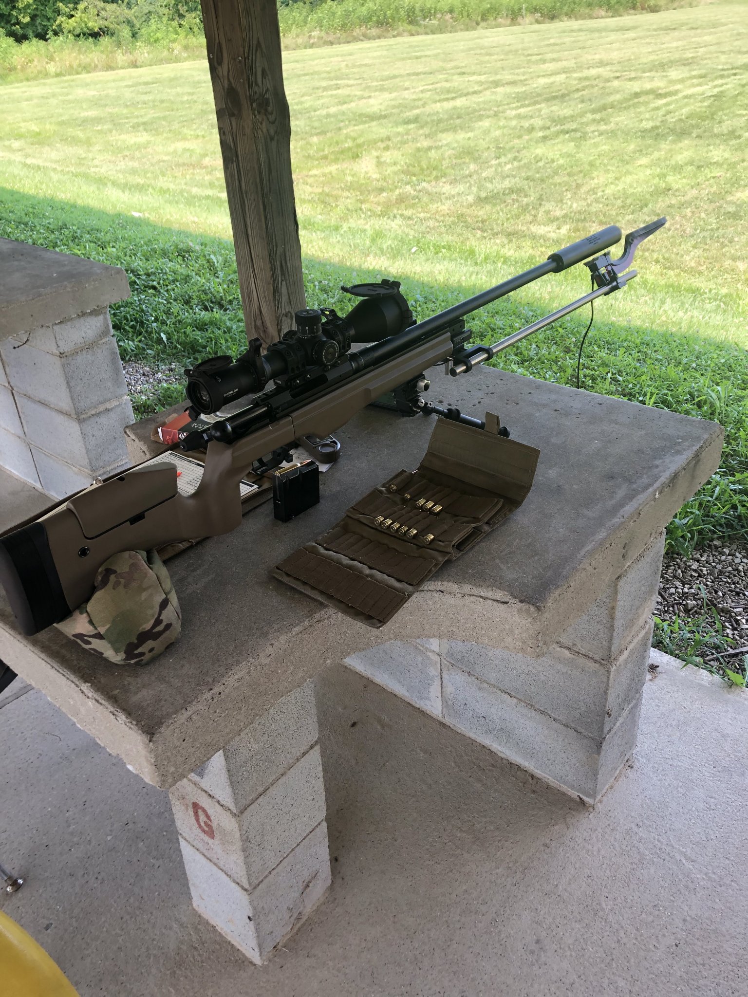

MK Machine Gen3 is working great for me. It’s easy to setup and rock solid.
Here it is attached to the spigot mount on my TRG with 24” barrel and suppressor.
