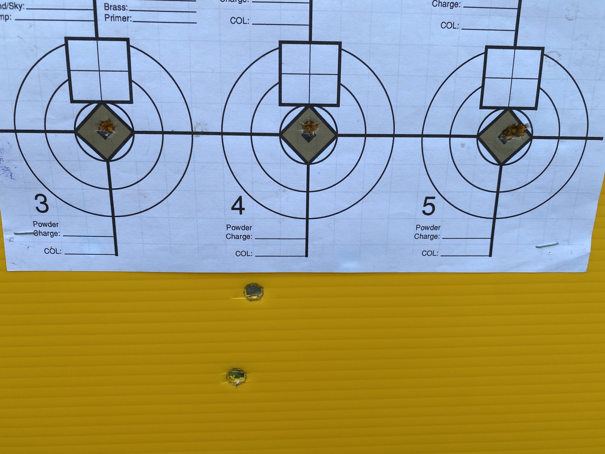

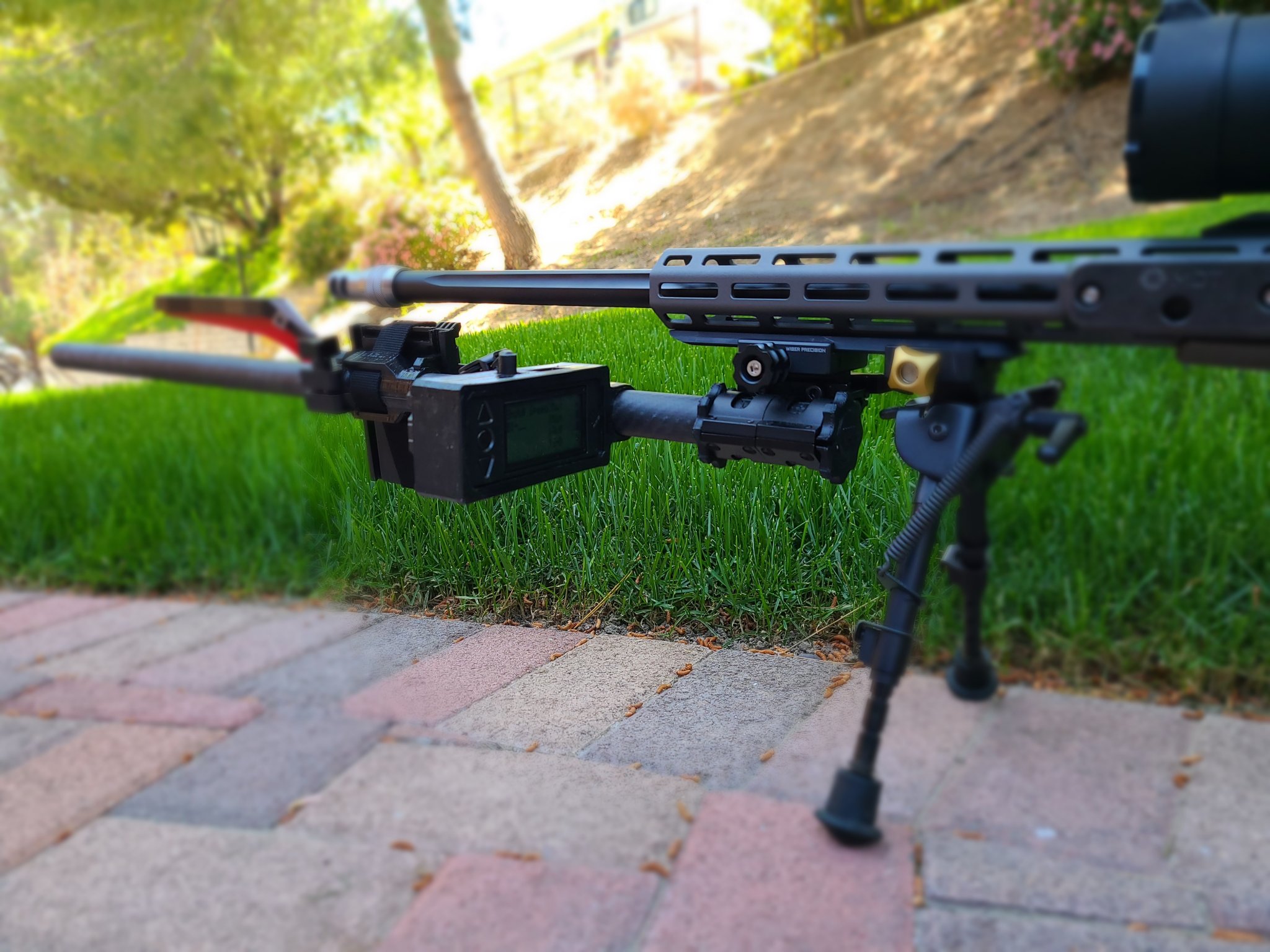

Has anyone tested if off-barrel mounts stop POI and group size changes?
I've noticed in my use of V3 MS, I don't have a POI change, but there is a defined change in group size. I was wondering if both of these effects are negated with the mounts.
And because someone will say it, I just returned a labradar after a month of use alongside my MS. I had both the piet trigger and the MK Machining sight, as well as mounting the labradar on my tripod. Discrepancies of +/- 100 FPS compared to a magnetospeed, lost shots, and a shitty app.

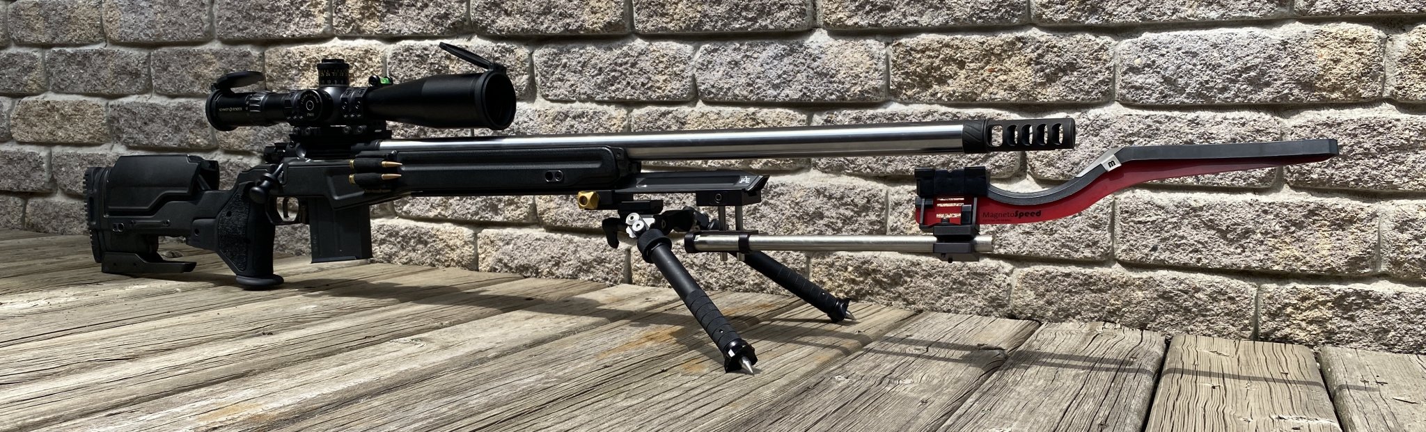

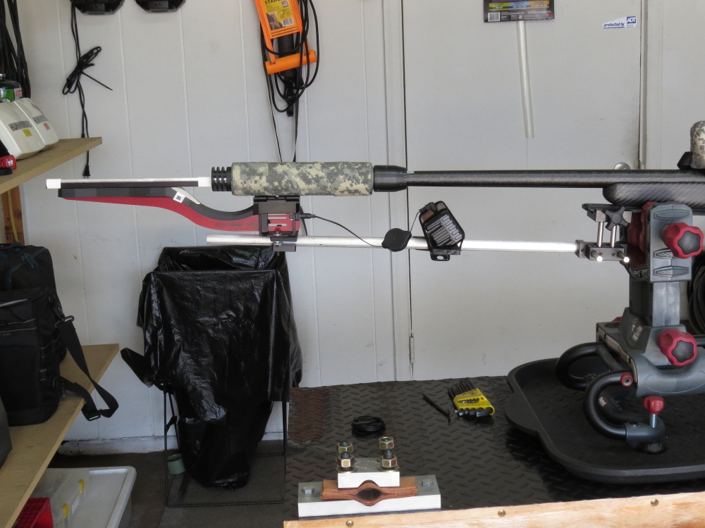

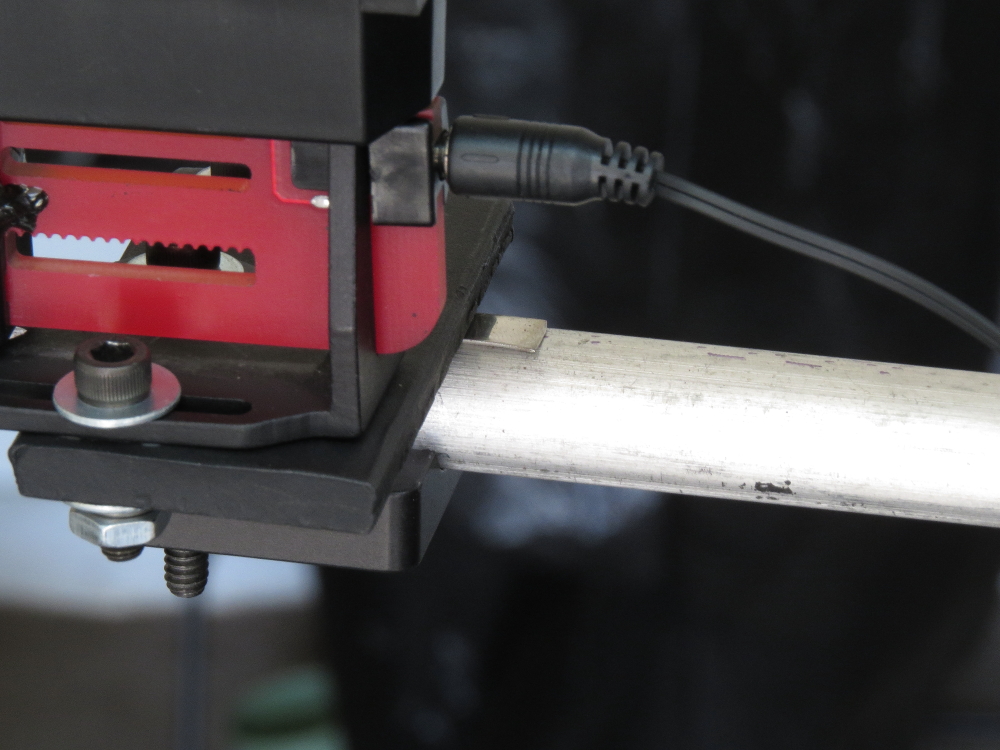

I built a mount for myself using a clamp on picatinny mount, camera “magic arm” and bar of aluminum to mount the MS to. Works quite well, and I feel it had negated the issues with having it strapped to the barrel. Only issue is you have to be careful not to bump the arm into things for fear of knocking the MS out of alignment. I did this clearing a misfeed on an AR, and skimmed a bullet across the top of the sensor.
Definitely group size changes. Haven’t used an adapter but Wiser show up in the PX occasionally. Mixed reviews on here if I remember correctly.
Big fan of Magnetospeed (except for that designer who was dropped on his/her head as a child **%#$%$%%^&^$ strap design!).
That said I don't use it for groups. Frankly, I'm surprised (pleasantly) that even with a different off-barrel mount that the bullet and gases being so close to the bayonet, does not effect it.
Reactions: PDXGS
I use the wiser mount and very happy with it. Just put it on my rail on my spigot. I Can run test loads, shoot groups or shoot steel out to o e mile and check speeds with no worries of changes.
Reactions: Boondoggle
Mine works.
Toss the strap, and just use electrical tape to secure it to your barrel. Get your S/D E/S and back in the case it goes....
Unless you just like fucking around, and lets face it "who doesn't at times!" Lol
Cheers
Pete
Reactions: Holliday
Reactions: MidNite WolfMan

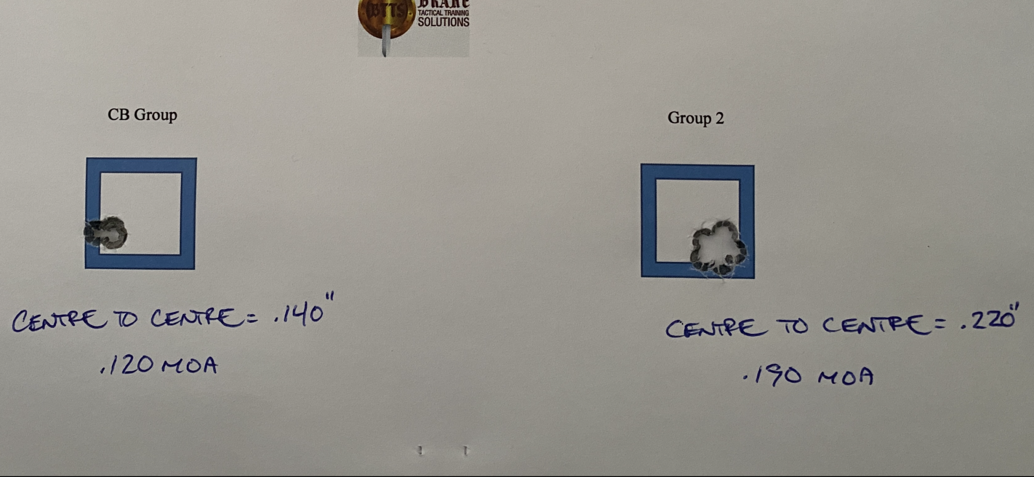

The GrayOps mount is the best I've used, I just leave it assembled.
Are these all groups with the mount? Or is there a group that is without? Not to be a dick, but I've had similar results when I first started loading with the Magnetospeed on, and the groups were definitely different once I took the MS off
edit: I see you also use chloroplast for a backing. Fucking best target backer ever.
All with the mount. I don’t know that I have pics of any without. I guess I could get some. They don’t change.
Reactions: frost1235
Word is that even with the mounts it can cause a shift to go opposite of the bayonet if it’s too close to the bullet. But you can also run it a bit further off of the bore line and still get good readings and eliminate the shift.
It certainly can.

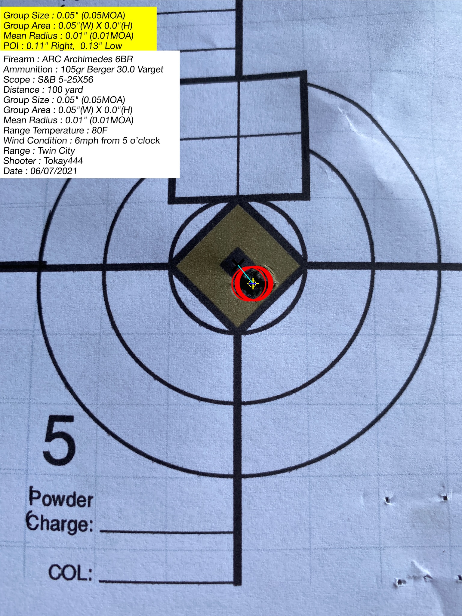

I run my sensitivity on max and run a large gap and you’ll not see any issues, a tight gap will offset your impact slightly.
Reactions: Tokay444
It certainly can.
I do the exact same and get very good results with very little (No Reads) using it them on my AR's. I only wish there was a MK type mount that would fit a more traditional stock. Most stocks are angled in the fore arm so the pic mounts will not work.
I use the wiser mount. So far so good with no POI change.
