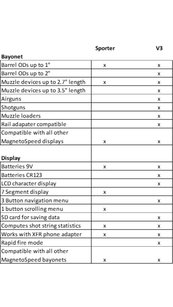

Can anyone tell me the actual difference between the V3 and the sporter? I have a standard chronology but was hoping to upgrade to something that might be more accurate and easy to use. I don't want to spend a ton of money for features that I won't use. Primarily using it on a rem varmint contour bbl. And an .875 diameter ar.
Reactions: SniperGod
If youre only ever going to use it for barrels under 1" theres not much to be gained by the v3. That said the v3 will allow you to remember multiple strings of data, the sporter only shows the current string, the record data for another rifle separately you have to delete the first.
That said the xfr adaptor makes it possible link a sporter to yuor phone and it looks much nicer than the sporters sparse screen.
I take the sd card out of the v3 and can put it into the computer and run graphs etc on the data in excel, the sporter you would have to enter that crap in manually. The v3 is just over all a more convenient product. but its 2x the price.
The V3 has stainless steel blast shield on the bayonet. The strap system is beefier. The V3 unit has more capability in it's menu and has a better built housing.

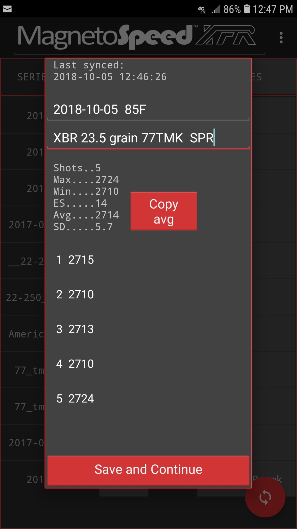

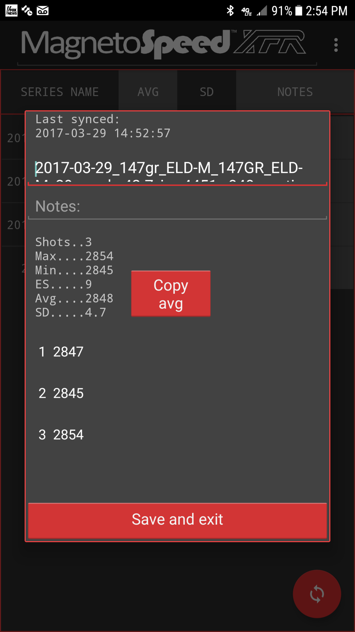

I have the sporter and its perfect for my needs = load workup and simple verification of muzzle velocity
I use the XFR cable and app = THIS MAKES IT MUCH NICER TO USE
I screen shot info out of the app and Save it in folders on my phone
Lastly, and a big deal to me ........after hearing rumors I can confirm that the sporter WILL WORK on a suppressor of you run no spacer on bayonet
