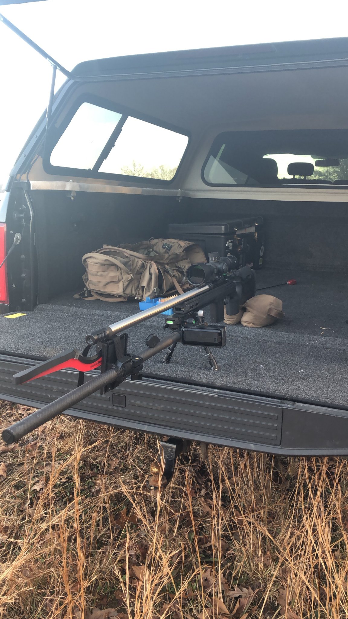

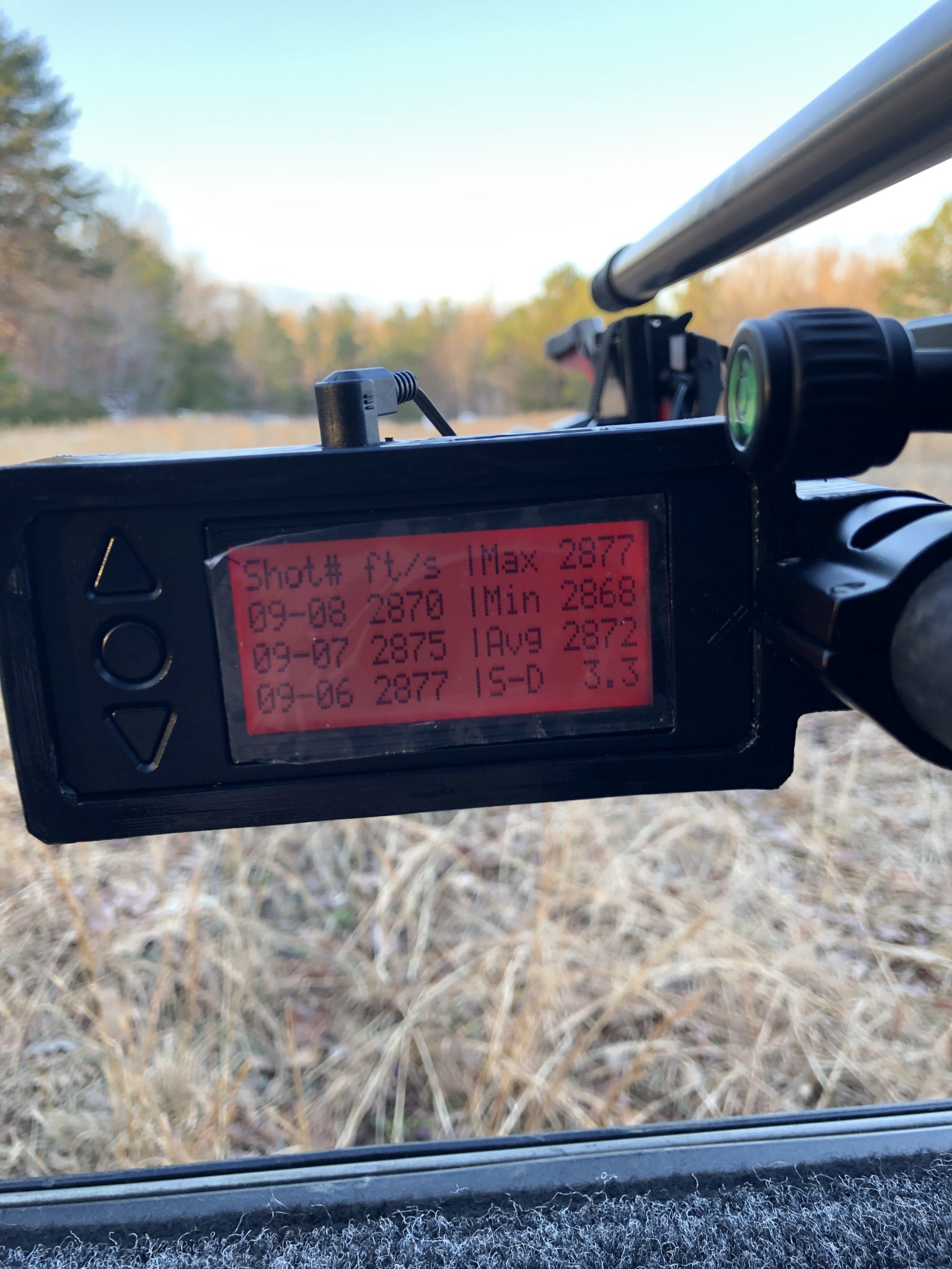

the mounts work great.
me and 2 other buddies all use the wiser mount. no issues.
