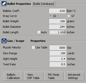

    So I just did a quick check & with TRASOL & my measured MV to get my observed DOPE for 1400yds the BC would need to increase to about .815 G1. This NC also works @ 900yds but is too high for my observed DOPE for 1700.

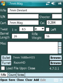

    I spent several hours last night playing with all my ballistics software & most required 2865 fps with DK & BC adjustments to get as close as possible to the observed DOPE for the 3 ranges I've tested.
    Reactions: Diver160651
    Some software like FFS only use a G1 & the others that accept a G7 I have used it. Frankly either will work & ones like FFS Trasol & 4DOF only use the BC to convert it to a Drag Curve.

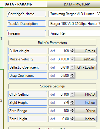

    Here is a real example that I have seen for years..The distances must be exact, your zero perfect or the offset accounted for.
    Let’s say at 400y your perfectly chrono’d round with a .618BC going 3100fps hit .5” high at 400yards. At 1750 is was low 5MOA...
    AB, CB,JBM and FFS all will have the same outcome..
    Please show me how adjusting the the BC, FIRST can balance this curve..
    I have shown example of this over and over.. but maybe it make more impact if those not believing it run thru the it themselves. Use JBM or whatever, see how much you need to whack your BC make this work.. Then look at what happens to your velocity..
