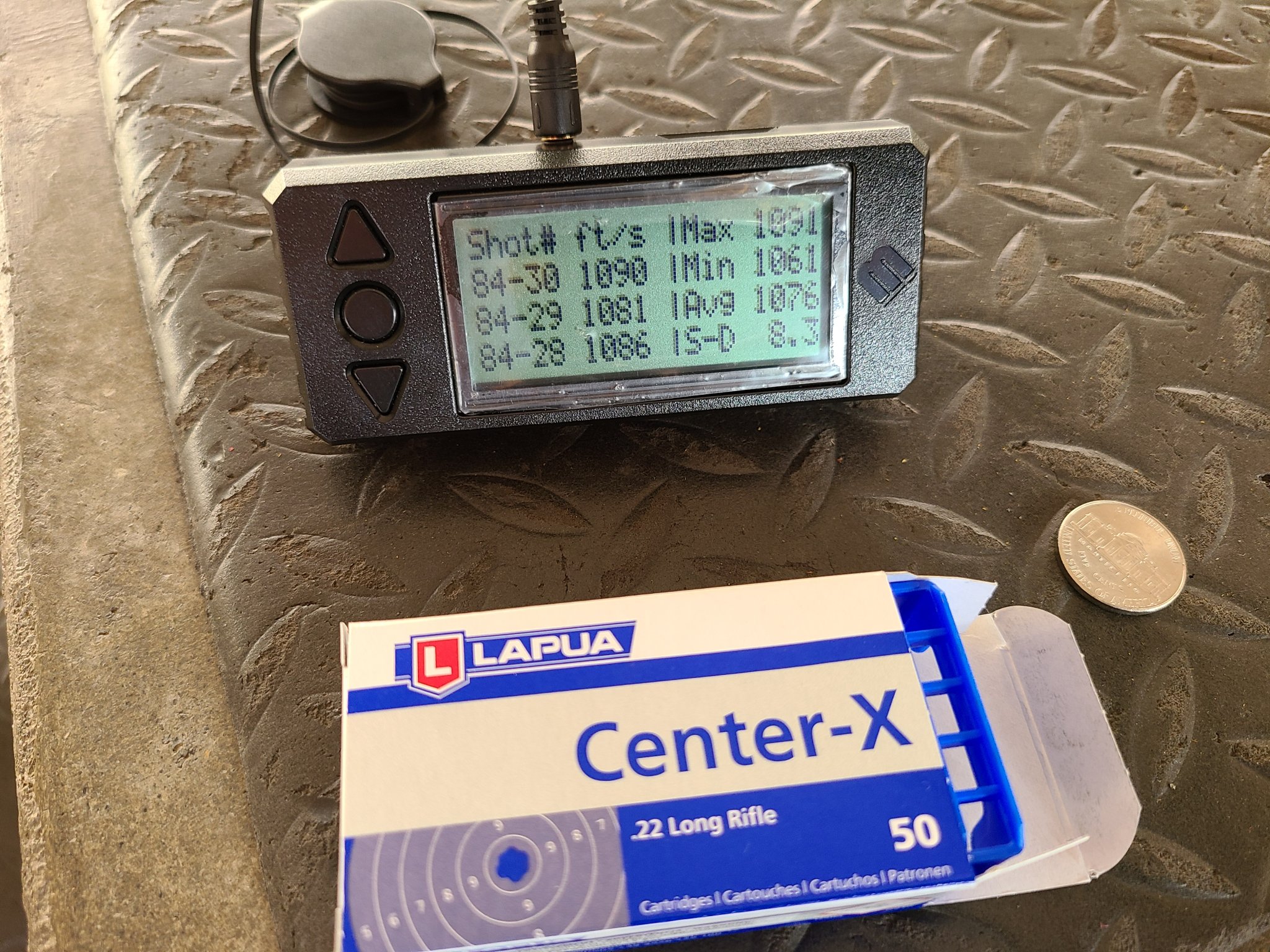

Has anyone figured out a work around for the MagnetoSpeed XFR app with the newer phones that do not have a 3.5mm audio jack but USB-C? I was at the range today doing some testing and pulled out the XFR dongle to download this string and realized it can not plug into my new Samsung S20+ phone. I know there are USB-C to headphone jack adapters but would like to
know if it will actually work before purchase one.

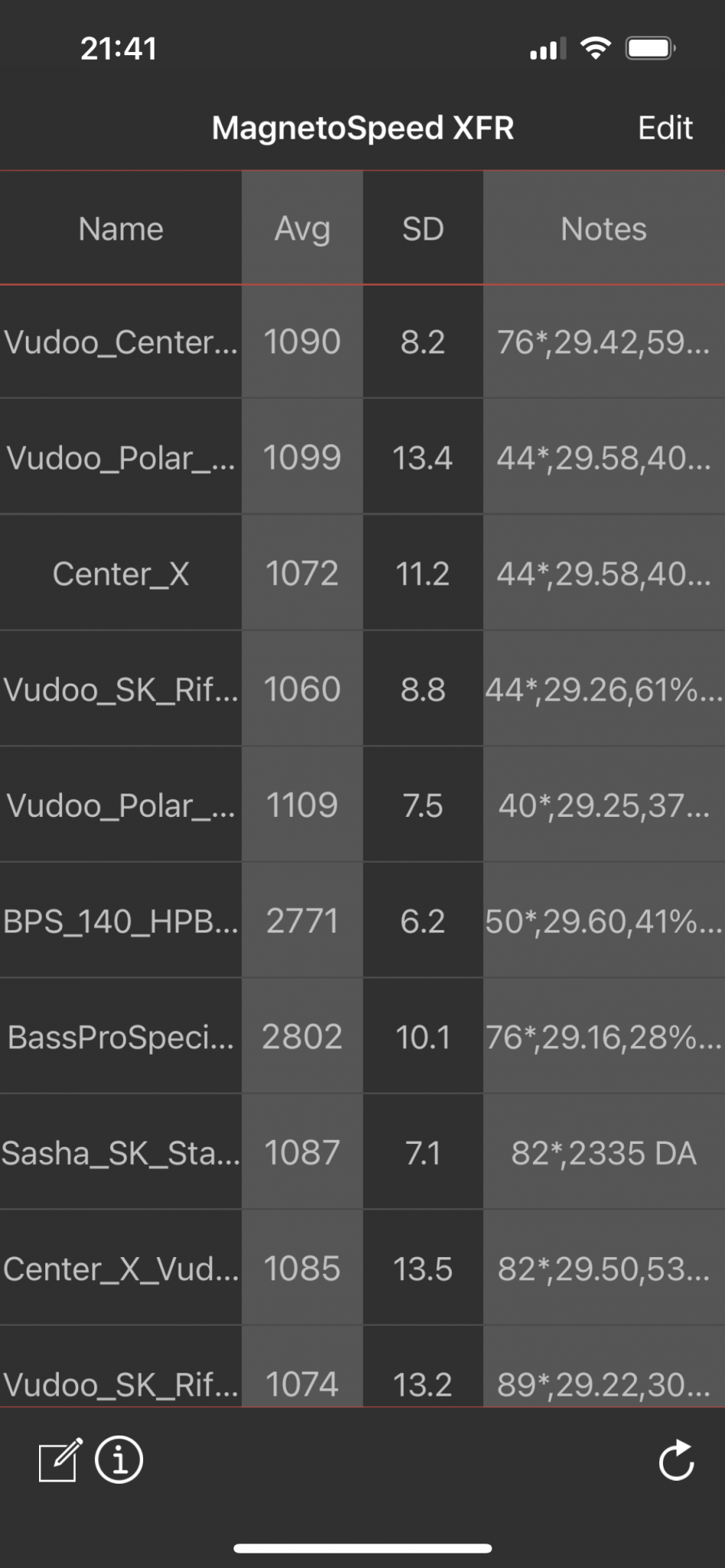

“You mean there's a MS app, and you can plug your chrono directly into your smart phone and if you have the app opened, it stores all your data in the app, instead of using the MagnetoSpeed head unit? Is this app available for iPhone?”
You have to use the XFR dongle, and the Apple adapter, but yea it works great for me. Been using it for years.
