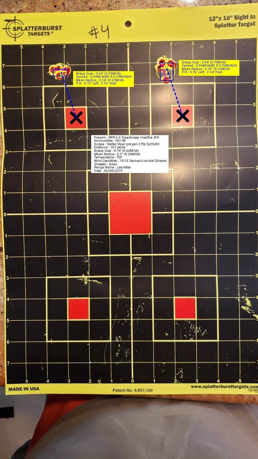

Today's chrono after 1k rounds no cleaning with the sporter attached.
7091966

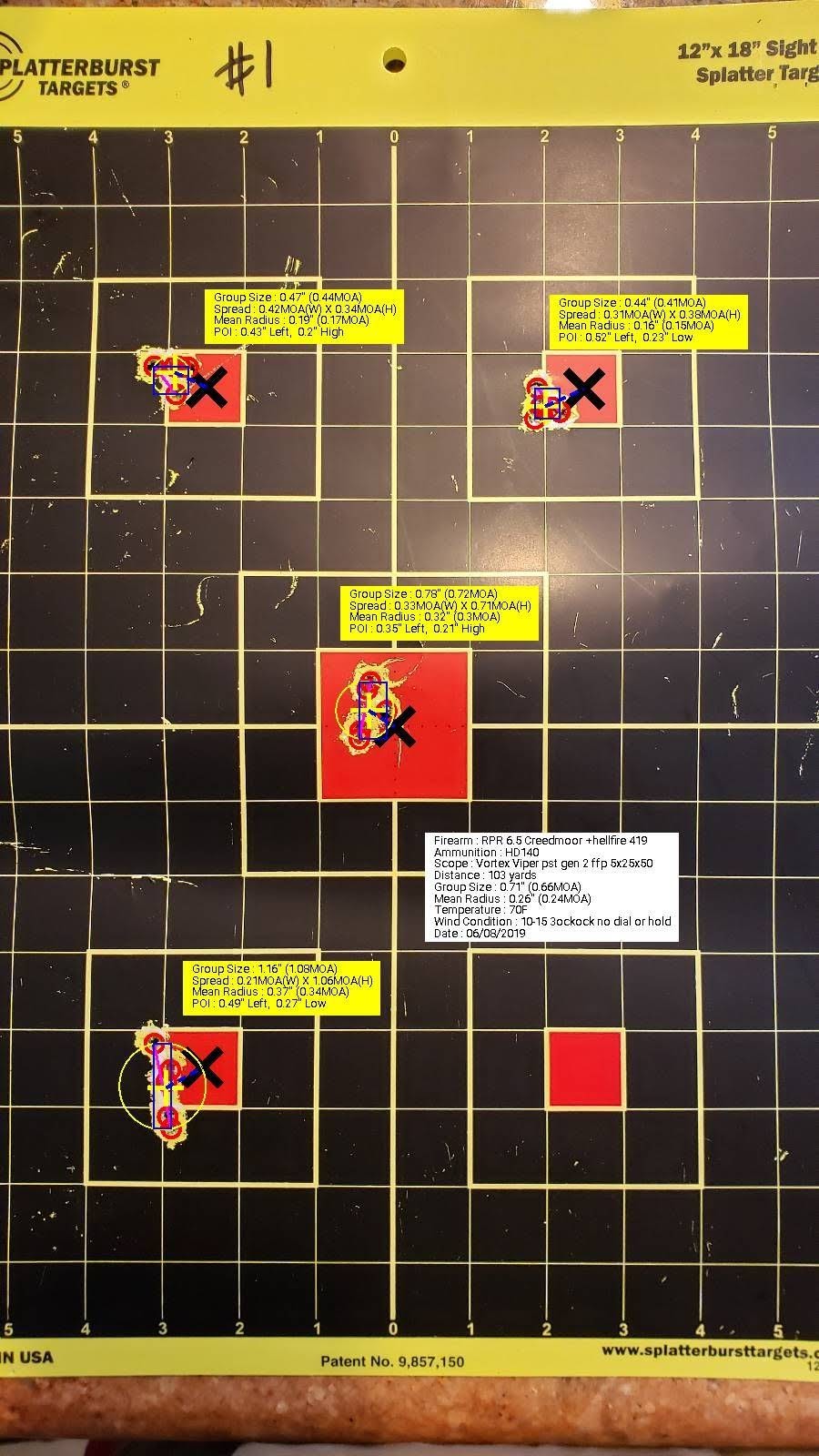

Same day no sporter attached.
7091969
Center cold shooter, cold gun, then top left, top right all with game changer as rear bag. Bottom left was a change in rear bag, not enough fill. My first club match next week, will clean, foul, and retest.
