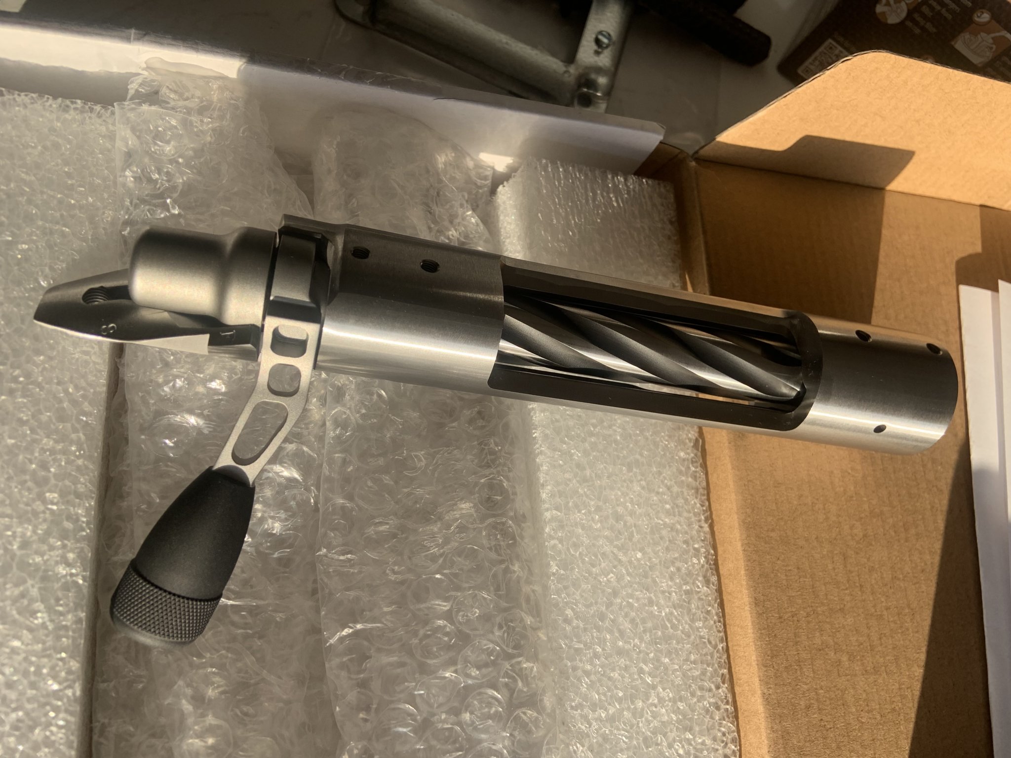

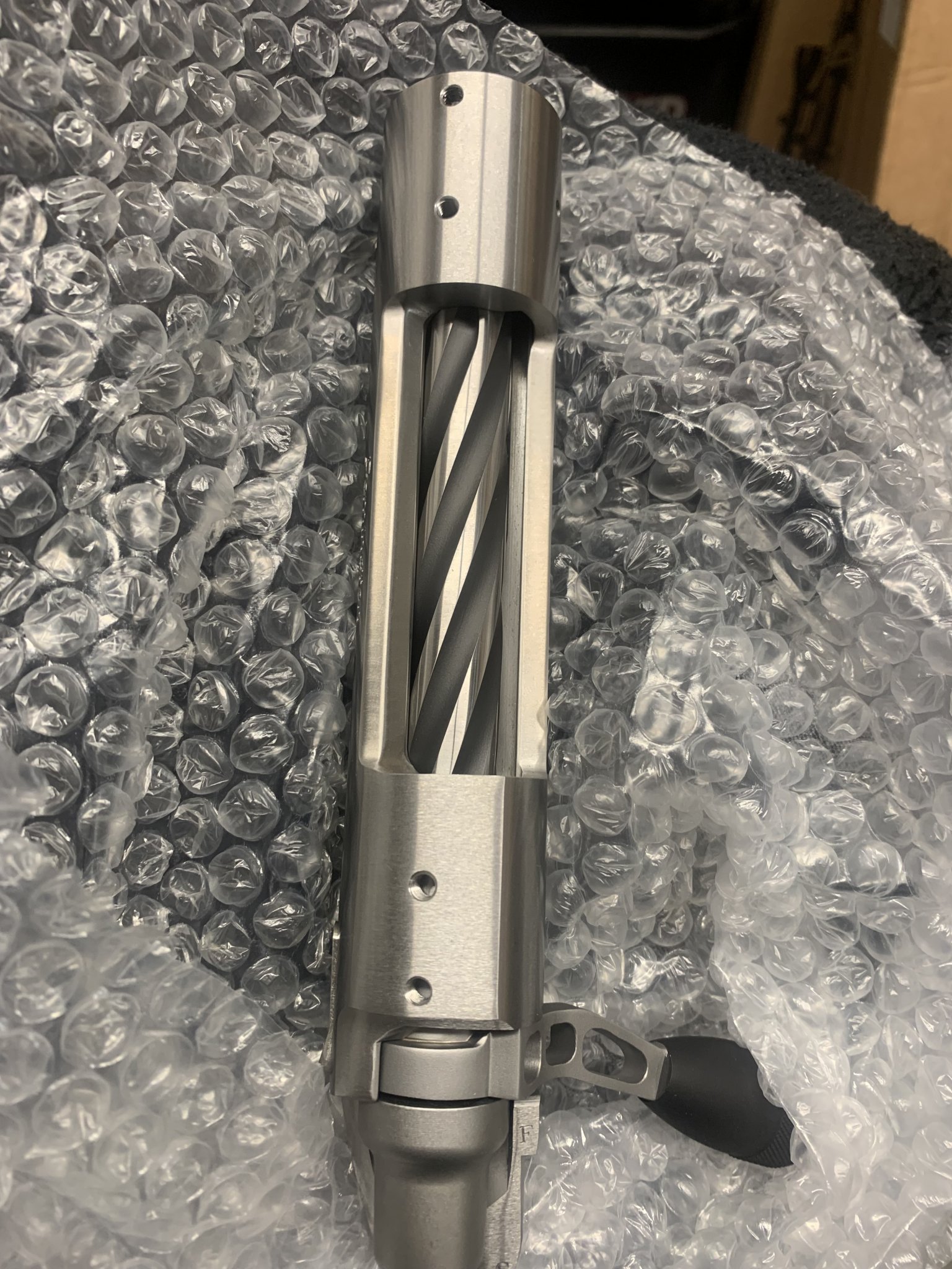

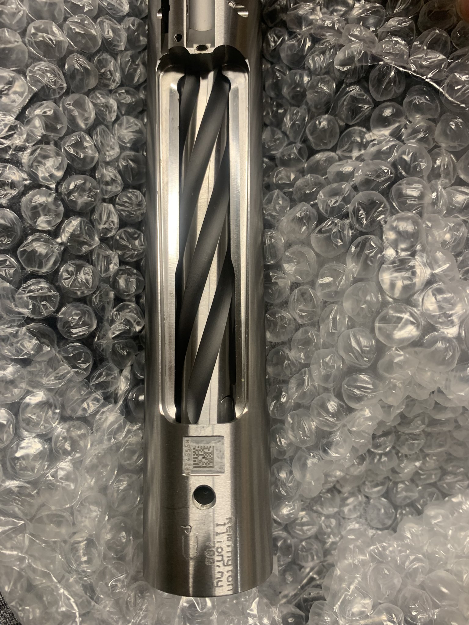

    I acquired a Rem 700 RUM action for cheap, I’m in the process of building a 300 PRC rig right now, my gunsmith told me the 300prc would work but needed to be run in a chassis or stock fitted with bottom metal with CIP length magazines
