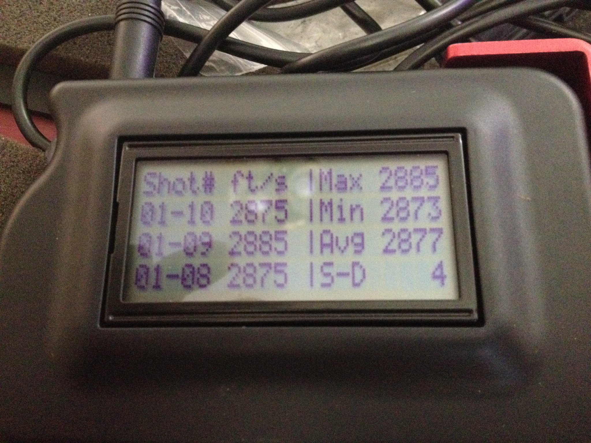

    Magnum primers in the 6mm Creedmore with H4350. I only use magnum LR primers. 22-250, 6 and 6.5 creed, 308, 300wm and 280. The only powders I have ever had trouble getting good SDs with are ball powders like WC844 and 4000MR.
    WC844 was in the 223 so tLR primers. I guess I did shoot s little of it with 110s in the 308, but I was going for prairie dog super flopper, not LR blaster.
