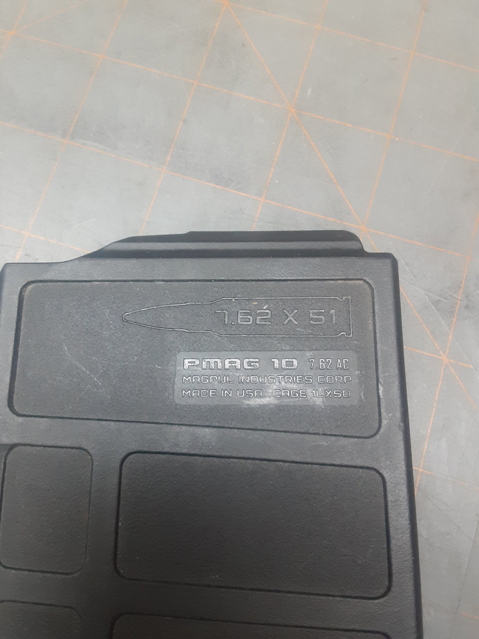

MagPul 10 Round PMAG Question.
Random One
Oct 12, 2020
25
8
I'm using this in a Bergara BMP in 6.5cm and having a tough time getting the 10th round loaded in the magazine. I mean a skin-your-knuckles tough time. Once I do get the 10th in and into the receiver, getting the bolt to move that first round is another battle!
The magazine is a 7.62X51, so that is the correct one.
I've tried leaving the mag loaded with 10 rounds between range times thinking the spring would relax - no joy.
The spring doesn't look like I could cut one coil out and reinstall. It measures .056" diameter.
Would like to get input/solutions/ideas on a fix before I pitch this one and get another - maybe an MDT 12 round mag.
What's your advice? ? ?
Are you using the ACIS PMAG and not the regular 7.62x51 PMAG? The Magpul ACIS mag is not the same and I can load 10 rounds without a problem, although in 7.62x51.
I can load 10 into my AICS Pmags, but they suck. Insert the mag into your gun with a bit of oomph, and it will barf the first round into the action. AICS mags suck in general. The follower is a joke. And, every mag malfunction I have ever seen in competition- and there have been at least one per match- has been due to an AICS mag.
Reactions: camocorvette
I have the bergara bmp it takes the magpul aics 10 rd mags loads and feeds perfectly 10 in every one
I couldn't tell you the difference - here's a pic of the only embossed description on the mag.
Take your magazine apart and see if there is a limiter on the bottom of the follower. It will look like a plastic tab on the bottom of the follower.
If the limiter is there, cut it off and the tenth round will load a bunch easier.
If the limiter tab is not there, I'm sorry but I don't know what else can be done.
THANK YOU! 🥳😁
The follower did have that tab and I was able to get in there with my band saw and cut it off. It still loads with some effort - but it's tolerable, and the first round feed worked very well.
THANK YOU! :D🥳
