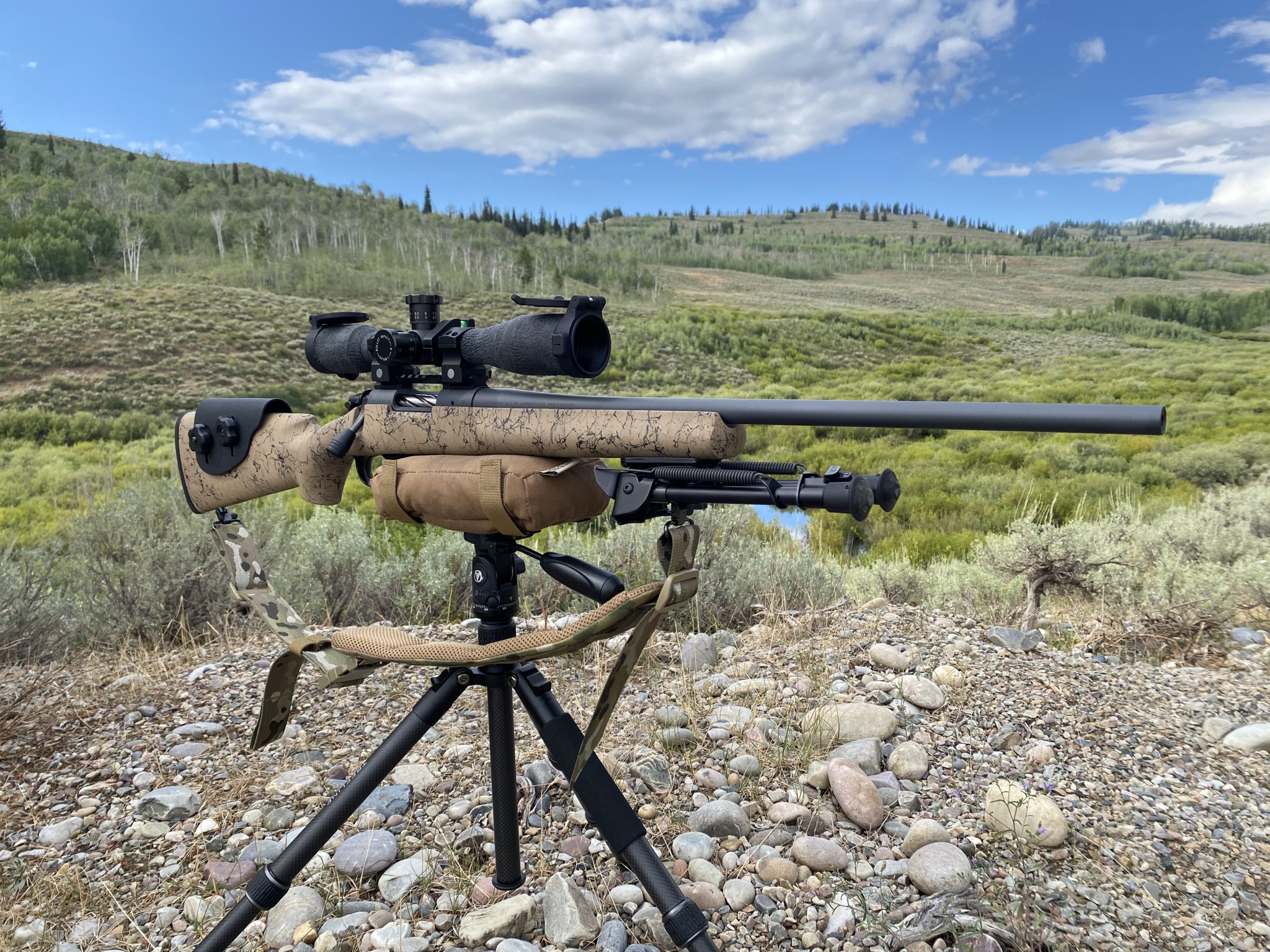

Any users of this chassis on here? Looking for some feedback/likes/dislikes/comments on quality. I have one on the way for my Bergara B14 Wilderness. I was able to score a new one for $430. The rifle is currently sitting in a HS stock with a Mathew’s fab adjustable cheek riser. I’m looking for improved ergonomics due to tendinitis in my elbow being exasperated by the angled/traditional grip on the HS stock. The Magpul chassis weighs 2lbs more than the HS stock, I’m really hoping to still pack this rifle in the field without it feeling too cumbersome. I use this rifle for western big game hunting and I’m hoping to dip my toes in the competition world in hopes of continuing to improve my practical marksmanship skills.
Picture is the rifle as it’s currently set-up
