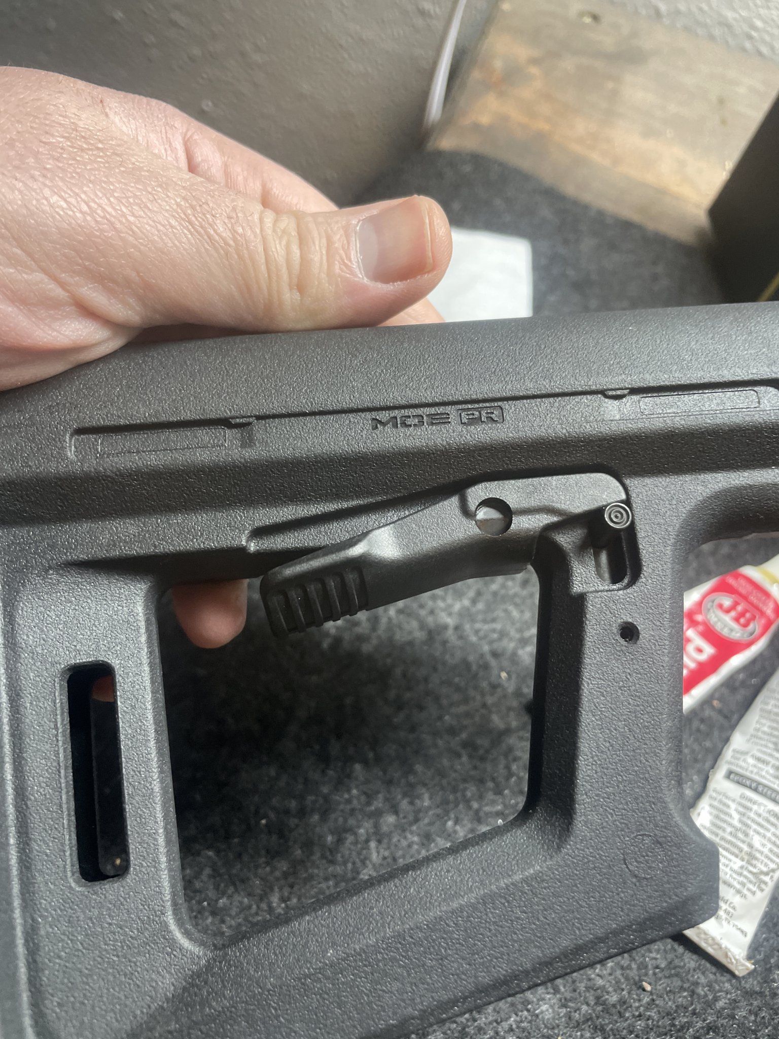

    I just got one. Threw it on a gun. It rattles. I’ll stick with the type that have the lock, especially for rigs I hunt with. Anyone want to buy mine?
    Damn, I was afraid of that. Being that it costs about the same as a rattly MOE stock I didn't figure it would have any type of tensioning device installed.
    Doesn’t seem to. I didn’t read through everything just threw it on, so if someone knows something I don’t, by all means correct me.
    I don't think it has any kind of tensioning to it. I saw a SHIT Show...SHOT show interview from the Magpul booth where it was implied there may be a version of the MOE PR coming out that would have the dual tension system, or something like it, so this really seems like a MOE carbine stock with a butt hook.
    Yup, certainly seems that way. Just one lever, pull down a little extra to get it on. The bottom is even hollow. Get what ya pay for I suppose. I like the shape and light weight, just need to lock up the rattle
    Reactions: msgriff
    I was hoping it'd at least have a leaf spring inside of it that put tension on the buffer tube to take some rattle out like the SL-series stocks have.

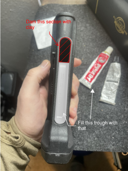

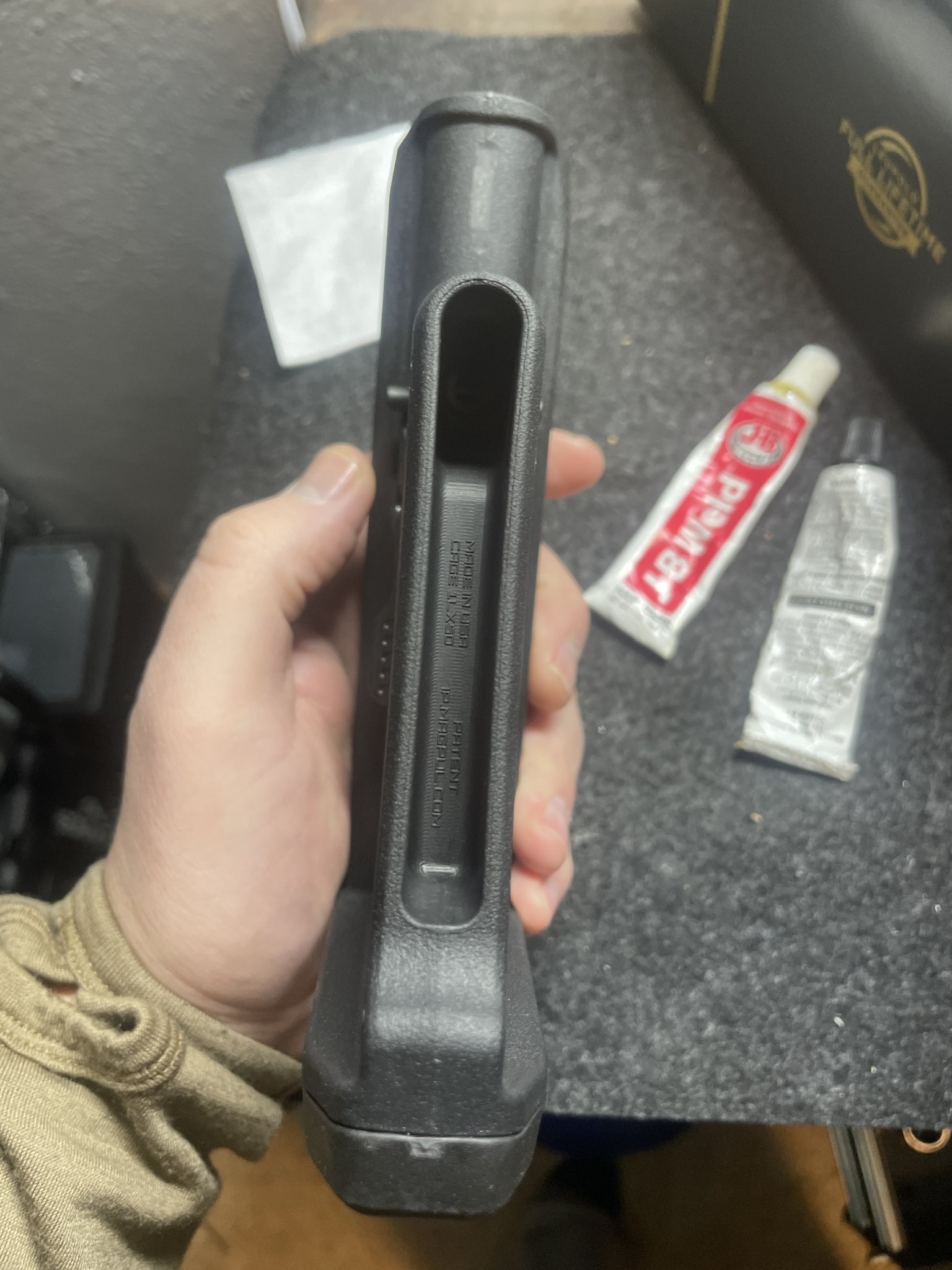

    I’m curious: Why does the open bottom bother you?
    Admittedly I haven't shot with the stock, I've shot plenty of stocks from bags. IMO if the purpose of the shape of the stock is to ride bags, I think the hollowness will not be good for bag riding.
    One could....
    and it'd create what Magpul should've done in the first place but honestly as much as I like to mod stuff I'd prefer to not fix their mistakes and just use something else.
    That's almost exactly what I initially thought about. The only exception would be that I would use a large straw or tube, i.e. a section of a giant pixie stick, to give enough room to drop the lock pin out if necessary, but fill the void as much as possible. If I find the hole to be a problem, I'll try 3D printing a cap first, then the epoxy/JB Weld if necessary.
