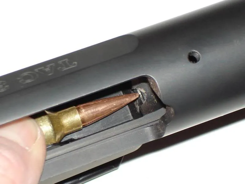

You are right. The tip of the bullet is stuck under the feed ramp

Hopefully Chad, Dave, or another guru will see this thread, and comment about notching the feed ramp.
I had this issue with my brand new Magpul Pro 700, maybe 1 in 5 or 10 mag insertions with a 10 round Magpul mag. It appeared a filing of the bottom half of the feed ramp or notching of the feed ramp would help. However, before you pick up the dremel sit down and do a couple hundred insertions of a full mag on a closed bolt. I did this and no longer have any issues, as if the system needed breaking in. Just did about 50 mag insertions on a closed bolt and had no feeding issues.
Reactions: socal-338 and jp67

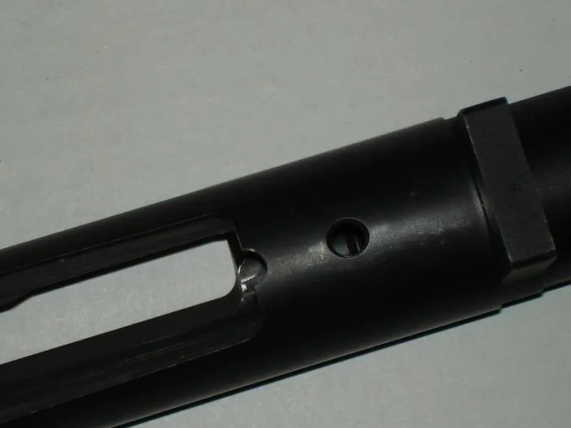

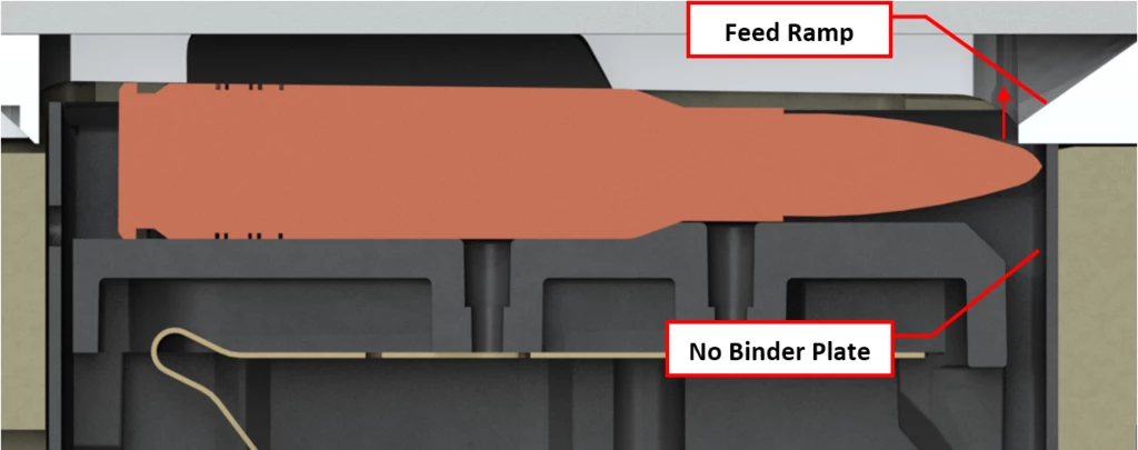

Notch ramp, super easy. Rds feeding into chamber only use upper 1/2-1/3 of feed ramp. The notch you make will only effect lower 1/4 of feed ramp. Take a sharpie and mark underside of action at front of mag well. Take action out of stock, shove shop towel in chamber/lug recess area. Put barreled action in vise and use a dremel with a 1/8-3/16 carbide burr to make notch. Smooth corners of cut with emery cloth and polish with felt wheel on dremel. I had to do this with a 243ai, it's easy and let's you use plateless mage to chase freebore.

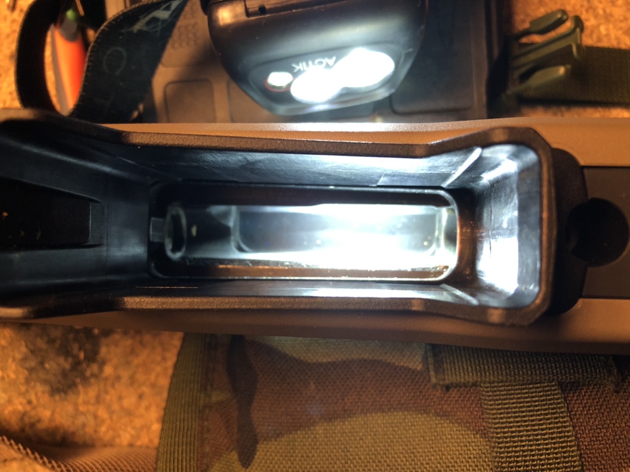

First off make sure that the action is all the way back and the recoil lug is firmly against back wall of the recoil lug pocket. Some chassis use oval action screw holes so that if the action was trued etc and material was taken off the front of the action that the bolts can slide forward that bit while keeping the recoil lug against the wall. If you have it arbitrarily far forward then this could be a symptom of that issue only.

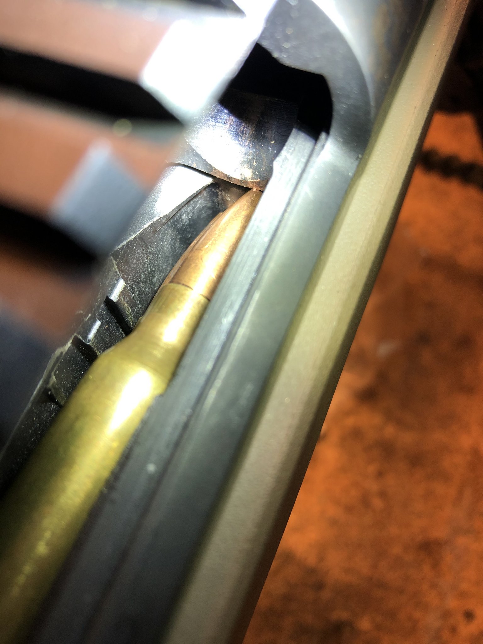

Some pics for demonstration
The issue
Pics of the fix
