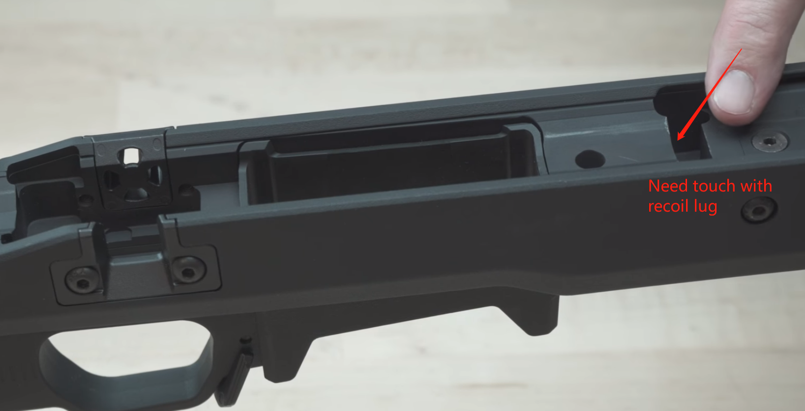

I got a Magpul Pro 700 chassis for my bighorn TL3
Everything is good at the start.
But when I shoot around 100 round, I figure out the Action Screw is loosening.
I make sure I tight to 60 in lbs. And continue to shoot another 100 round.
Yes... It is loosening again.
(I use the torque wrench set as 40in lbs can remove the screw, so I am sure the screw is loosened)
I bought two new screws and fit in.
It is loosening again after 100+ shot.
So I use some blue thread lock. (Red is too much power)
This time is better but not takes long.
I cannot find a lock washer to fit in, btw.
So, is there any good solution? Please do not use red thread lock, if I want to remove it someday.

I tried lots of time, remove it and put it on again. and try to find the problem. But it still loosen

I already cut a perfect screw for TL3
My action screw is perfect cut to fit. And the hole is too small to put a lock washer in.
I double checked, everything is okay but the screw is loosening. With blue thread lock, it will better than without.
I check Magpul video again and again.
I figure out, before tight the action screw, we should push the chassis recoil lug to touch the back of chassis hole. (It is hard to describe, so check the picture below)
I am not sure this is the problem or not.
So I removed the barrel action, cleaned the thread lock, and half tight the action screw. And I figure out there are around 1mm to 1.5mm space in the red arrow area. So I push the chassis all the way touch with recoil lug and mount as 70in lbs.
I reinstall the barrel action like the way.
Hope it goes well, I will go to the range recently to check the result.

My recoil lug does not touch the action in 2 of the magpulls.
Both are 300blk so not any recoil with subs.
Have been lazy and not bedded behind the lug.
It is trying to center itself in the action, dont shove it back to touch.
I dont think all recoil lugs are the same and you will have to bed behind it.
Get some clay down in there and assemble it, when you pull it out you can see whats up.
I think the magpull vidio is wierd on that?
That void behind the lug needs filled.

I am using bighorn TL3 action, so the recoil lug and action is one piece.
Generally, I just drop and tight.
But the video told me a different way, I think I should try. Because I tried lots of ways to improve it. I owned this chassis for 3 months now.
I do not want to change another chassis for now, but if I cannot solve this problem. I think I will jump to Foundation or MPA ( I already have a Manner stock and wait for barrel action done)

All the stocks will have a void there to be filled I think you will find.
I have gotten away with it due to no recoil to speek of in the round used.
I put mine togeather to test it and have not bothered since.
I may change actions and will bed then.

I think so, bed the action in the stock is the best way to do.
But people use DBM, because it is convenient. Just drop in and ready to go.

You can measure your action from the backside of the lug to the center of your front action screw hole and then do the same on your chassis from the lug pocket to center line of front action screw hole with a set of calipers. That will give you a good idea of the amount of gap present between the lug mating surfaces.]

When I put the barrel action on the chassis and I put the rifle vertically. I tight half way of the action screw. The action can go front and rear maybe 1mm or bit more. Rear side will be stopped by recoil lug touch the chassis hole. So maybe try some recoil lug bedding???
