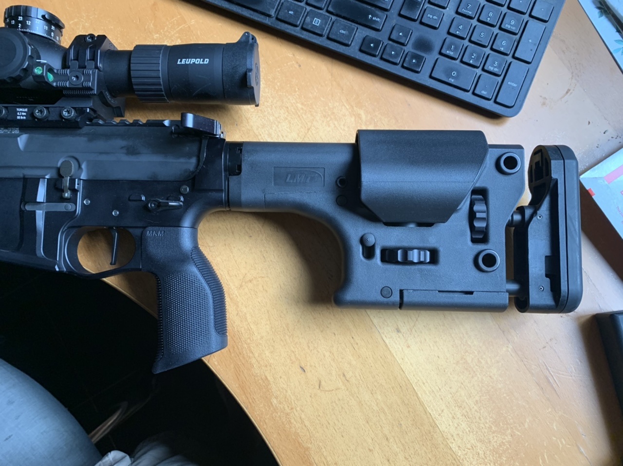

There's also the LMT DMR stock (556 and 308 versions), they are basically a PRS Gen 3, but allow for adjustment along a Mil-Spec Carbine tube, and have a wider cheek rest, and of course add about $100 on the price tag.

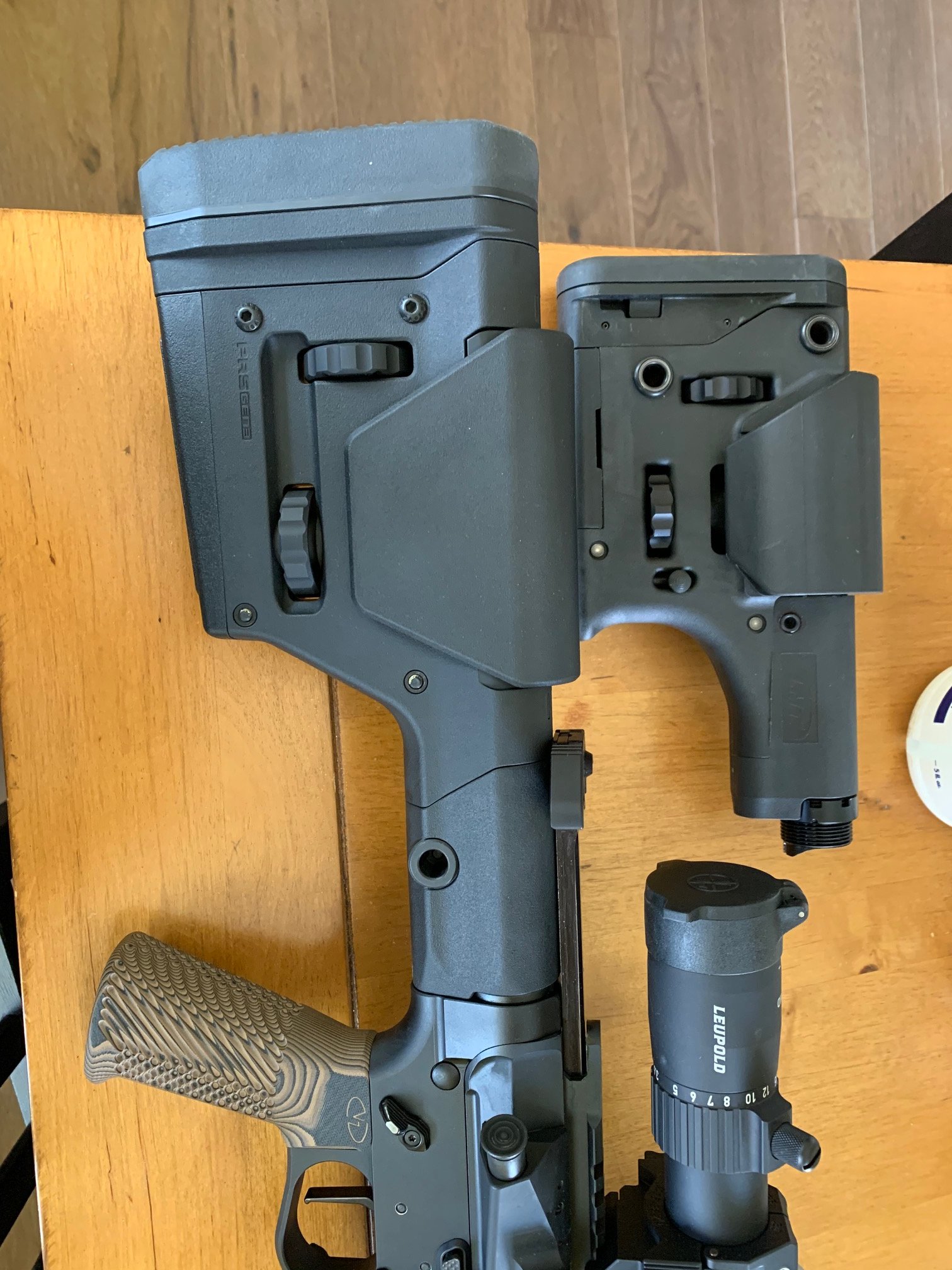

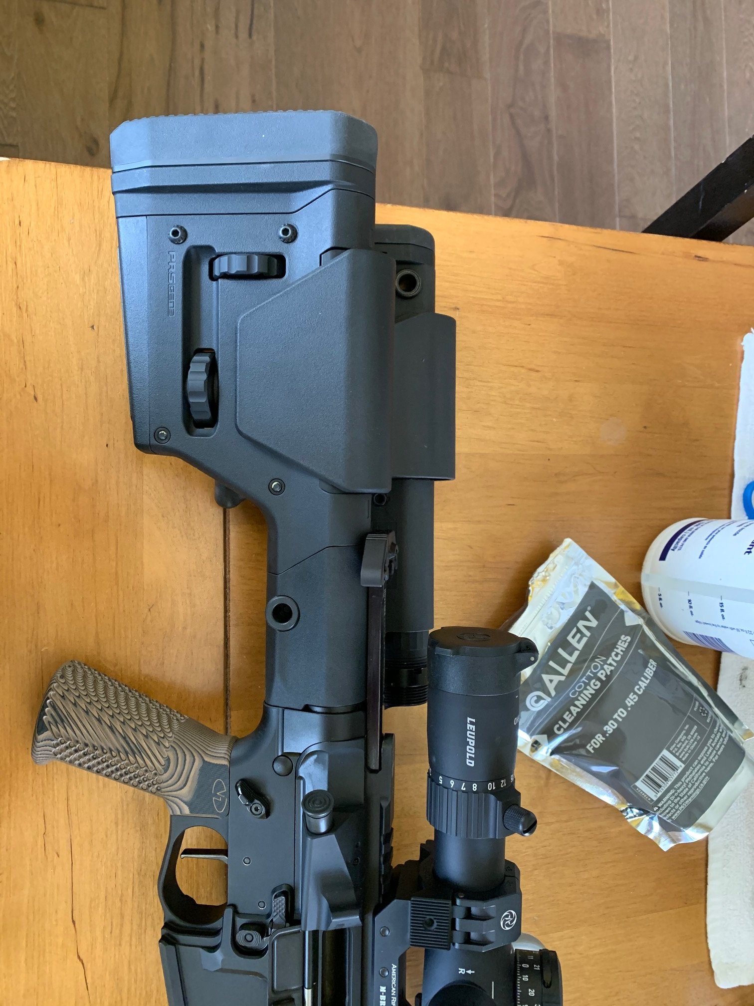

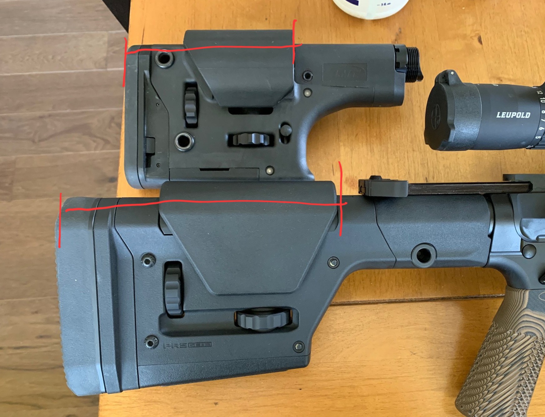

The PRS G3 is 14-1/2" lop on my small frame to a flat TT shoe.
The fix is to replace it with the LMT DMR stock. With that I've got 12" lop on small frame fully colapsed. At 1 click out on the buffer, the cheek riser clears the large frame charge handle & has 1-3/8" less lop than the PRS G3.
Did you notice the shorter distance to cheekriser? It is quite substantial. Did you have to max out the LOP setting on the LMT DMR? It still is way better than the PRS.
