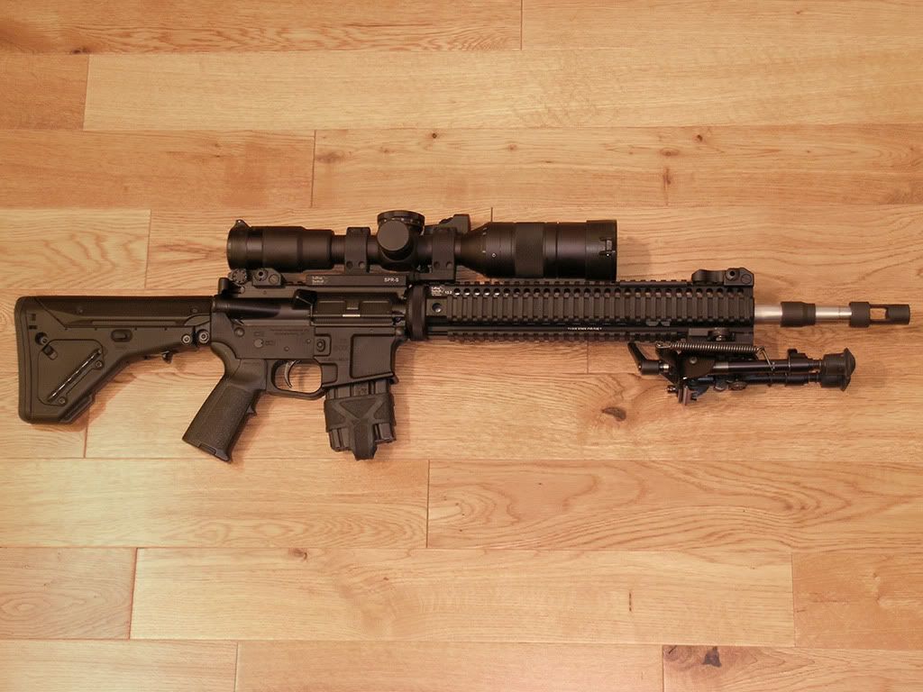

    Anyway, here's a pic of one of my setups using the UBR. It works very well. Balance is very good. Weight is a bit much, but it's really handy without the bipod or optic. Also, rear weight has been known to help with rifle control.

    Hey what size is your objective on that scope and which larue mount is that. Nice setup

    It's 44mm objective USO with Ergo parallax, but that tends to run a bit large compared to most scope objectives. Mount is a SPR-S Larue Tactical LT-158. It has 10MOA of forward cant and is a bit lower than their other mounts. If I remember correctly I was able to use both a 50mm objective Ziess Conquest and a 50mm Leupold Mark 4 in the same mount.
