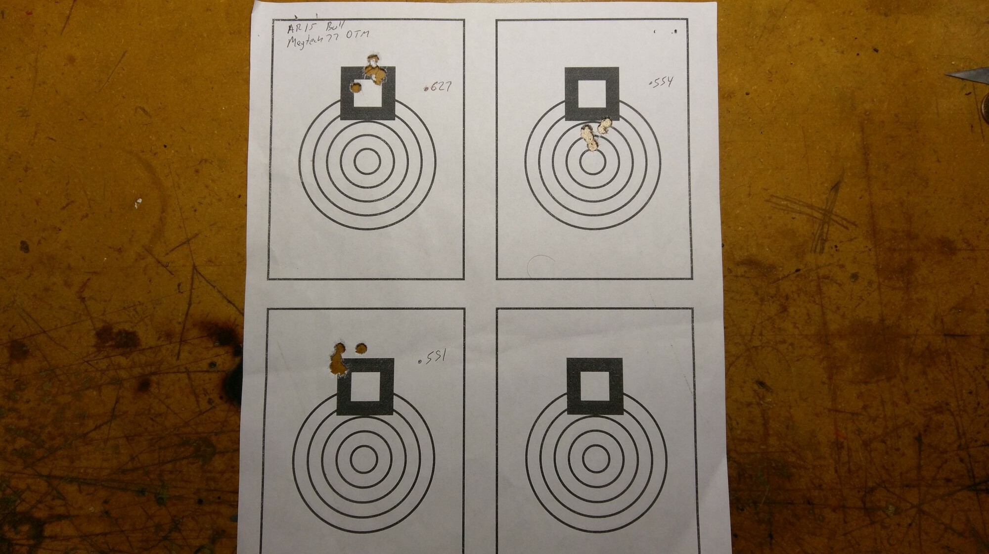

My rifle seems to like the magtech 77 otm
