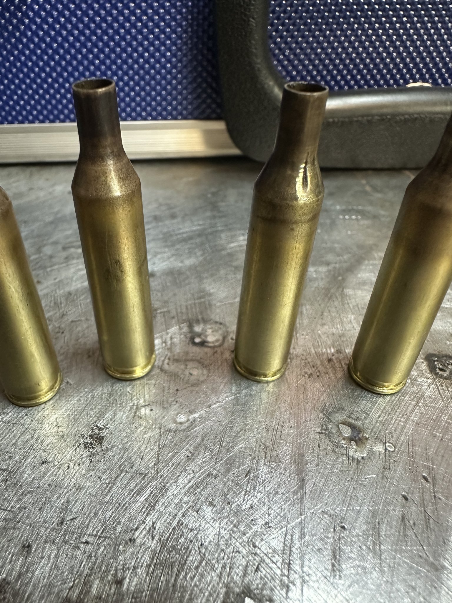

    New brass didn’t work well not sure if it was too soft down the body, but after the brass was fired, it seemed to work better and didn’t crush… and didn’t develop the dimples around the neck or creases, depending on how bad it was this made some of them unusable because it extended too far up into the neck..
    I had initially annealed the new cases prior to loading/firing… quite possibly the newer cases were too hard and crushed, and the other ones that were annealed, although fired, were still soft and allowed the brass to move inward without buckling.

    Here are some pictures of the cases that were new cases, and you can see the massive dimple creases … yes without any anealing… not good at all…
