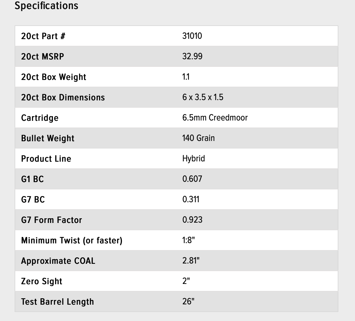

I think fixing the bore height after the update has me closer, and checking the Berger website just now, I see they have the G7 BC adjusted to .311 now and not the .317 it used to be.
This still doesn’t account for needing to go to .288 to get 7.1mil when you’re saying you used .312 to get 7.1mil in the past when the bore height didn’t get you back to where you needed.
