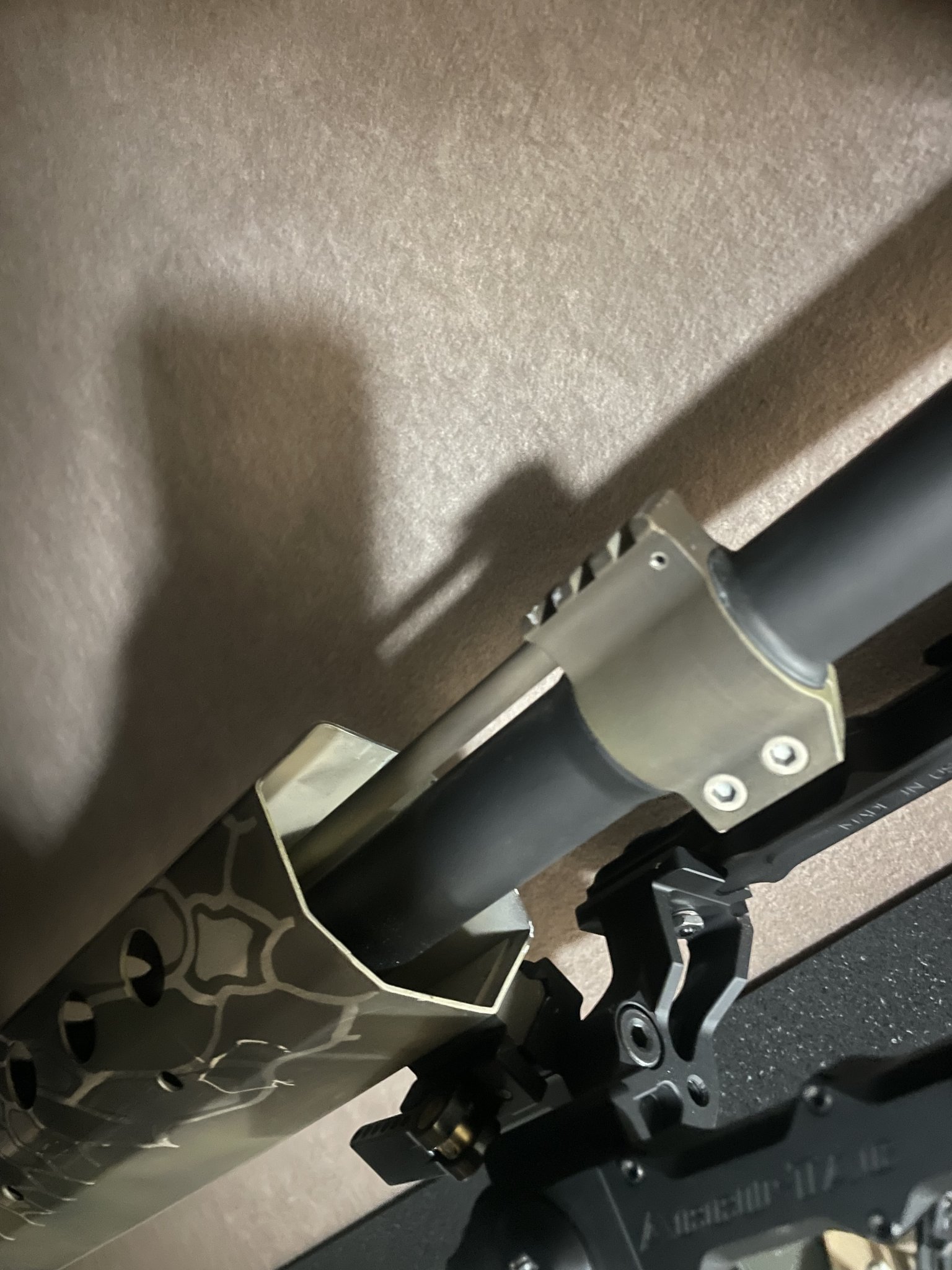

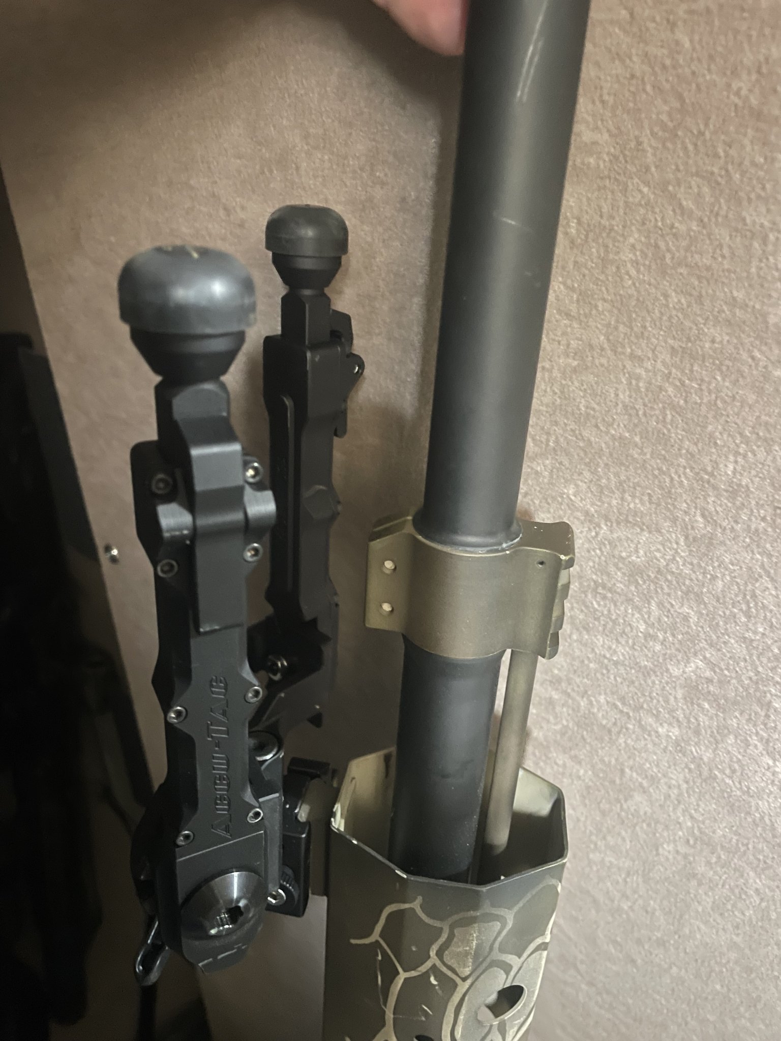

    Any smiths that can make this adjustable. ? Or make an adjustable one for it ?

    Is the gas tube diameter the same as that of an ar-15/ar-10? If so, what’s the gas block journal diameter? Adjustable gas blocks aren’t black magic. It’s just a valve that restricts gas to the system. It is entirely possible that there is an off the shelf solution.
