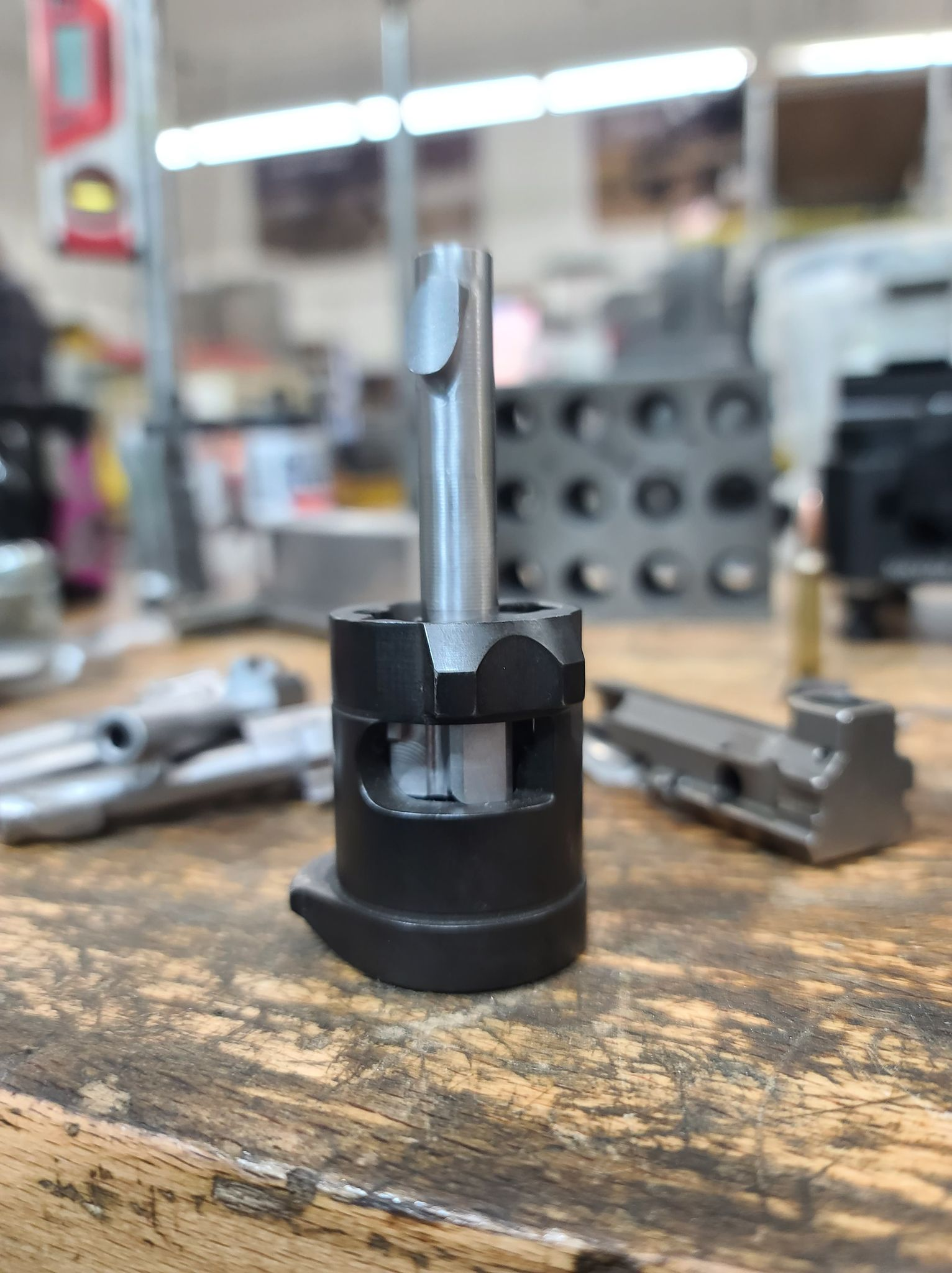

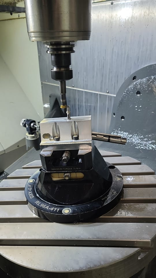

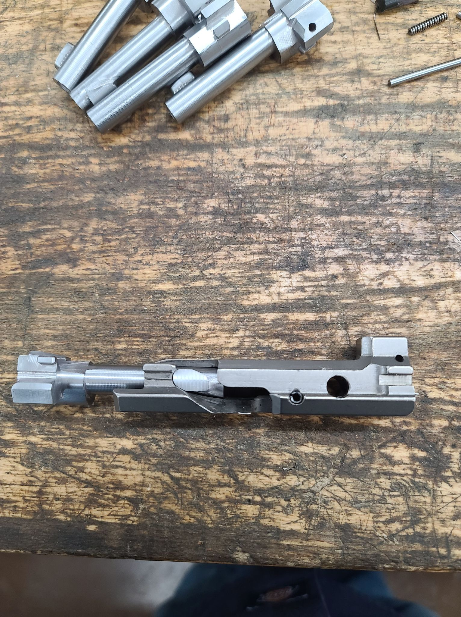

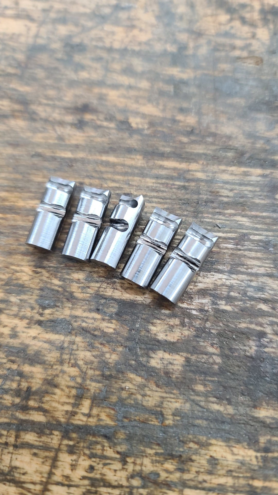

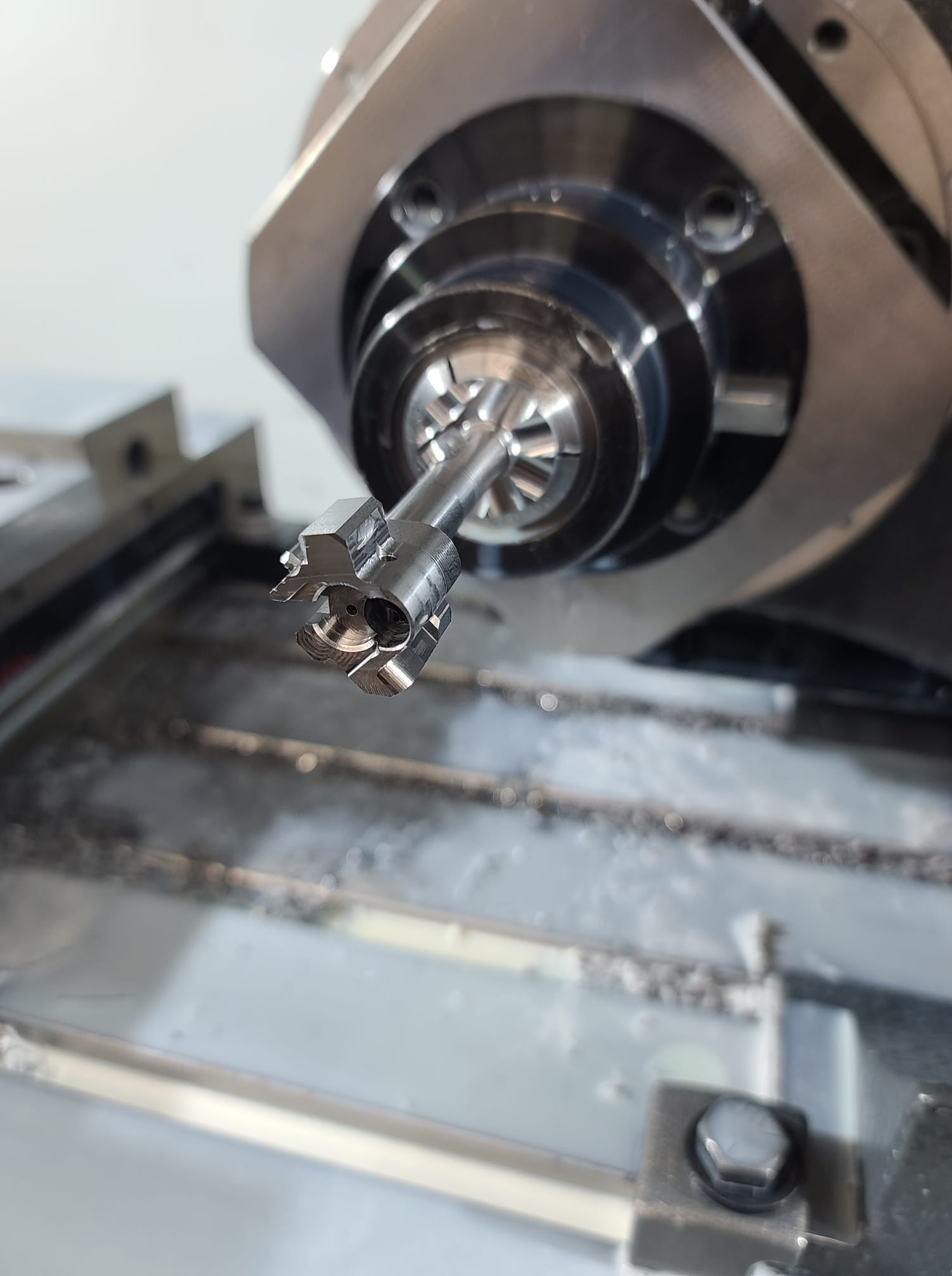

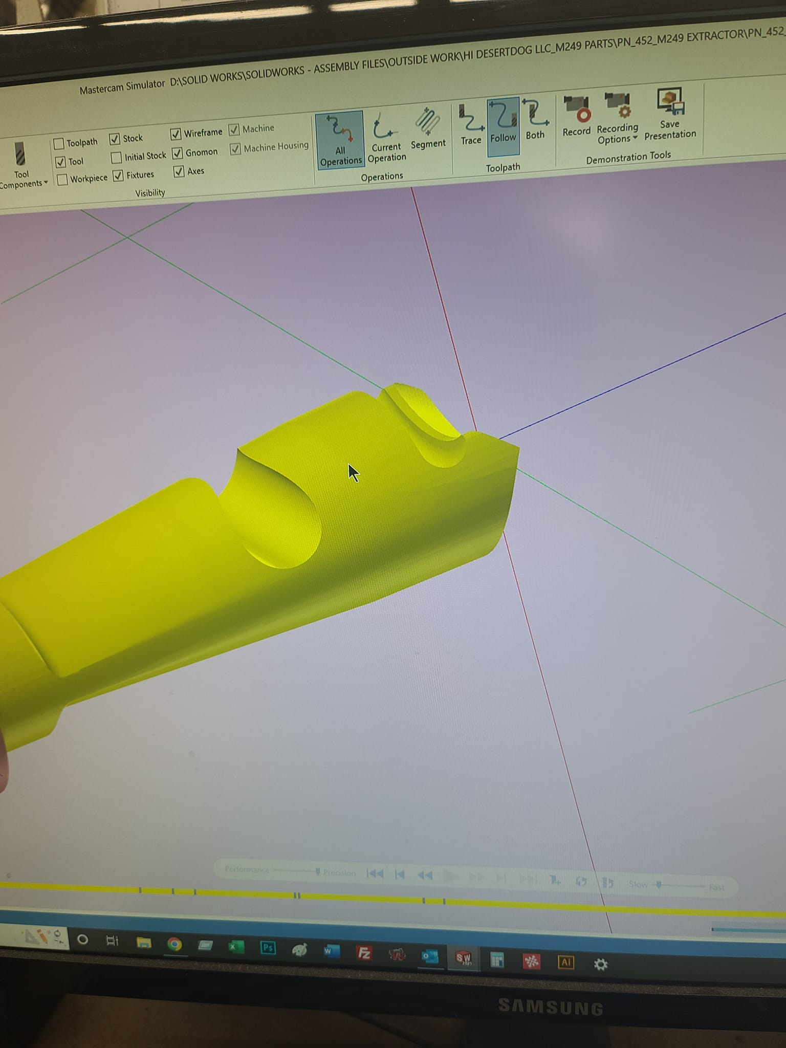

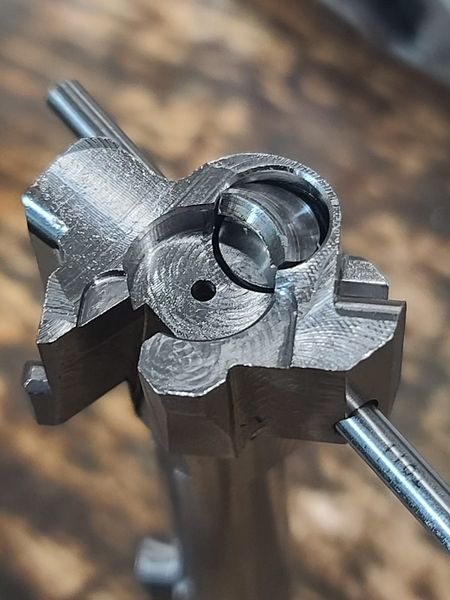

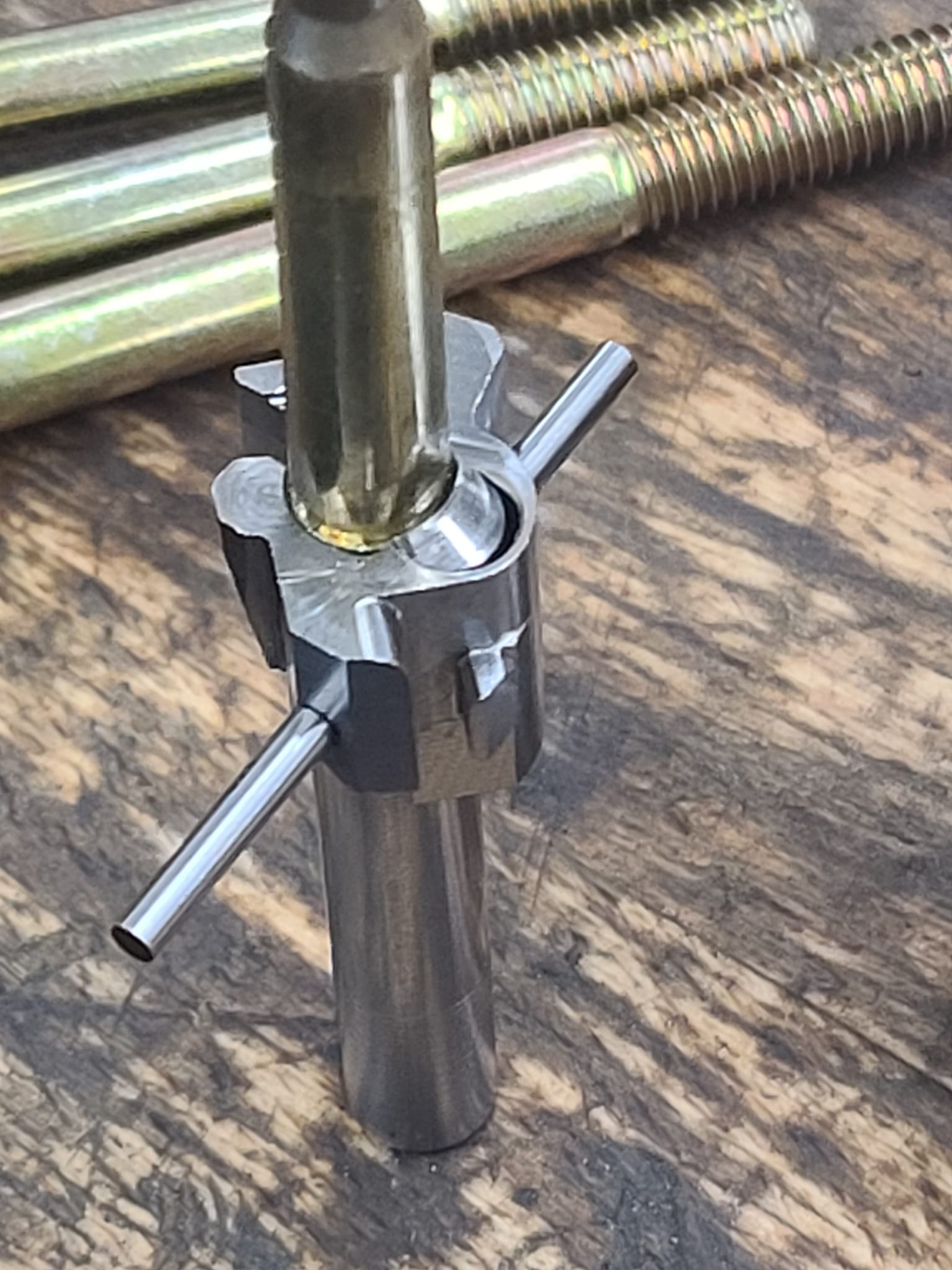

    Some recent projects...
    Sako 85 bolt handle threading in 5 axis. Once I figured this out, I wanted to throw my lathe into a lake, lol.
    Bolt manufacturing. 84 different machining operations in 2 setups. This was fun to sort out.
    Extractor manufacturing and fitup. To proof out the code I ran down to the hardware store and bought a handful of grade 8 bolts. They work great for sorting out jobs like this.
