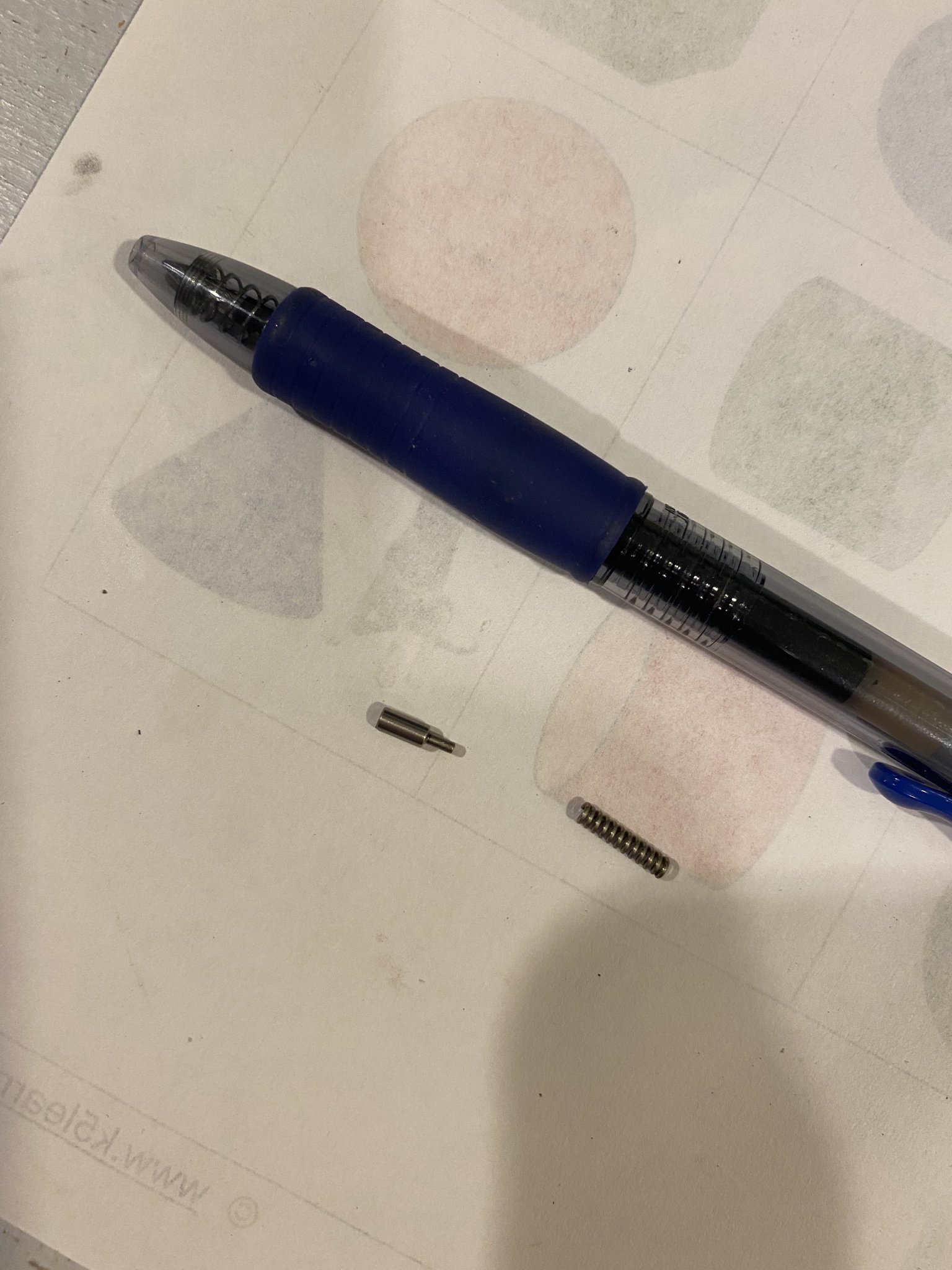

Curious if anyone has an idea what happened or what may be the cause.
Pulled the trigger on a tikka CTR. Felt a click, but no fire. Instead, a tiny spring and pin flew out the back of my action and hit me in the cheek.
Safety is now locked. Bolt will not close.

I'm not familiar with Tikka's, but why don't you give a little more info. What were you doing when the spring flew out? When you opened the bolt or what? Give more info and some guys here can probably tell you what you want to know
That's the Extractor plunger and spring.
Pieces of the extractor are hiding in the receiver/chamber, not allowing you to close the bolt.
Those parts can't fly out of the receiver with the bolt closed.
We all have made mistakes, so please tell us what really happened ?

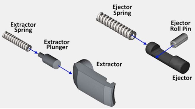

I am mentioning ejector because there are 2 of the 3 parts of the ejector system in the photo . I am asking where the retainer pin is . The third part, which is not pictured .

I would start with understanding how it works and what parts are now loose.

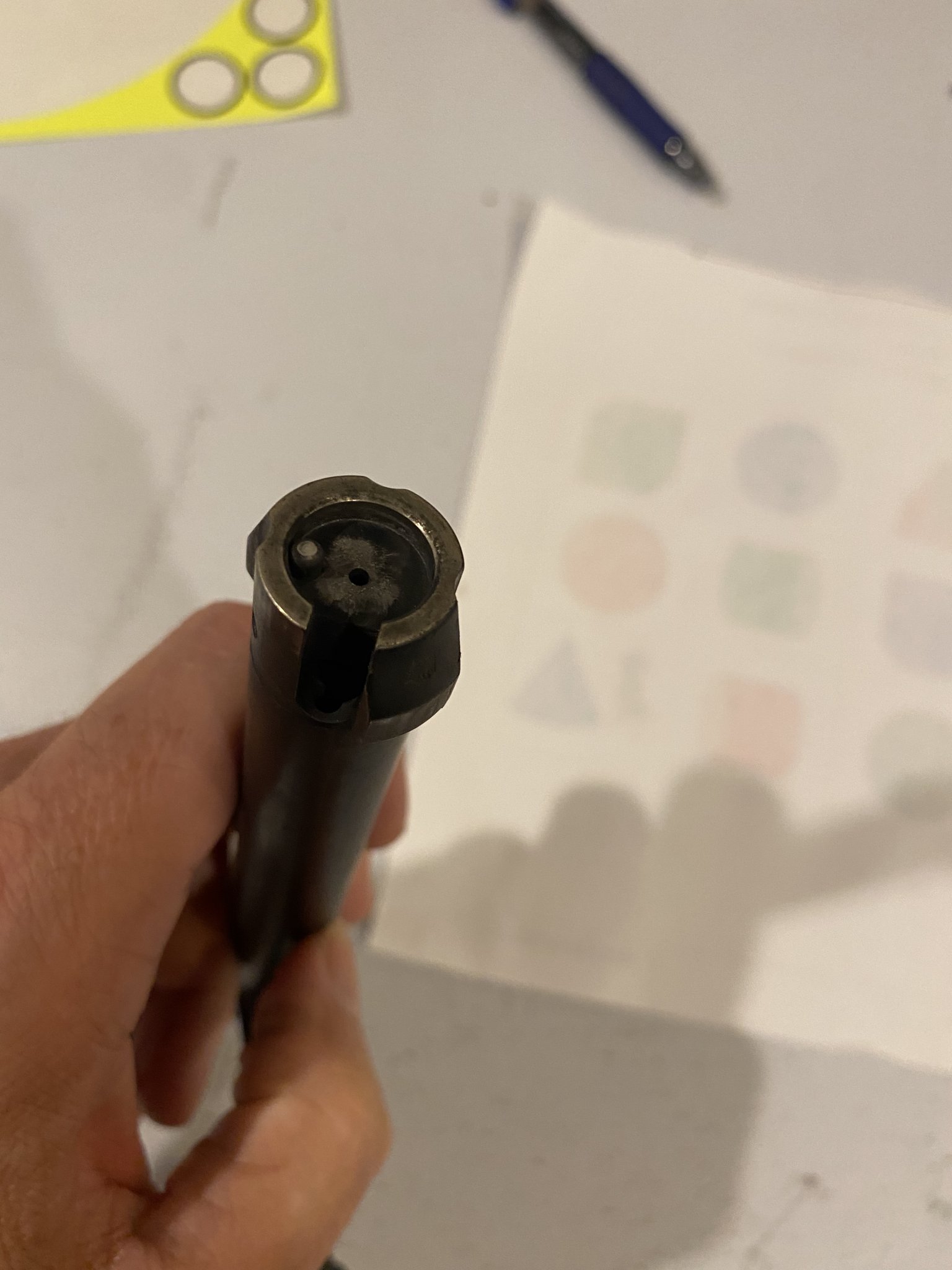

Looks like the Extractor is missing. Plus a lot of carbon. And I have either a case stuck in the chamber, or a complete round. Not how I remember it, but looks like a total shit show.
The OP's photo shows an extractor plunger and extractor plunger spring. This has nothing to do with the ejector, ejector spring or pin.
Please take the rifle to a competent Gunsmith so you don't do anymore damage to the rifle or hurt yourself.
It's not to hard to figure out what occurred.
You shot a hot round and the brass got stuck in the chamber.
You tried to extract the case and busted the extractor.
That's happened to a lot of members here, me included.
Get it repaired, de mill all the hot test rounds you loaded, load some mild rounds that are a few thousandths off the lands and get back to the range.
Good Luck.

And where is the extractor itself? Was it in there under the case rim? If I understood correctly, the spring and plunger for the extractor flew out but where is the claw itself?
Reactions: Taylorbok
Extractor is missing. Don't know if it flew out with the spring and pin, or if it just fell, and I couldn't find it in the gravel. Something hit my cheek (on the cheek weld) when I pulled the trigger.
Reactions: Baron23
It had to. The extractor is what holds in the spring and pin. I'm not sure how those parts would be able to hit your cheek though.
Most likely it was a piece of the blown primer of primer compound coming out of the bleed holes, as when the bolt is closed the extractor parts are fully encompassed by the receiver.
Reactions: Nik S
That bolt face is torched. Were these your handloads?
Edit: I seen where you said that you were testing handloads.
Reactions: Nik S
These were handloads, but they were not part of my test batch. I'd just completed testing, and I was firing off some "extras" from previous loads that I may not have measured correctly and had set aside. I didn't think they were hot, but I was wrong. Big mistake.
