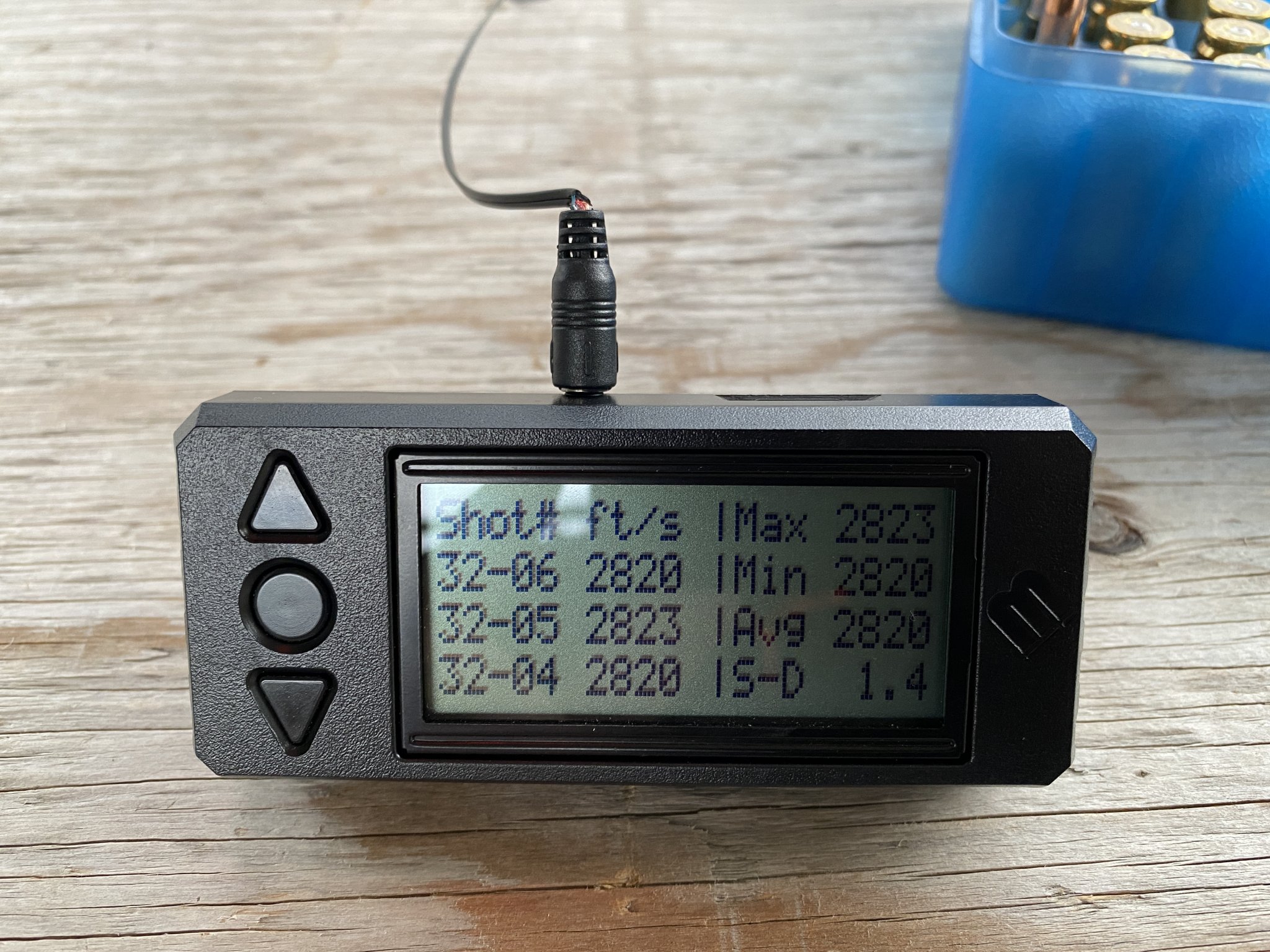

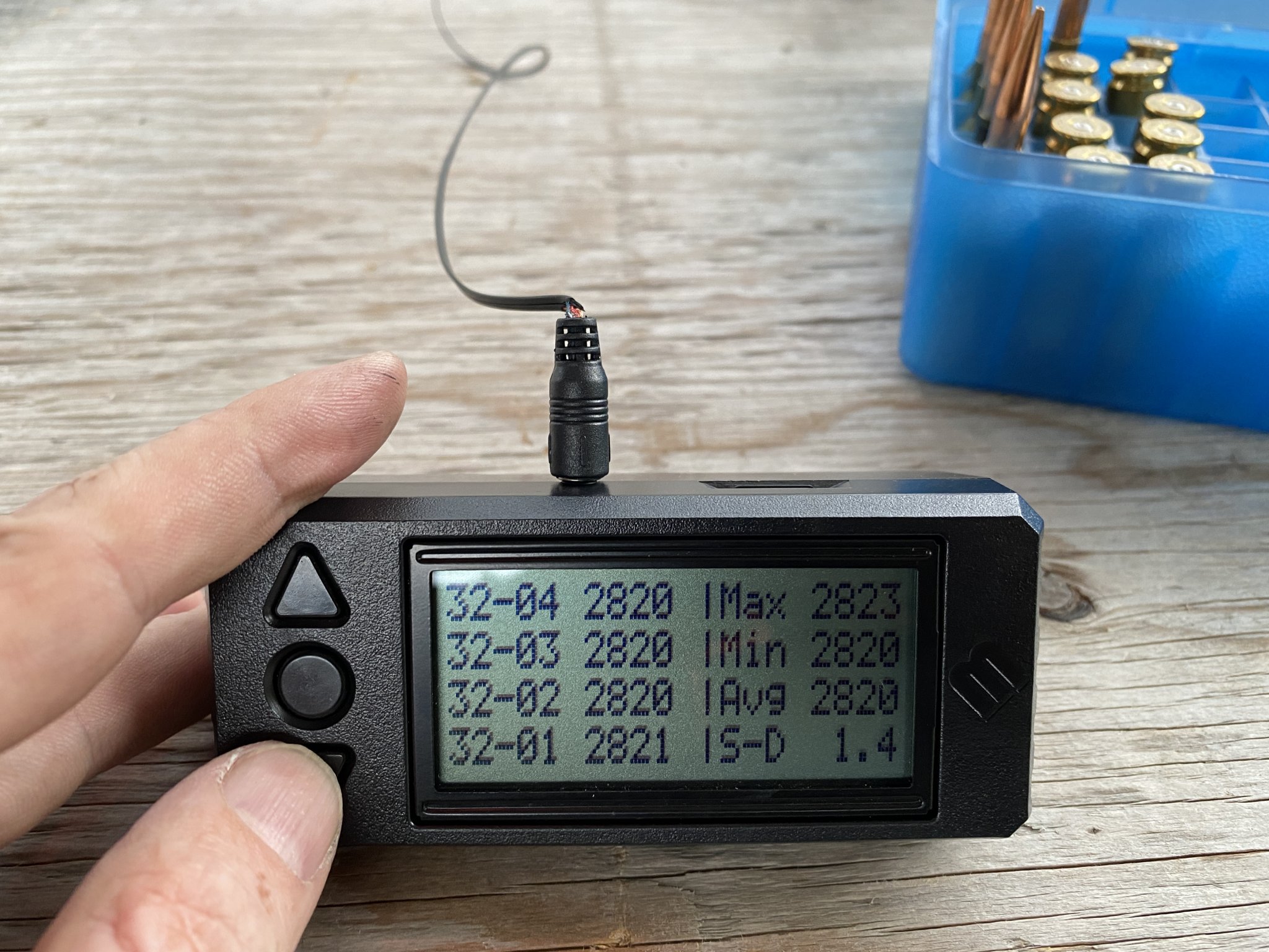

While testing our new Precision Resizing Dies and "The" Seating Die we did some very limited testing. We started off with 20 rounds of 6 BRA fired brass and sized it all with our new resizing die with a .266" neck bushing. 10 pieces were left full length sized with a neck bushing, no expanding. The other 10 pieces were full length sized using the same neck bushing but we expanded up with a 21st Century expander mandrel set, .2415". Then we measured the neck runout on both batches, then we seated a bullet and measured the bullet runout.
The full length sized with neck bushing only ammo had less neck runout and less bullet runout. It averaged .0007" less bullet runout and .0003" less neck runout than the sized and then expanded ammo.
Again, this was a very limited test and we intend on doing a lot more testing as time permits, but it is worth considering which is more important: Bullet runout, or more consistent neck tension? That is the million dollar question.

Here is some more wood for the fire.
For case/bullet combinations where the bullet bearing surface reaches the neck shoulder junction neck tension variation
can become a problem.
I noticed that on some cases after full length resizing and pushing a mandrel into the neck, seating bullets required different amounts of force and the CBTO would vary. Checking with a pin gauge I found that the pin gauge would fit in the neck but would stop or get very tight at he neck shoulder junction.
This tight spot was causing seating inconsistency.
Pushing the mandrel through twice or three times ironed out the constriction and improved the seating consistency.
I realized that the brass (various brands) that had this issue had been reloaded many times so I wondered if my annealing was not working properly.
Using my home made induction annealer I started increasing the anneal time and sure enough the the constriction at the neck shoulder junction was greatly improved.
That's the neck donut. First I read about it was about 20 years ago when David Tubb was developing the 6XC
How/Why does it form? Can it be avoided?
And if you do get it or have it, is a multiple mandrel run the only real option?
