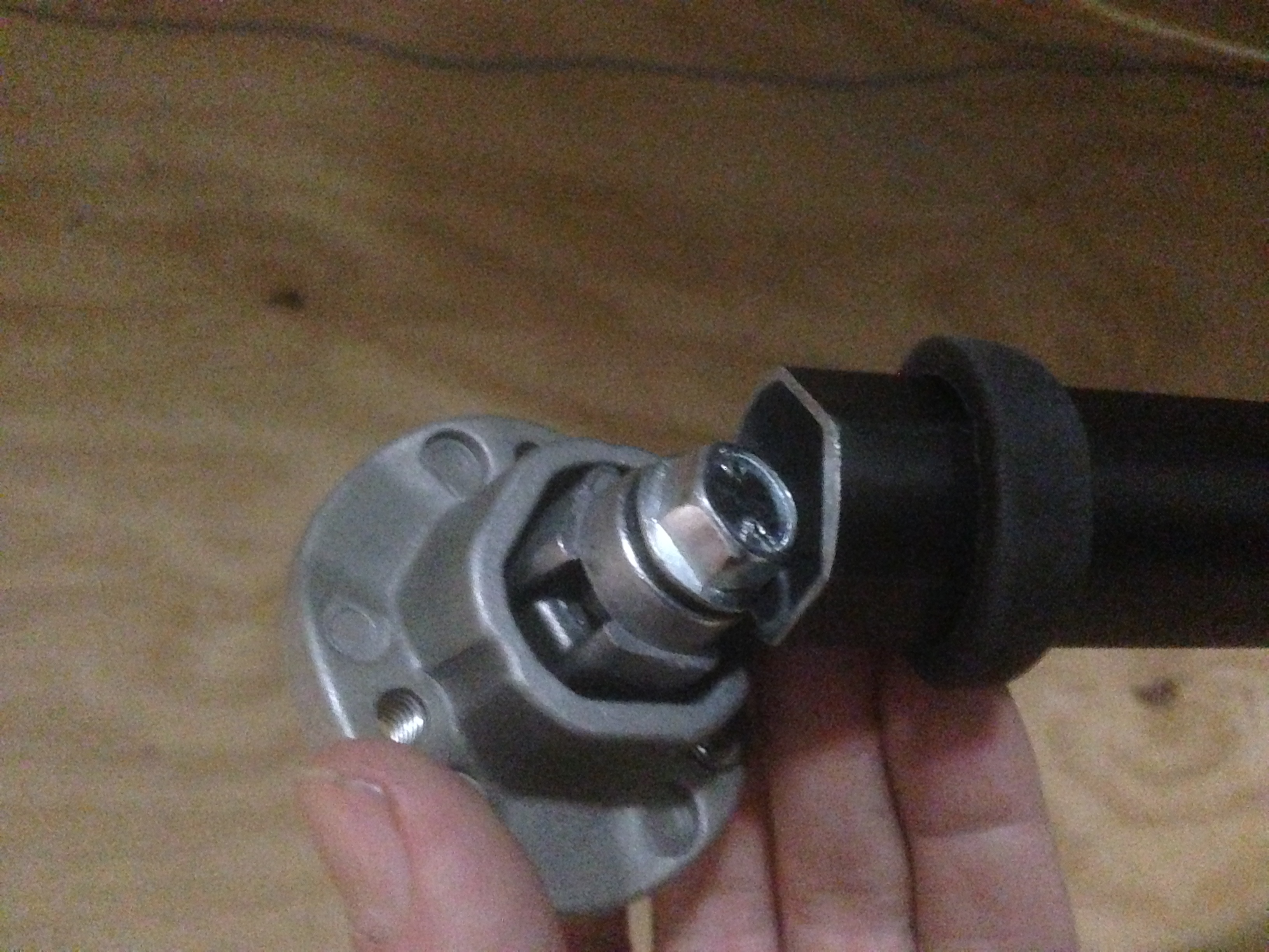

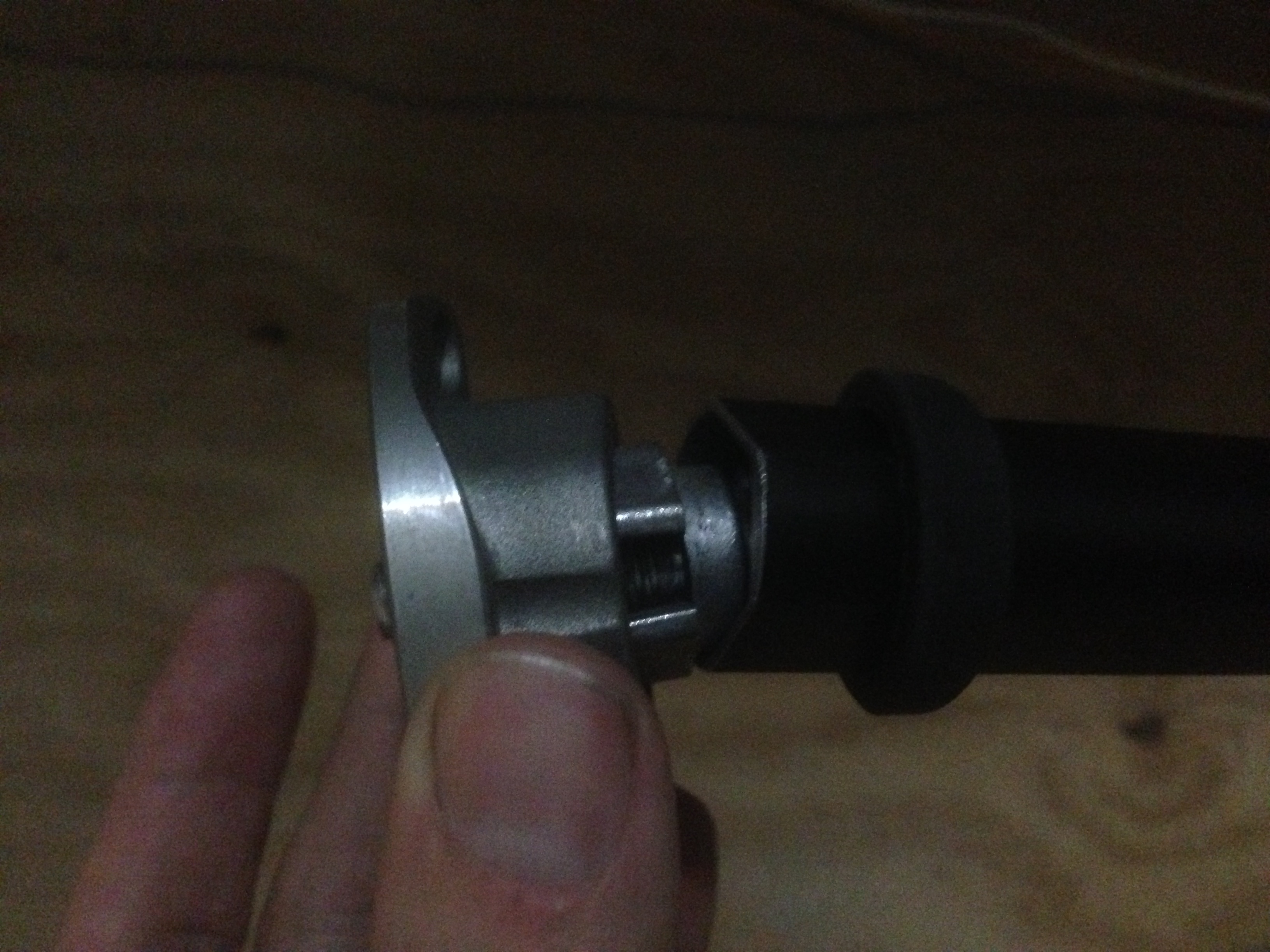

Apologies to the OP for the brief hijack, but I started a thread on an "issue" I'm having my 055XPROB and didn't get any responses, so I'd like to take advantage of all these fellow Manny owners in one place:
The mounting plate on my center column has come "loose" and will pull free of the center column. It works on an expansion/cam system whereby as the threaded bolt is tightened (reverse thread) it expands the mechanism inside the center column and holds in place by friction. I have (carefully) tightened it down as much as I can but when you tighten down a tripod head (standard thread) it can loosen the bolt that holds the mounting plate. If one of my rifles takes a tumble because the plate pulls out, it will probably survive. If my Canon DSLR with Lens hits the pavement then I'm screwed. Attached are a couple of pics to see if anyone has any suggestions. So far nothing back from Manfrotto on the question:

I posted earlier about how I'd managed to screw up my 055 and in the absence of anyone else ever having had the same problem, I took it to the Rapid Prototyping guys on our camp, who are literally geniuses in engineering and designing battlefield solutions to problems. They got me fixed up, but the big bonus came when they handed me a complete 190 that they'd dug out of the salvage yard. It was in the trash on the way to be shredded and figured I may be able to use it.
SO, not only did I get my 055 fixed (for free) but I also ended up with a free 190. If I can help anyone out with a direct side-by-side on anything let me know.
