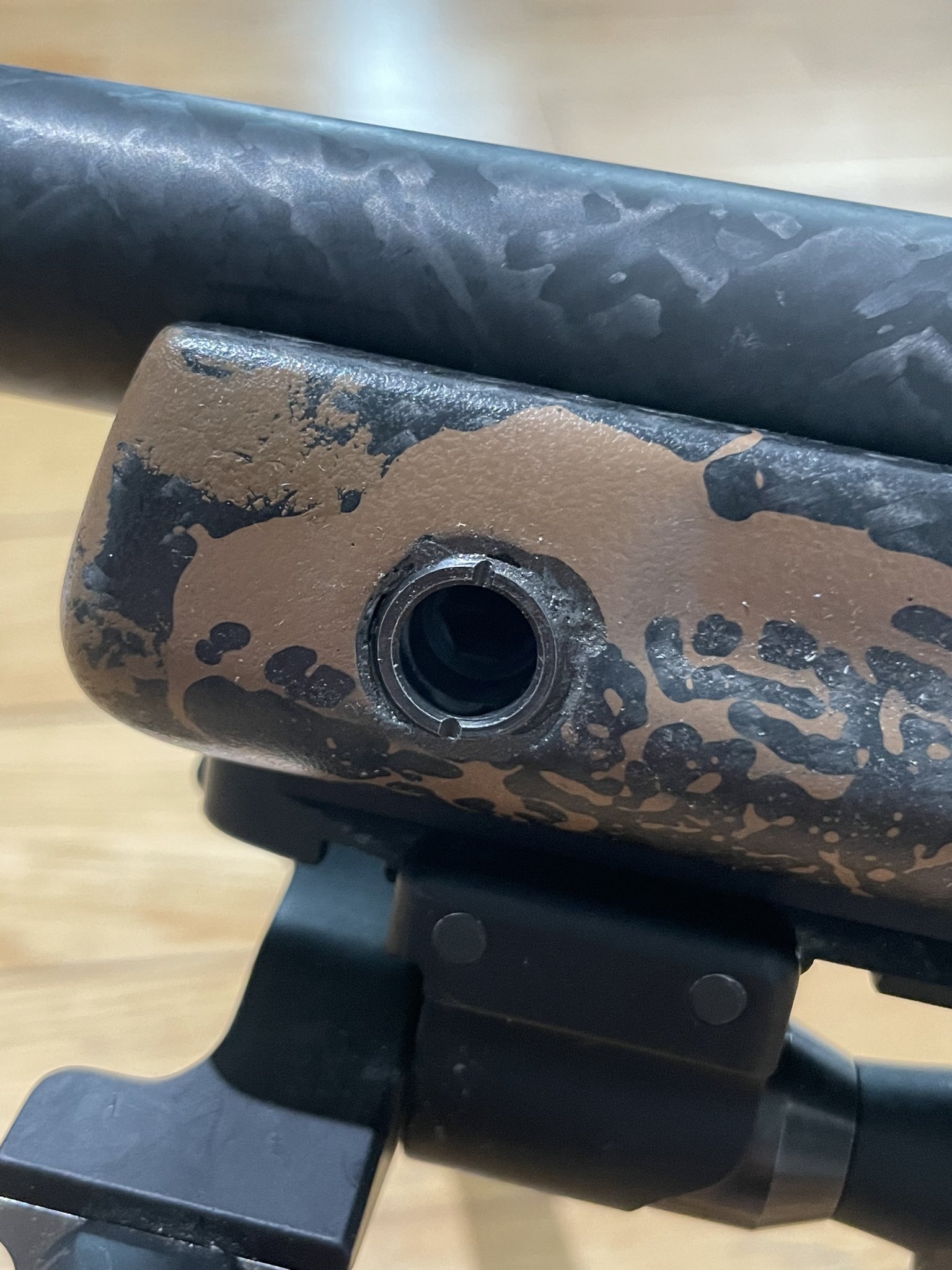

Thanks!I had an older Manners stock I got from a friend and it had full rotation qd cups that I changed myself and it came out really nice. First I found a drill bit that fit the inside of the qd cup snug. Then I take the drill bit out of the cup and heat the bit up with a torch, get it hot and put it in the cup. With the hot bit held with vice grips let it sits for a couple of seconds the epoxy melts and the cup should come right out no problem. Then epoxy in the non rotational cups.
Just to be clear...the cups have threads on them against the stock, so once you get that old epoxy loosened up, you still have to unscrew them to get them out.I had an older Manners stock I got from a friend and it had full rotation qd cups that I changed myself and it came out really nice. First I found a drill bit that fit the inside of the qd cup snug. Then I take the drill bit out of the cup and heat the bit up with a torch, get it hot and put it in the cup. With the hot bit held with vice grips let it sits for a couple of seconds the epoxy melts and the cup should come right out no problem. Then epoxy in the non rotational cups.

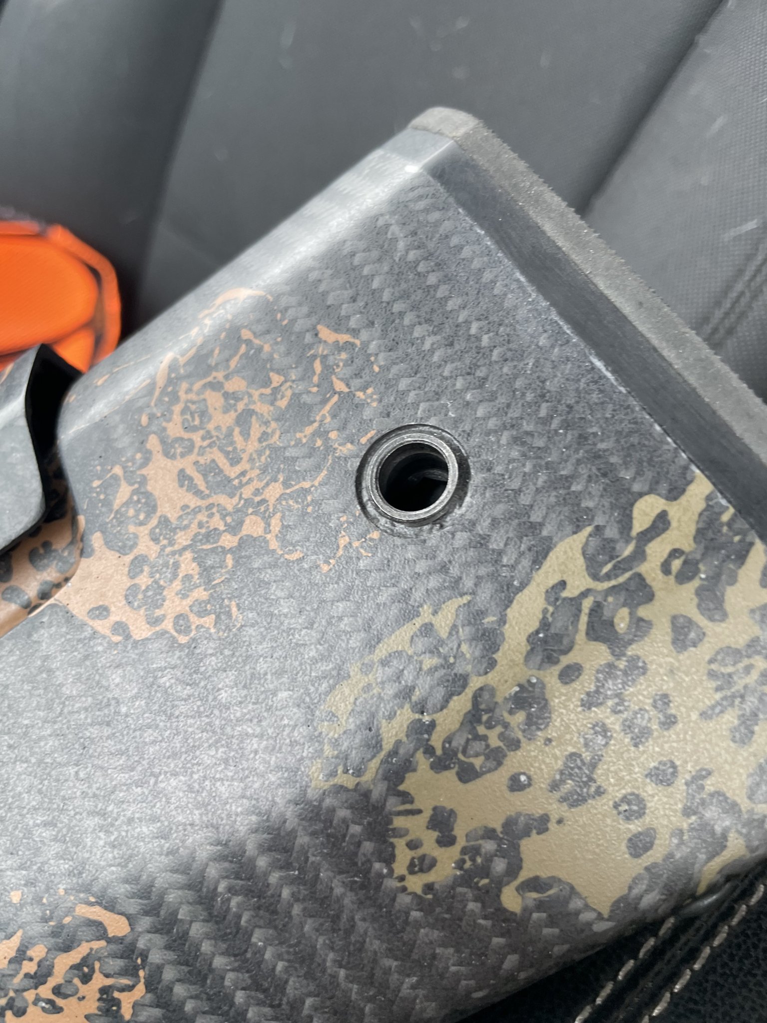

Finally tried the drill bit technique today… worked like a charm! I worked a lot faster/ better than I imagined! I had one limited rotation one I found in a gun room junk drawer and it was an easy swap. Now just need to wait on the Grovetech order to swap the back one outI had an older Manners stock I got from a friend and it had full rotation qd cups that I changed myself and it came out really nice. First I found a drill bit that fit the inside of the qd cup snug. Then I take the drill bit out of the cup and heat the bit up with a torch, get it hot and put it in the cup. With the hot bit held with vice grips let it sits for a couple of seconds the epoxy melts and the cup should come right out no problem. Then epoxy in the non rotational cups.
