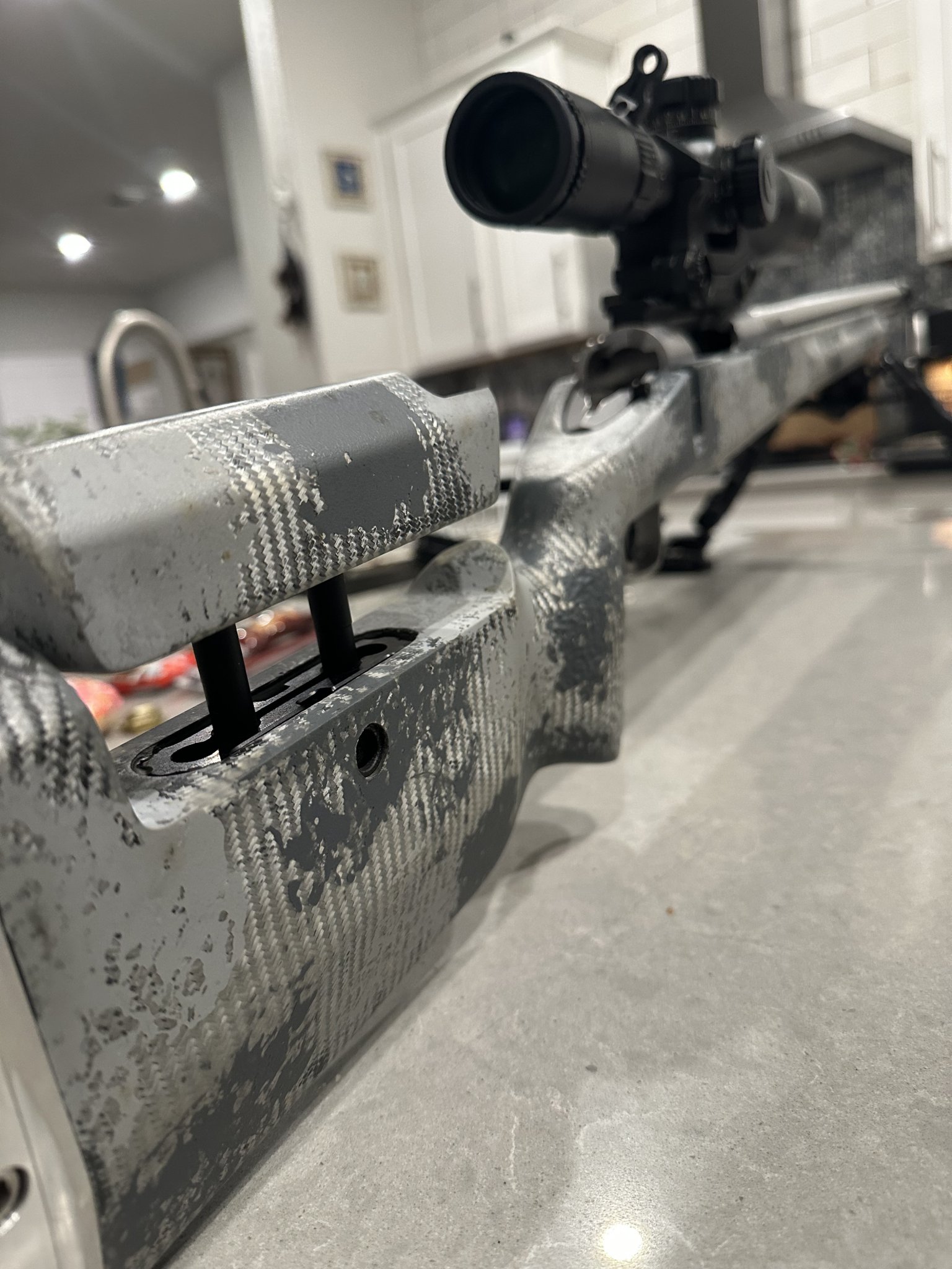

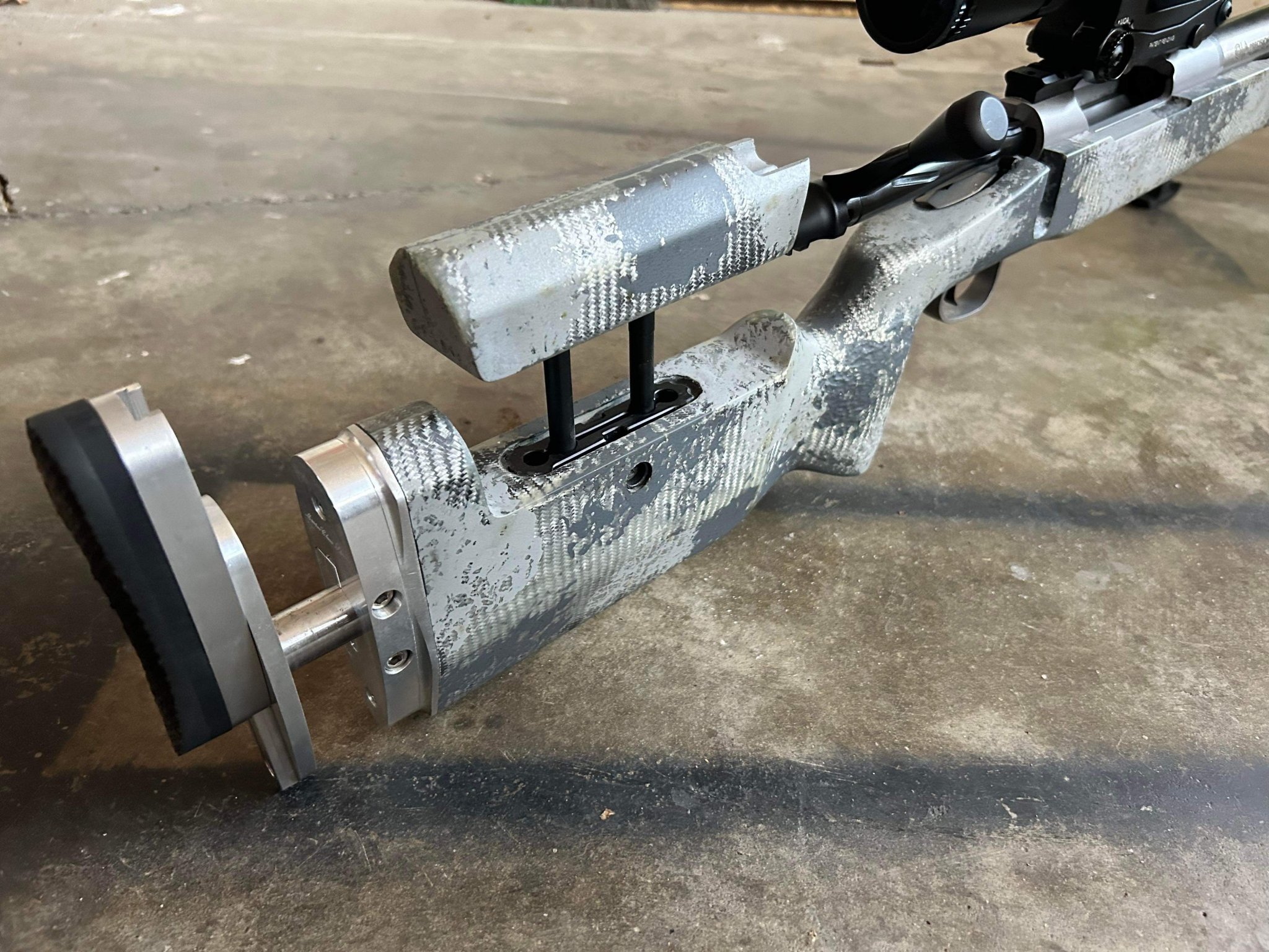

Yes, the Manners LRT 2.0 has an optional adjustable bag rider but they said they don't recommend it for 1.47" actions like the BAT CT. Manners said it's for 1.75" and 2" actions. That's where the Manners ELR light stock comes in, but they don't offer it with the ABR, as they say there isn't enough meat on the butt to accommodate it.
I've seen Terry Dines and 4AW adjustable bases and they look excellent. I just wouldn't mind finding an option that doesn't require turning knobs
I was originally thinking McMillan A6-A7 Supermag with the angled rear, but I wanted to try the Manners
Scott
Reactions: Taylorbok
I was a little sad to find this out to say the least. I had planned to order one of these stocks but wasn't using the larger action.
I'm hoping to have something custom made with ABR built into the stock. Either Cerus or another company up in Canada here, Rifles Refined.

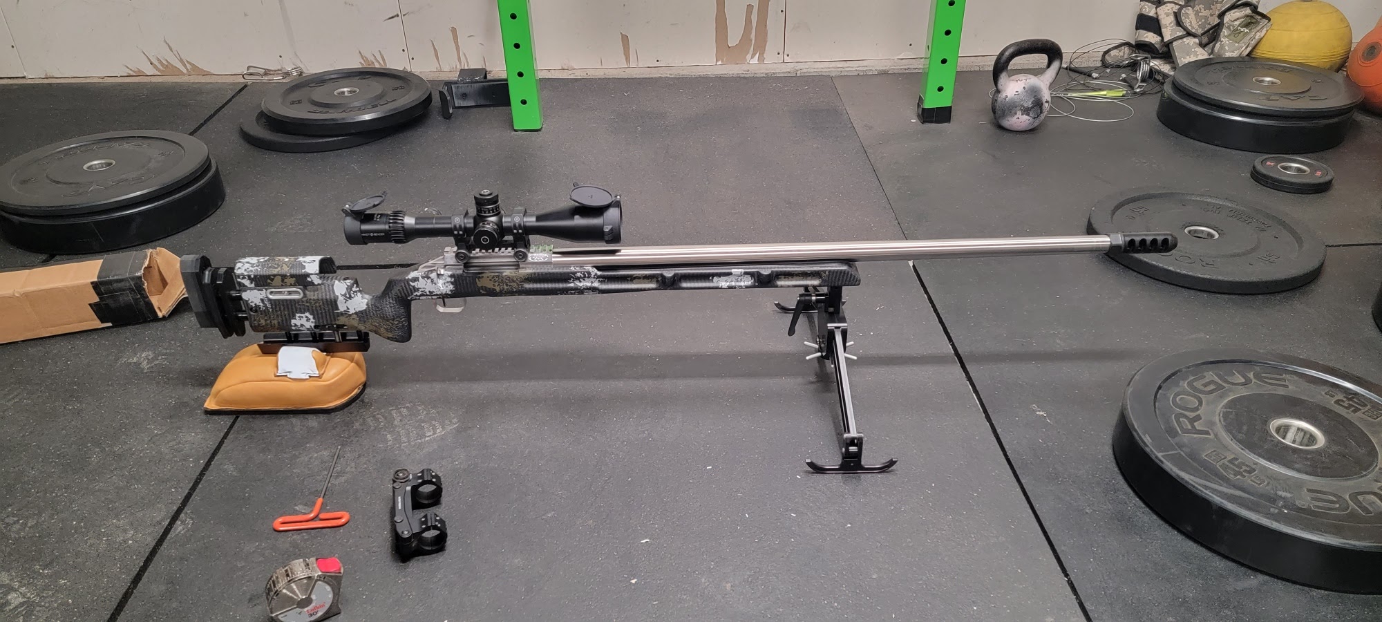

In regards to stocks, I have both the LRT light and LRT 2.0 heavy. My LRT light is right at the limit coming out to 25 pounds and 7 ounces, fully loaded with an ATACR 7-35 sitting on top of it. I use an era-tac permanently set at 20 MOA to take advantage of my full scope elevation and negate the need of a prism to save weight.
The pictured LRT is chambered in 33xc, 1.45 inch straight barrel, 30”.
In regards to rear rests for the light stock, Ryan Cheney makes rear air foil bags that are very reasonably priced that I’ve seen around the ELR circuit. Quick shipping too. I personally have not used them. If you use a bipod EXT, you will probably not need an adjustable rear bag.
I have both the adjustable rear rests from 5 AW and Terry dines, hands down I would go with Terry Dines one over the 5AW. Match that with the ELR wedge or hunters wedge from thunderbird long range and you’ll be all set.

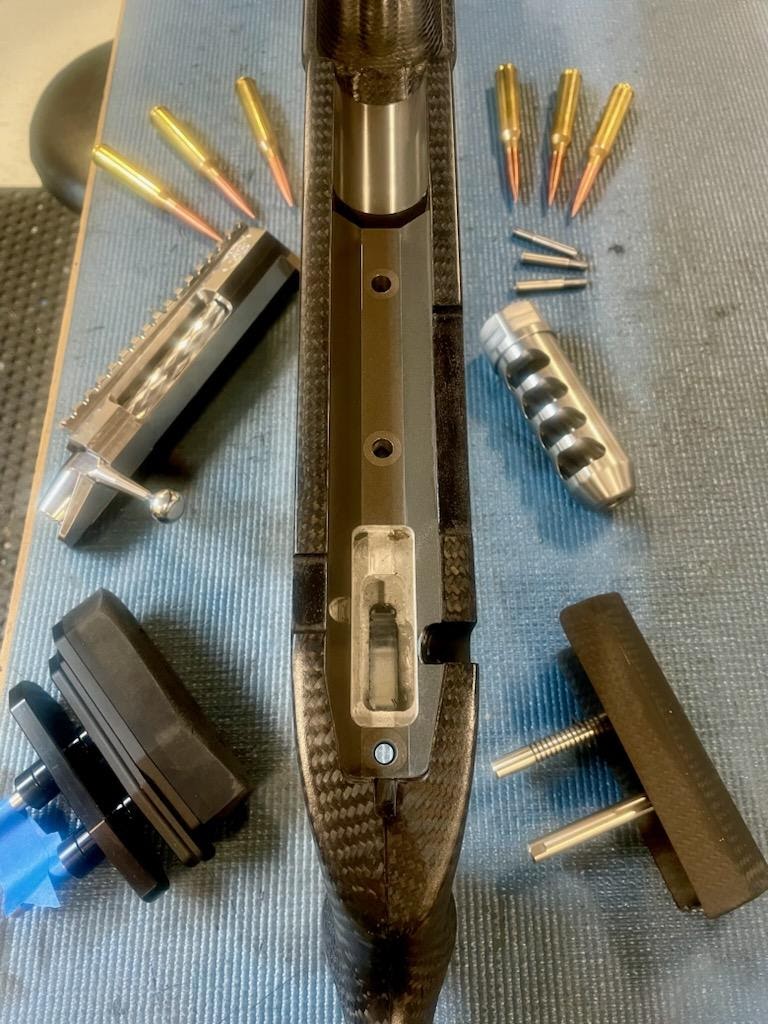

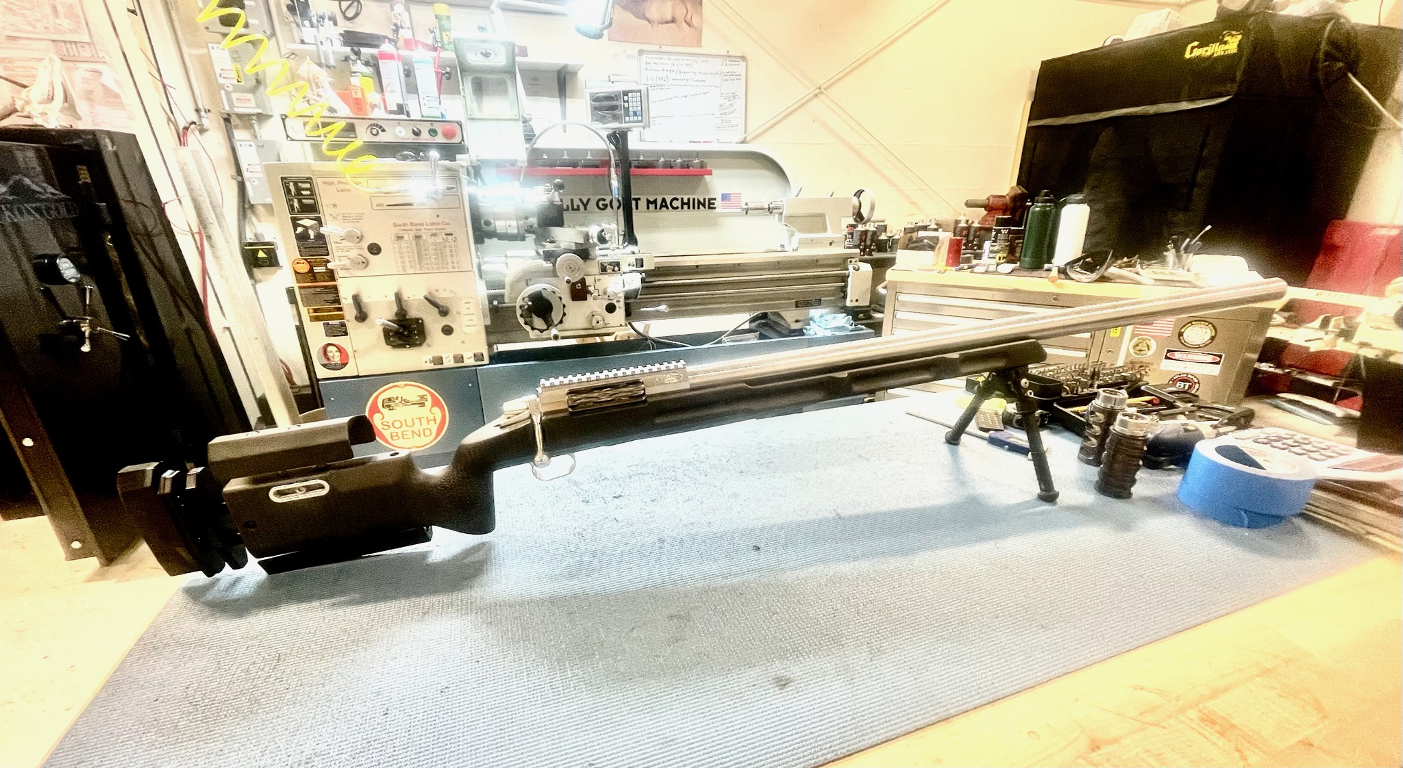

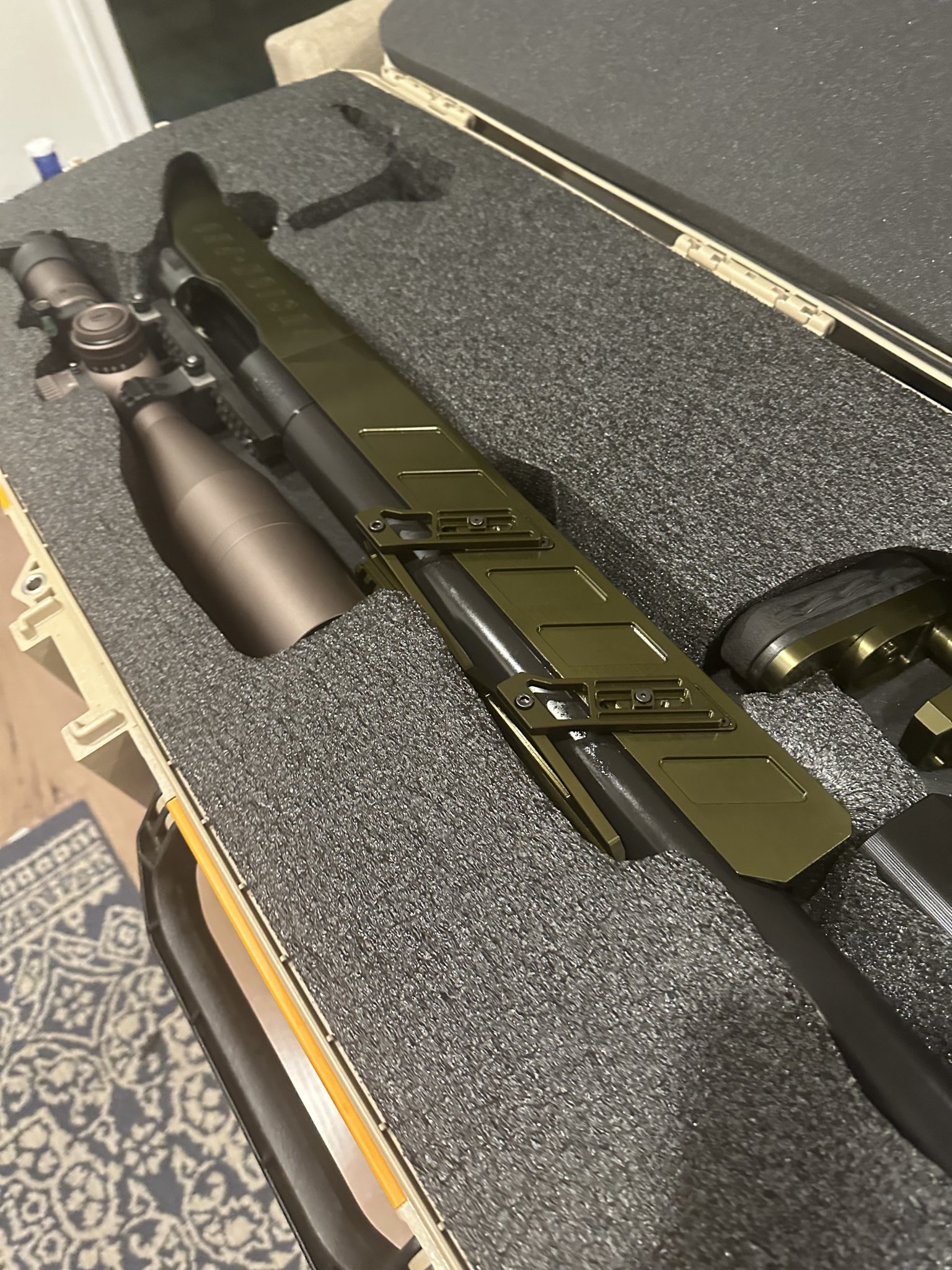

There are plenty of ways/tricks to make weight, case in point, one of my heavy ELR rifles came out 53 pounds, primarily due to the 2” straight 38” barrel. I swapped components (scope mount, scope, bipod, brake, 100 yard zero with a 15” offset so that I don’t use a prism) and now I’m within weight.
Terry dines helped tremendously to provide some of the components needed to get under weight.
Rifle is attached for reference. (Photo credit: @BillyGoatMachine)

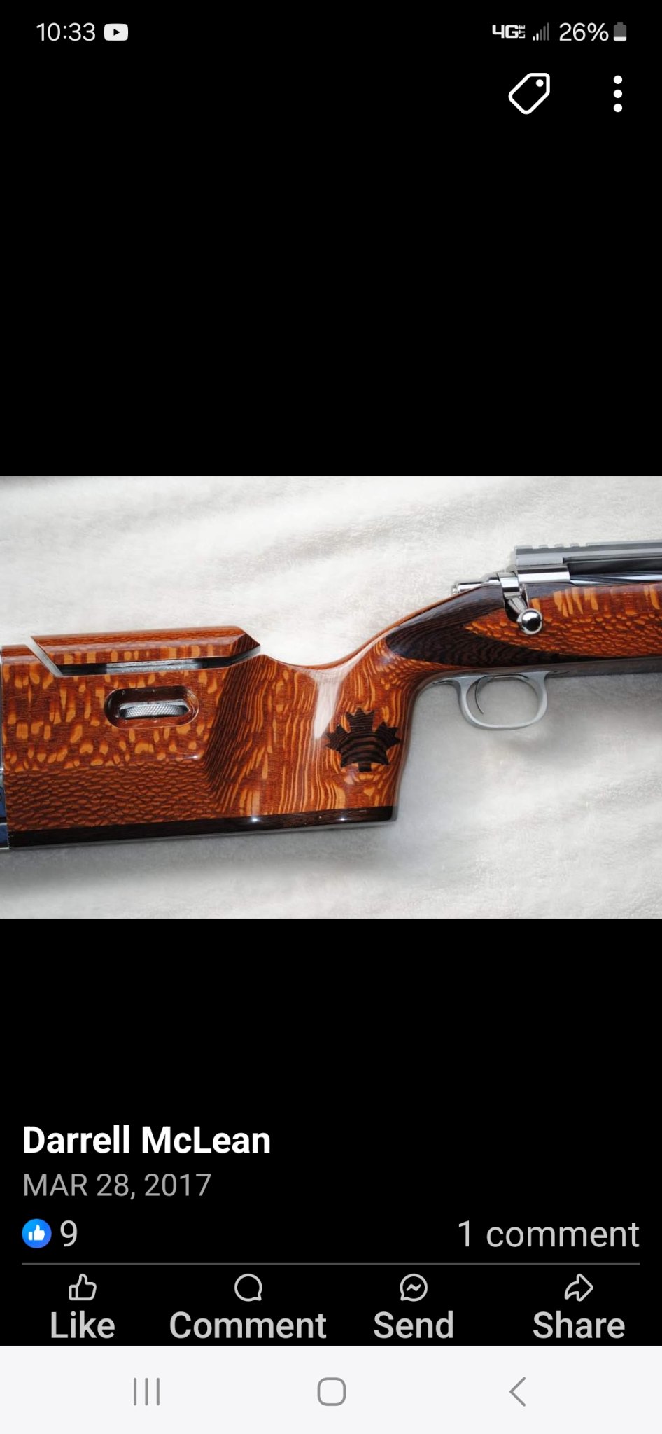

Go talk to darrell mc lean
