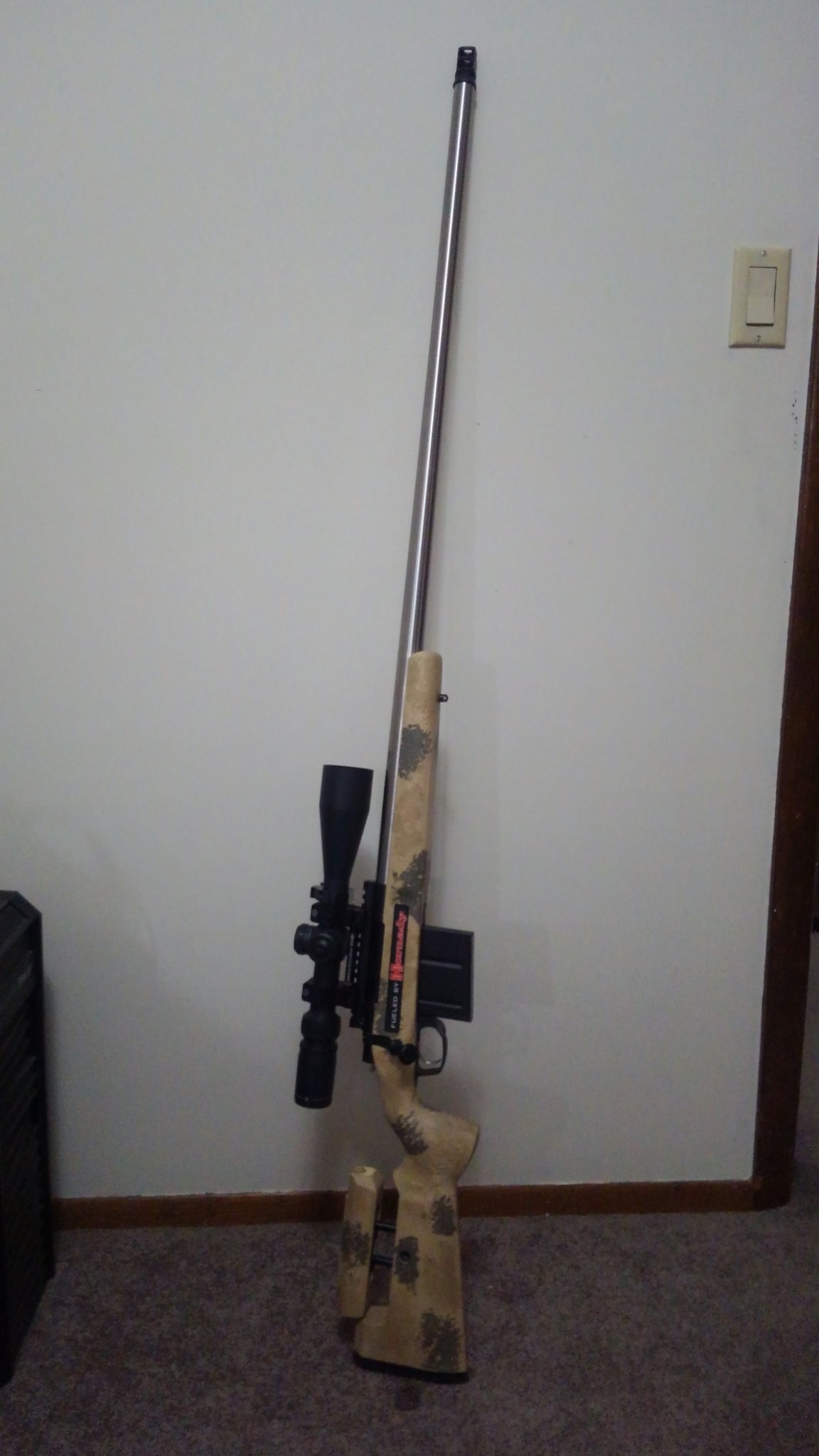

    They offer L/A mini chassis in the standard configuration (3.750" outside to outside magazine) for L/A, as well as for "CIP" length magazines (3.850" outside to outside). I got a T2A with the CIP length minichassis and can use Accurate Mag .300wm 3.850" long magazines that allow me to seat to 3.750" Cartridge OAL.
    Nucleus action allows for 3.78" COAL so everything bolted together nicely. The Manners stock came with a .338 Lapua magazine that does not work well with .300 PRC, but like I said, the .300 win mag magazines from Accurate mag were plug and play. All I did was hit the feed lips with some 400 grit paper to soften sharp corners (was scratching brass).
    Yeah, 37" pipe.

    The local ELR group shut down this summer for covid so it's been a minute since I shot it, but I was in the 2930-2950 ballpark with 250 A-tips with a near-book-max load of Retumbo. Coming from a 30" barrel I didn't gain as much as I thought I would. 10fps/inch or so if I recall.
    I'm short, about 5'7" but with a 9" can it's about level with me.
