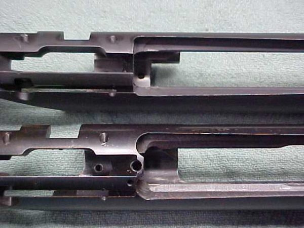

A bit late on this but I recently chased this down for my own project. The problem is the early Origin actions. Mine is in the 2300's and was affected. It has to do with how the magwell is machined.
In order to use the Hawkins Hunter DBM your reciever needs to be machined flat like the top one in the picture. Mine looked like the bottom one and would not work with the Hunter DBM. Not sure when they changed the magwell profile but later actions will work. I ended up using the Grayboe bottom metal and a 3 round Accurate Mag for my 300wm. Also, I believe this only affects long actions.
