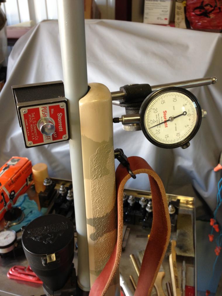

Dudes dropping some knowledge wats a dial indicator and how do you use it? Is there a YouTube video?
Get your stock held rigid or better yet mount it on the rifle itself and when you tighten or loosen the action screws you’ll be able to see if the barrel is moving or not. A proper stress free bedding job will hold the action evenly without imparting any stress and this movement of the action/barrel.
Yes, exactly what spife7980 said and pictured. But to get a little more specific you want the muzzle elevated as he pictured, but not pointing straight up as that can give you a false lift. Rather have the rifle pointed kinda like your shooting up a very steep hill but not straight up, somewhere around 1-2 o’clock as opposed to high noon. When tightening and loosening the action screws any more than 0.002” - 0.003” of movement is where I absolutely bed an action, ideally it will be 0.000” **YOU ALTERNATELY TIGHTEN AND LOOSEN THE SCREWS, SO ONE IS ALWAYS TIGHT**
