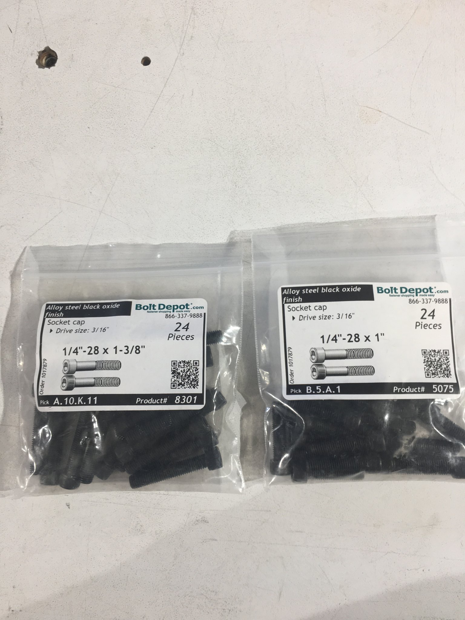

I just ordered a new Remington 700 that I want to fit to a Manners T4A mini chaissis I had laying around... My question is will the stock 700 action screws fit the chasiss? I had a defiance action in it before switching that to a T4A PRS stock. I just want to have the right screws on hand before I get the new rifle.

1/4 x 28 x 1 3/8” Allen head cap screw on the left and 1/4 x 28 x 1” on the right. Can be had at your local hw store, or buy them online. Buy a stash online, lots cheaper and you’ll have them when you need them.
There is no such thing as a “one size (length) fits all”. They all need to be fit for proper length. Never install your bolt without checking for proper front and back length first.

most likely not, I just got mine a couple months back. Screws where too short, went over to my local ace hardware store and bought new screws which will be a little long and had to cut them to fit.
