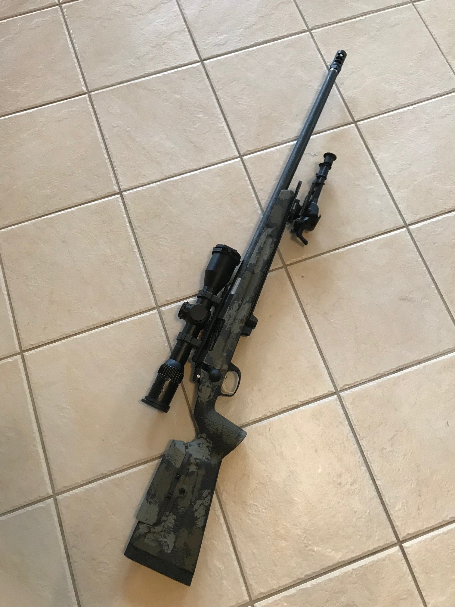

I use a PRS2 on my hunting rig. Have an almost identical rifle set up with a steel barrel and S&B 5-25x on it. Keeps thinks ergonomically simple, and it's been very handy, even with a 26" barrel in thick scrub. Light and well balanced.

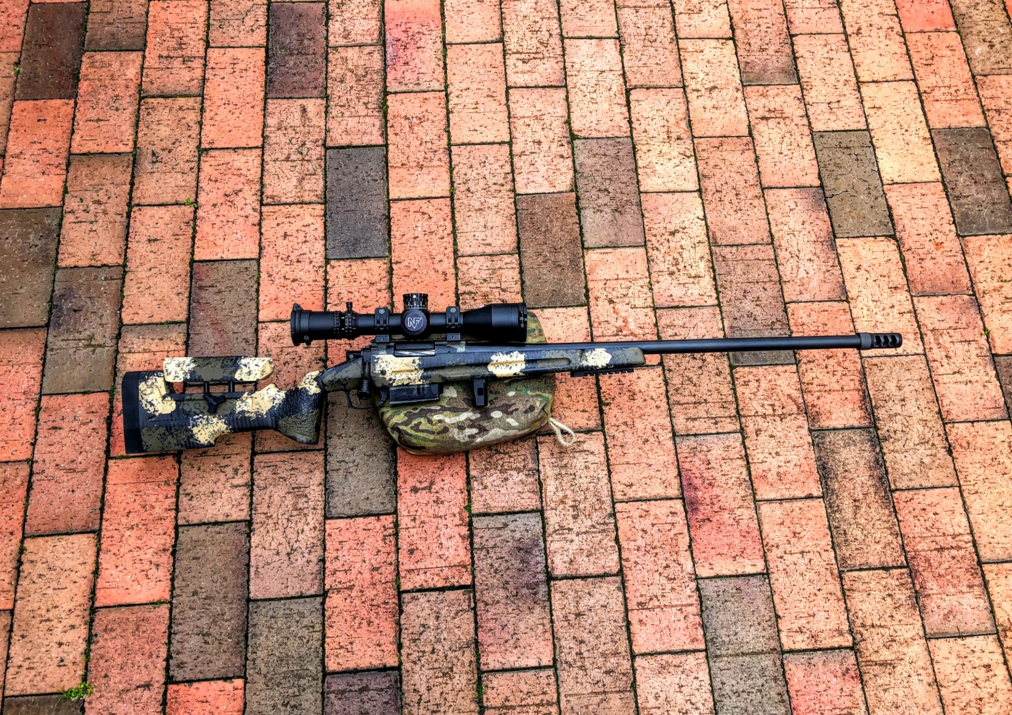

The comp stocks are all too heavy for any rifle that's going to be toted long ways up steep stuff, but for day hunts or situations that don't require much mobility, they're awesome. '
This is a touch under 14lb as pictured. I could run a carbon barrel or chop the 26' down to 20 to knock some weight off but it's never going to be a lightweight rig:

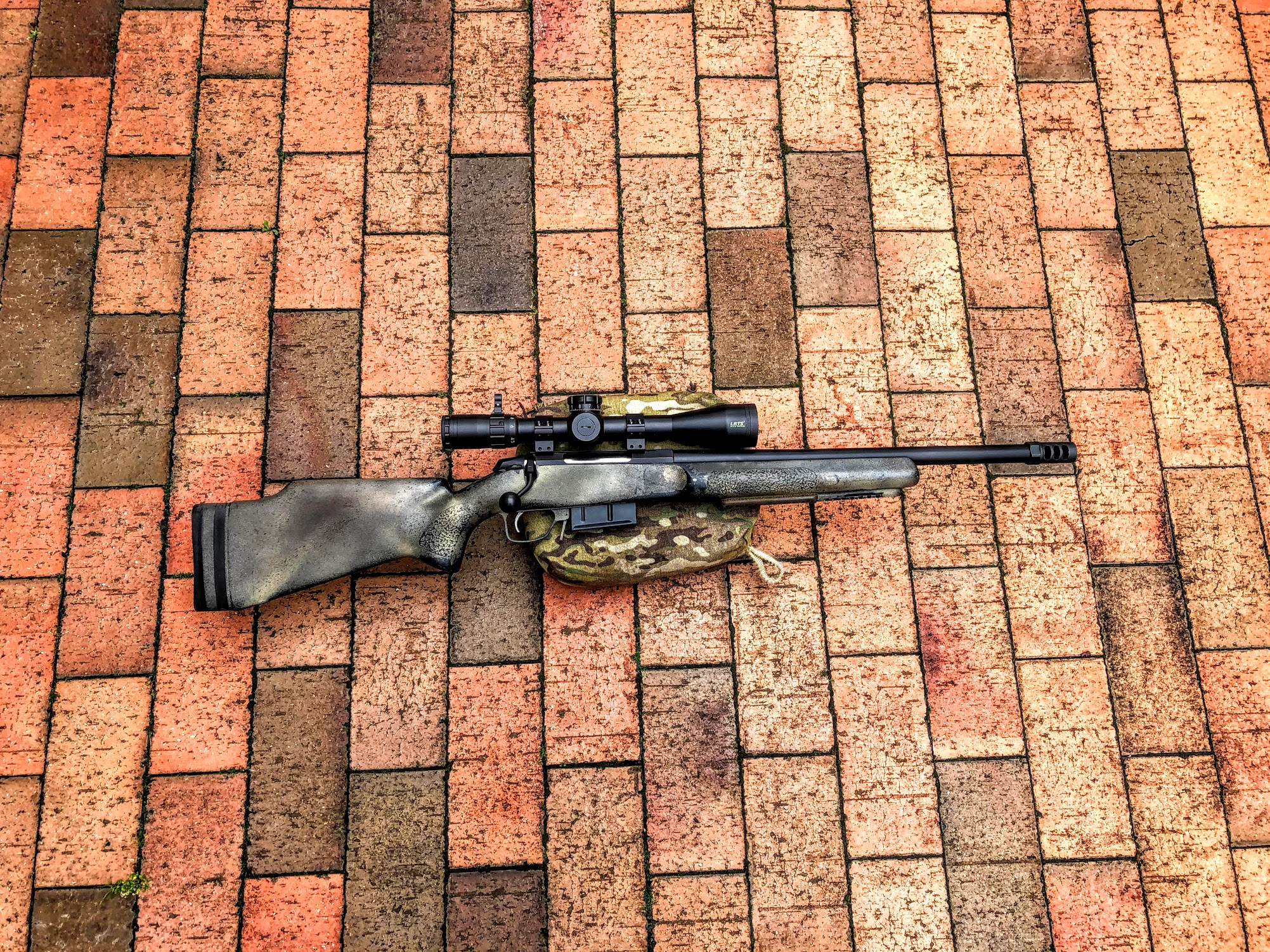

For a mid-weight hunter, I'd opt for something more like this, which comes in at 10.6lb:
