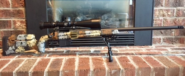

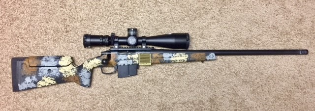

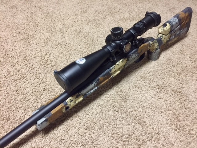

Anyone running a rail for their bipod on a PRS2 stock which comes with only 1 stud that they installed themselves or are you just running a Harris?
