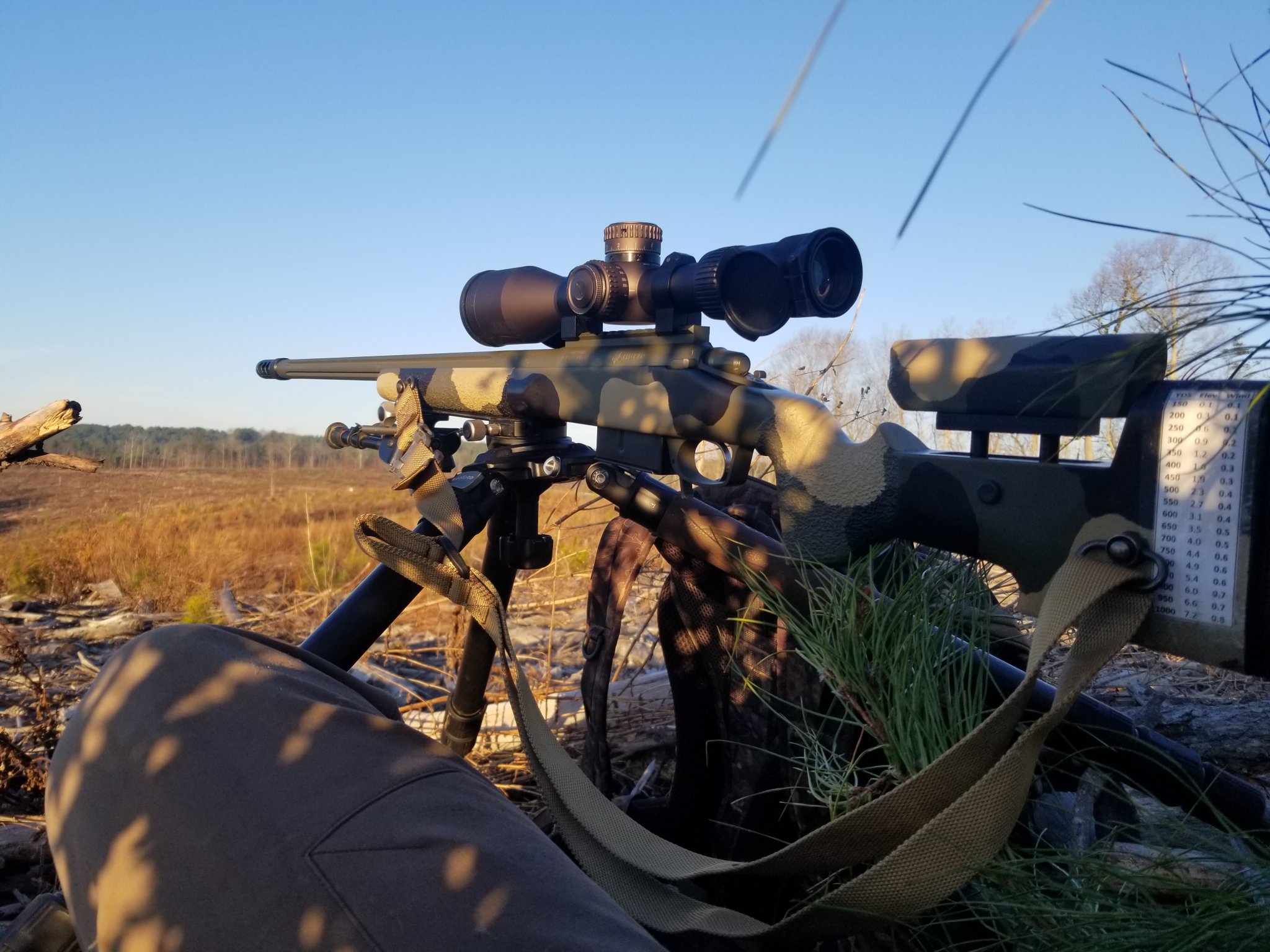

OP definitely get the mini chassis. It's a no brainer as it's bolt in and go. As to which stock, you can't go wrong with either but look at the pics to help you choose. The T4A has a more rounded forend and the PRS is more squared.
T4A
PRS1

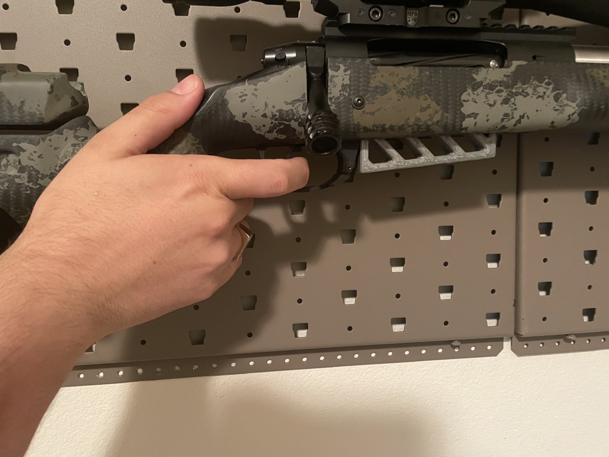

the length from the grip to the trigger on my t4a is what im referring to. I have large hands and im not close to being able to get a 90 degree break
Odd. I have normal sized hands and have no problem doing it. Are you wrapping your whole hand around the grip?
Nope. Pics included. I also have the team version may be that. I also have an EH5 I ordered normal and it's perfect.

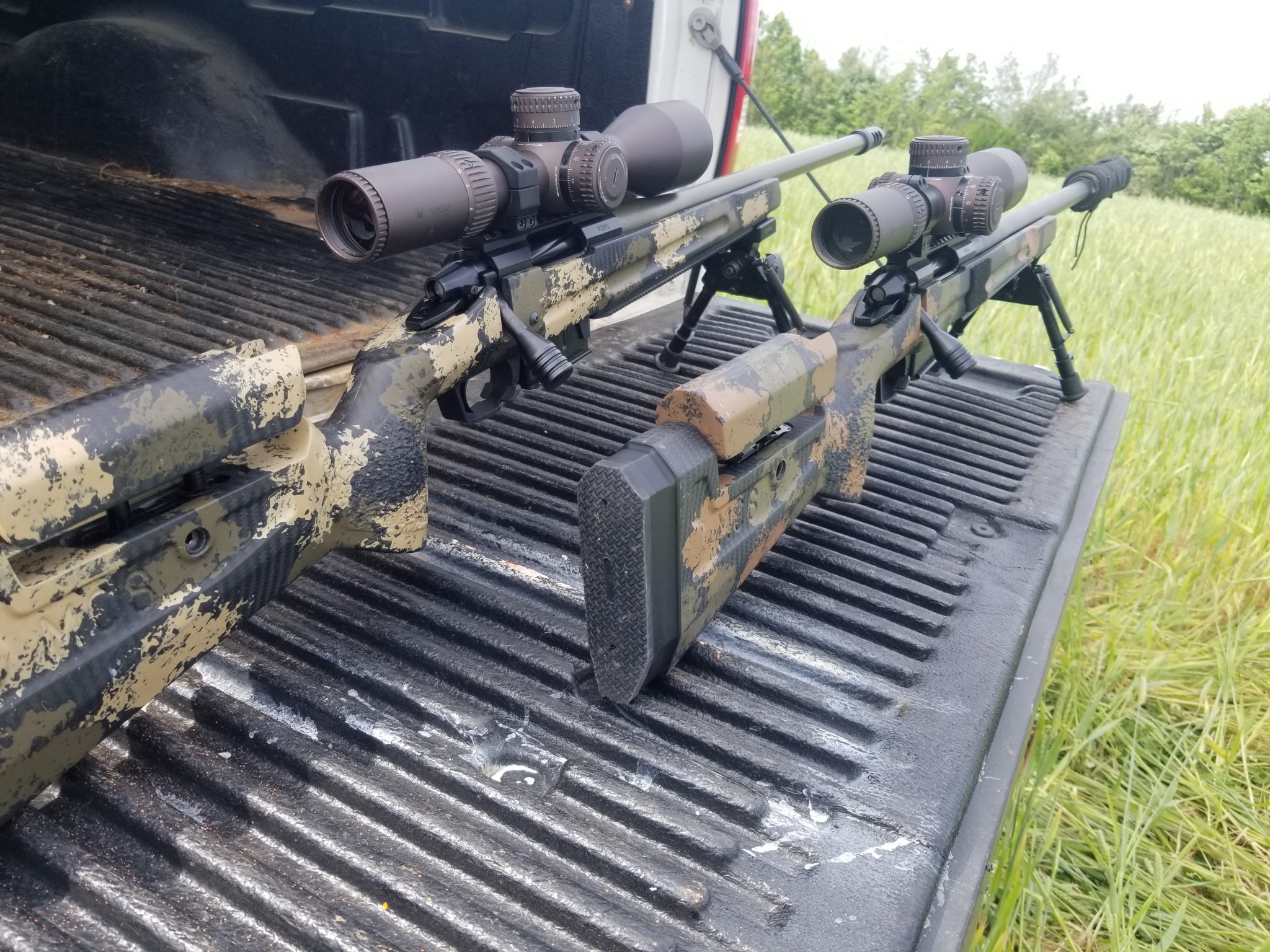

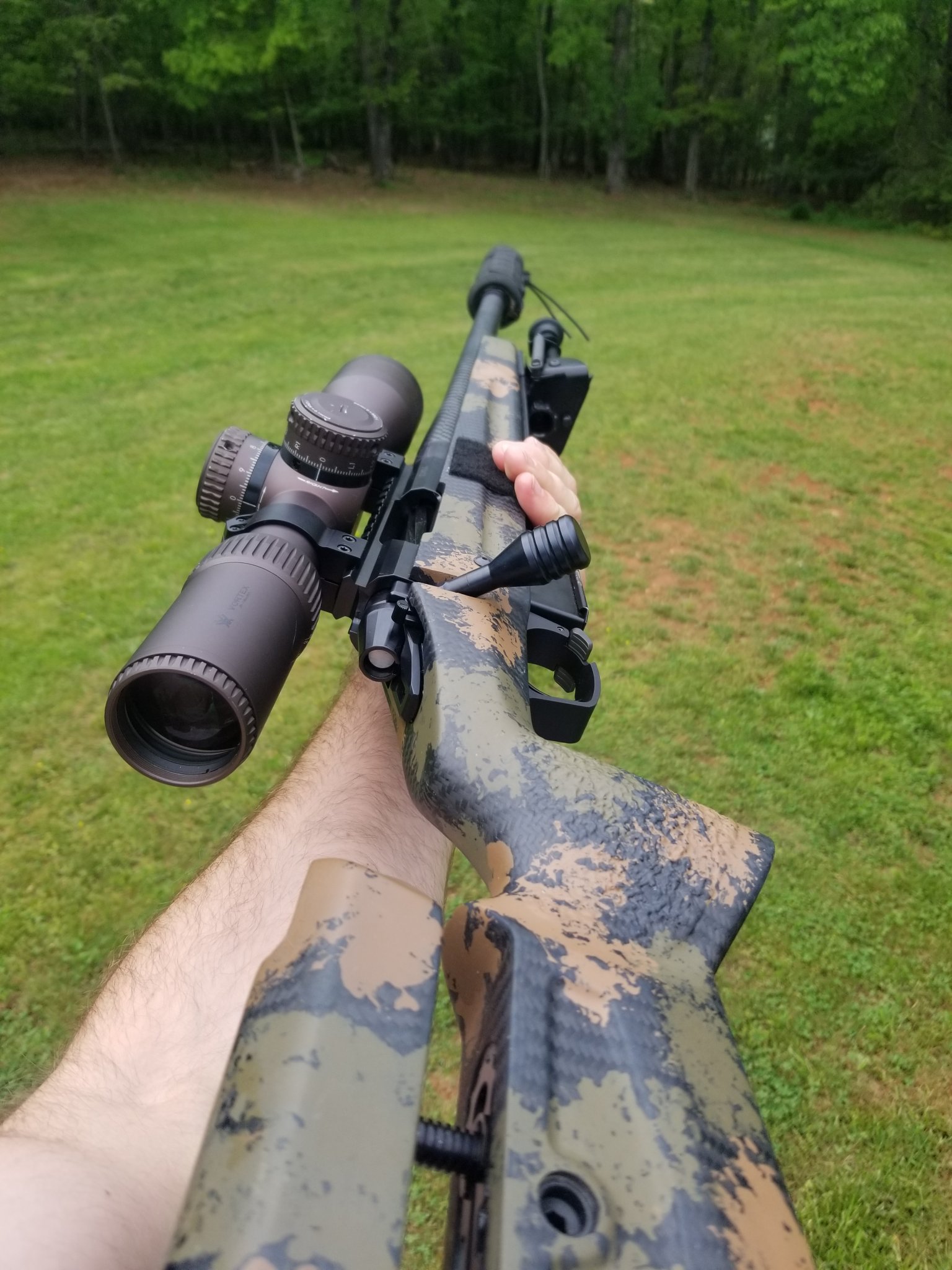

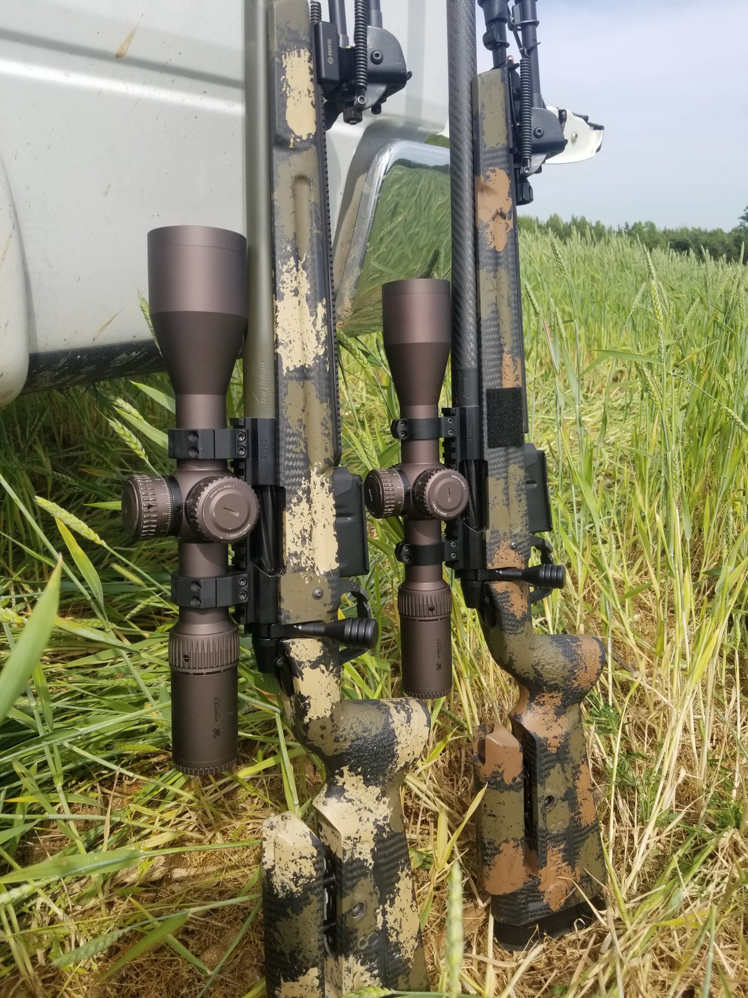

I just picked up 2 mini chassis PRS2 stocks. Formerly had McMillan A3 and A5s not bedded. The repeatability of the bolt in and go mini chassis system is bad ass. I'm really liking mine. Have a 6BR and a 6.5SAUM in the pics. They are lasers. Would like to get an EH1A with a mini chassis next! I like the McMillan marble stocks more tha anything, but the chassis/stock hybrid in a Manners is very hard to beat, especially since I'd never want to bed a stock to a specific action.
curious why you didnt see the same repeatability with the mcmillans
ive even moved rifles between different mcmillans and pretty much always within .1 mil, sometimes no change

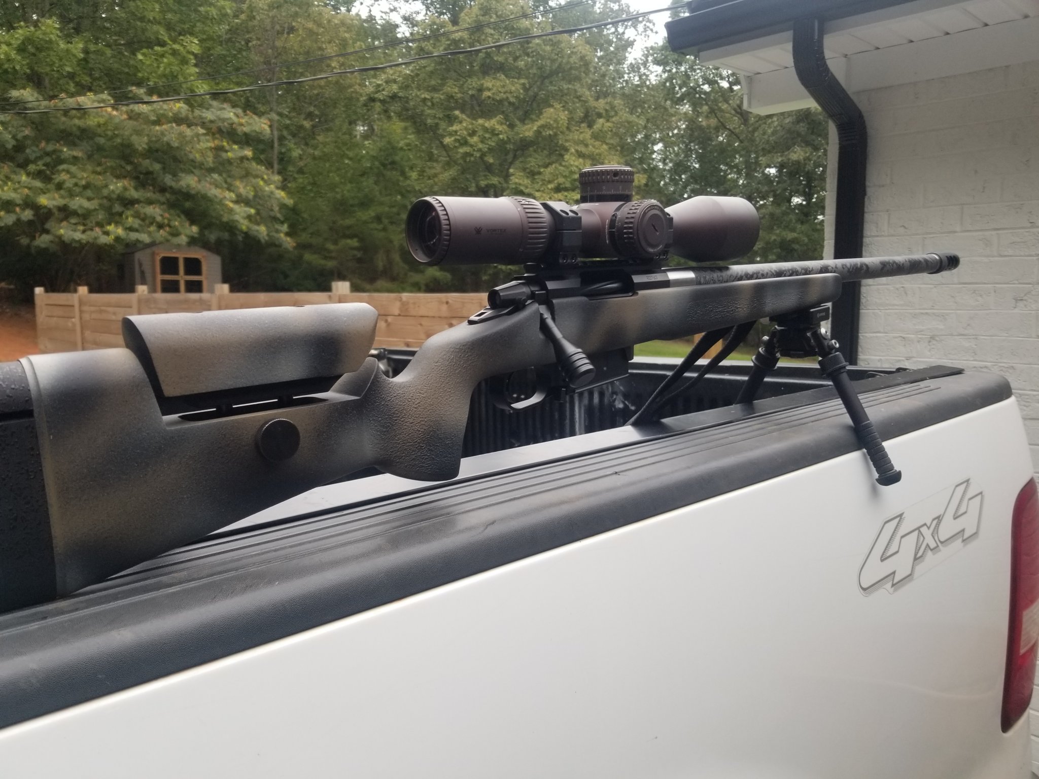

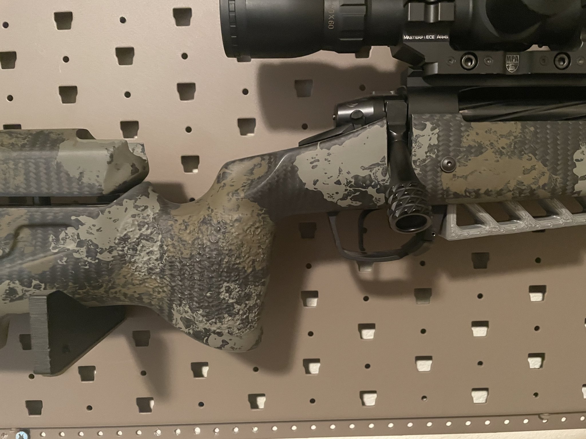

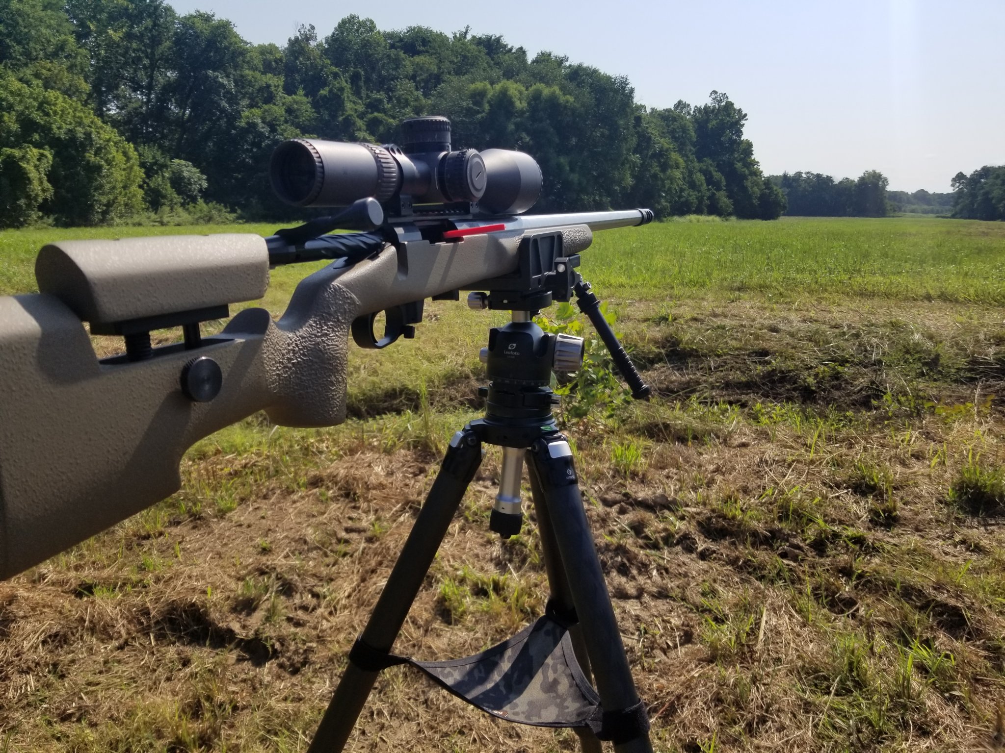

My A5/Zeus and A3/impact were very accurate, however they were not bedded. Repeatability of swapping stocks/taking barreled action out of stock was plenty good enough to shoot steel or hunt, etc. Always within a few tenths of a mil. I had a GAP Crusader in a Mcmillan A5 that was bedded by GAP and it was dead nuts repeatable every time I bolted it back together. So I can say after 5 custom/semi custom rifles the Bedded GAP and the Manners mini chassis behaved the same. The non bedded McMillans were still terrific, but I could always perceive a very slight deviation with them.
1 - bedded GAP 300wsm
2 - McMillan A3, Impact not bedded
3 - Mcmillan A5, Zeus not bedded
