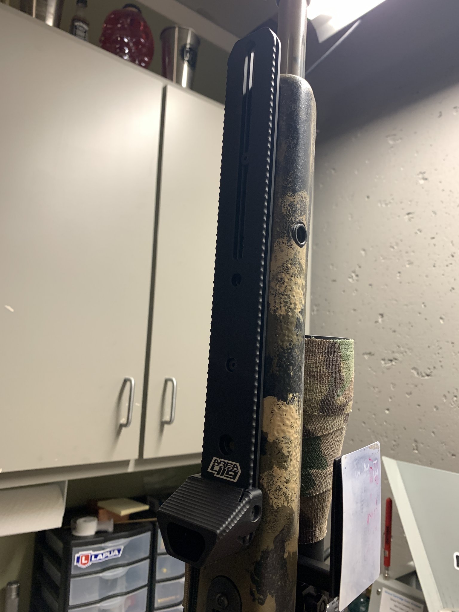

I emailed them to ask and the CS guy didn't know for sure but said most likely I would need to add a t-nut. I just wanted to check with someone before I ordered it. Did you go with the 12" or 10" rail?
Granted mine is in a PRS1 stock for the 457 but I did not use the action screw. It isn't long enough. I'm using 3 t-nuts in the barrel channel. I believe its the same for the T4. Double check with Area 419 for certain.
I put one on a T4A. I could have used the action screw, but choose to add a T nut. The bigger issue for the T4 is that the fore grip is not completely flat, so the arca adapter will not fit perfectly. I ground some on the back of the arca rail to get it to fit the way I wanted. The PRS1/2 fore grips are flatter, so for those you can just bolt the arca adapter on.
Reactions: msting22
Got it all installed and it was cake.
I went with the 12" rail and it worked out perfect for the T4.
