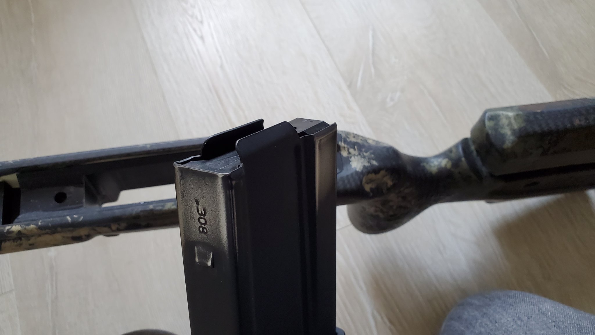

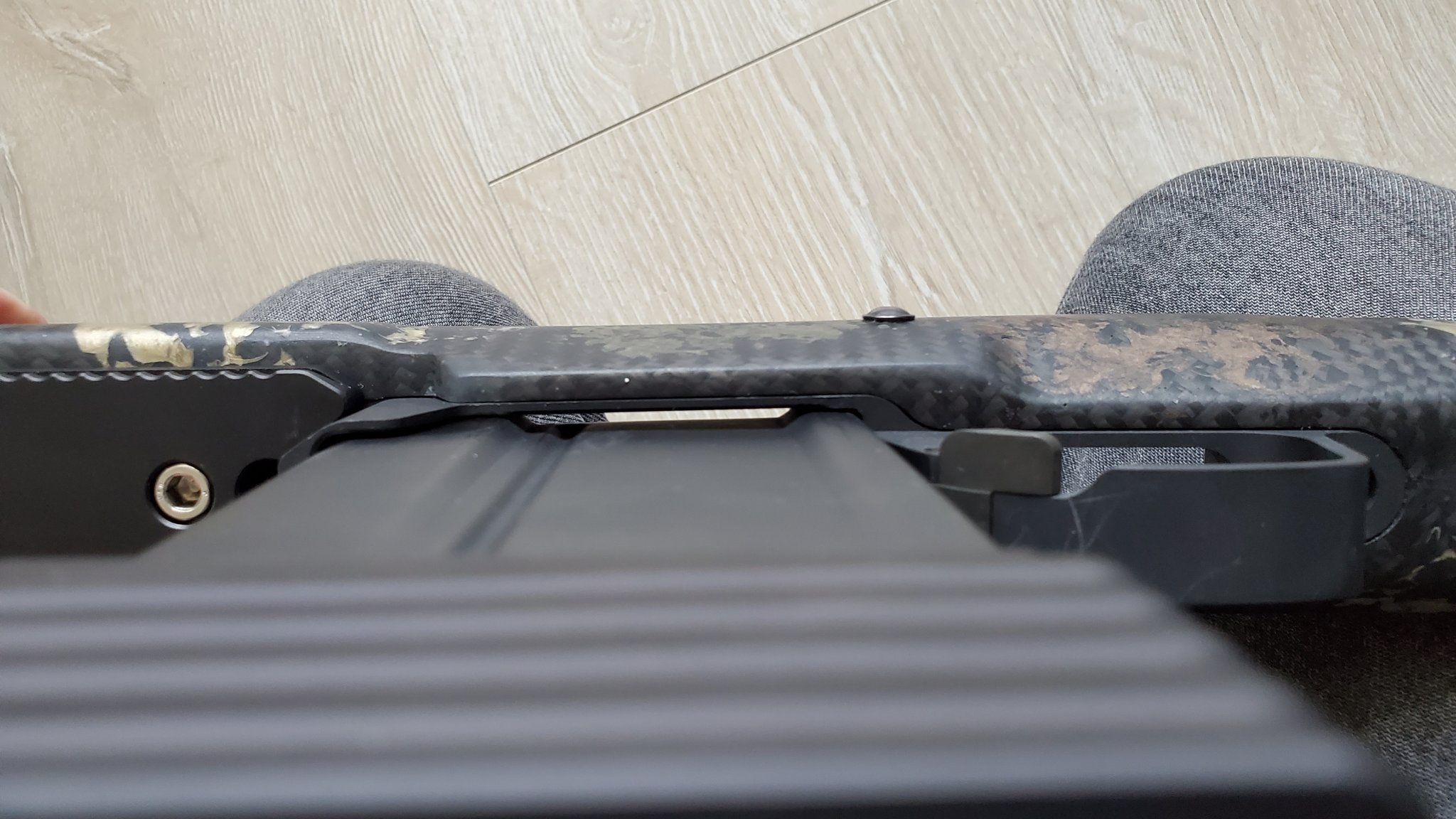

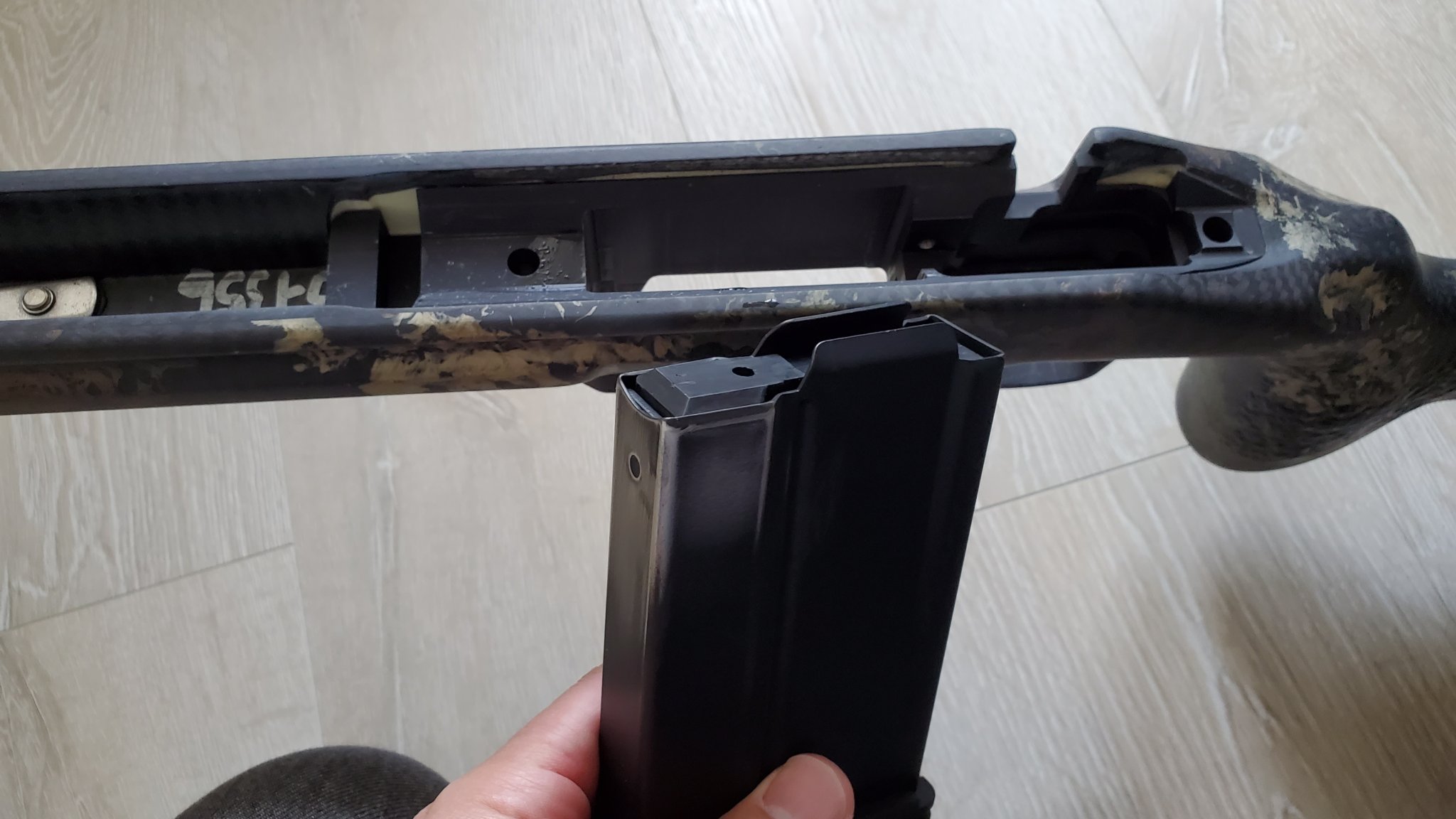

    I have manners tcs with the mini chassis inside. Looking for magazine compatibility...
    AW magazines went in and dropped out cleanly with push of mag release. Totally one-handed operation.
    Magpul PMags also went in and dropped out cleanly with one hand. Was rattling around and a little looser though.
    AICS Magazine absolutely did not work for "MY" specific chassis. PITA to get in and bigger PITA to get out. They would not drop. I really had to yank it out. I even have the Area 419 weighted bottoms. I sanded down my magazines trying to remove all of the finish around the top and it was only a marginal improvement. I don't think this is one of those "run it and it'll get better" situations. It almost feels as if the mini chassis and my bottom metal combo are not long enough for how long the AICS magazines I have are. Width is fine, but length is where it is binding. Also had to even press the mag release, so perhaps my combo just isn't going to work even if it works for others.
    Anybody else have the same issues with AICS magazines in a Manners TCS? If so what was your solution? Could this possible be an issue with my mini-chassis? I'm considering taking lower grit sand paper to the mini-chassis itself rather than jack up the magazine, but am hesitant.
    I want to drop in 6 dasher BA. Curious to know what the 6br and 6br variant shooters run for magazines on the Manners TCS?
    UPDATE here:
    Just bought the MDT 10 round 6br/Dasher magazine and they also don't fit MY manners. They are equally as tight (bad) as the AICS. Odd that different people have different experiences with different magazines. Is this the result of the Manners mini chassis? I don't know...but my Hawkins metal in the foundation takes everything just fine.
    Recap:
    AICS --> Did not fit
    MDT Metal --> Did not fit
    Magpul polymet ---> Fit but loose
    AW Magazine -->Yes, it fits. The ONLY one of the four I tried that fits.
    Honestly....what is with this randomness...
