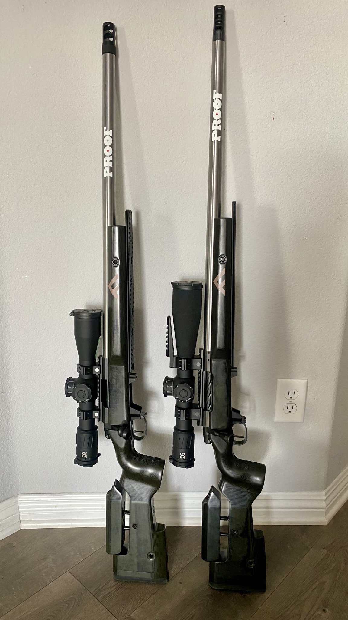

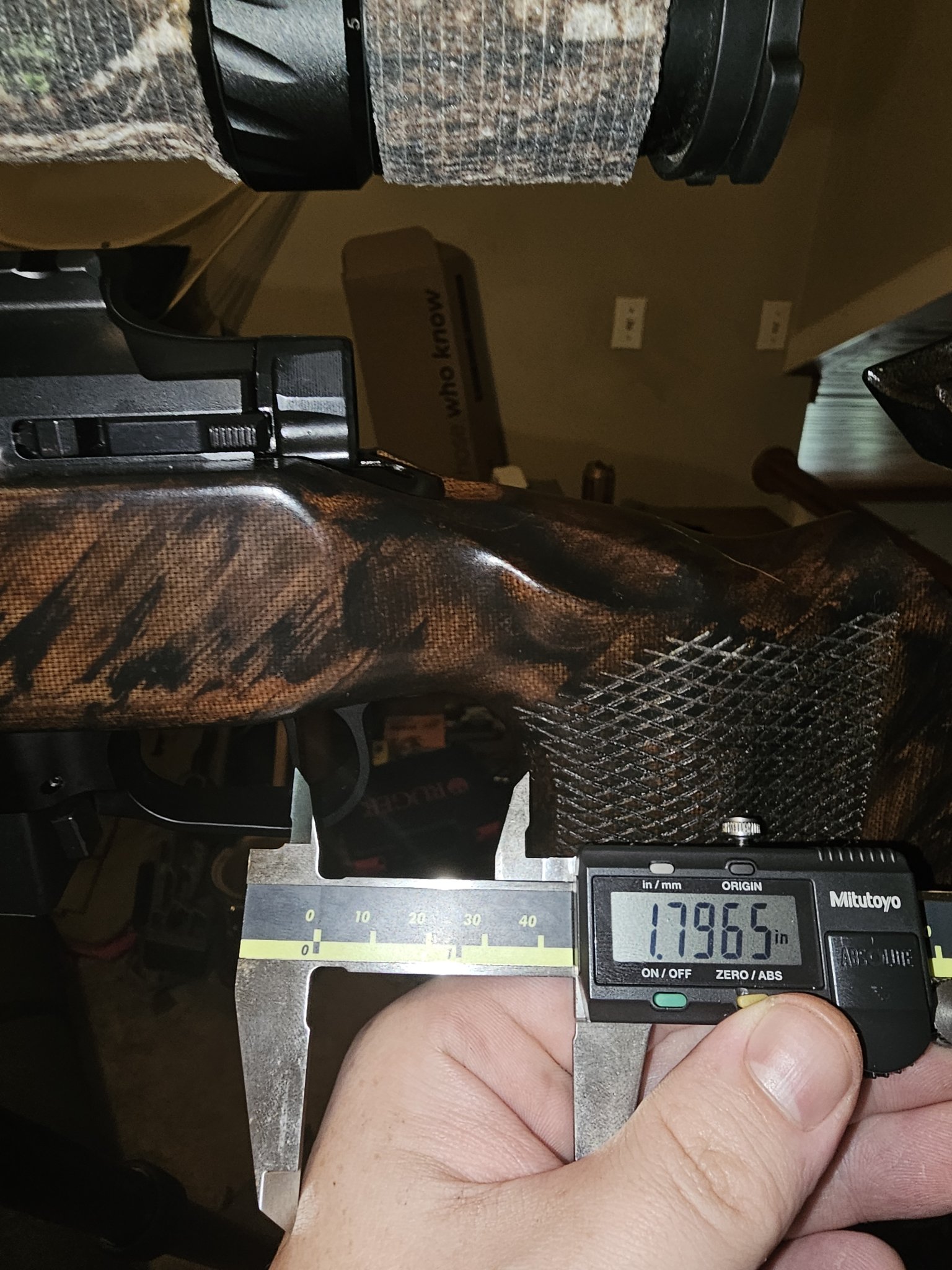

I have the centurion grip version of the Samson. it's very vertical and the spacing is short, fits my average hands and this flat TT trigger and to me it's just sublime, like a glove, just the right position of trigger finger.
I think the other version is for longer trigger distances to grip I think.
I can provide pics/measurements of the centurion style, just let me know what you want to see.
definitely call up John Kyle Truitt and get his thoughts about what would suit you.

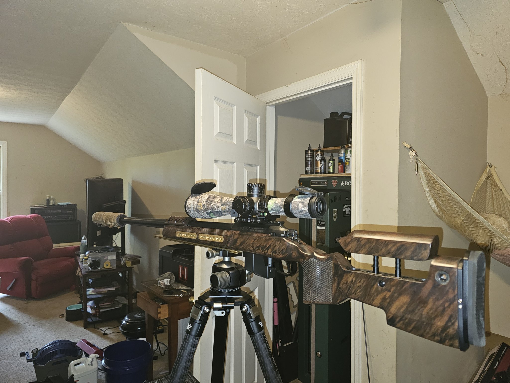

similar ergonomics to manners, much more weight. I LOVE it.
ETA the only thing I'd change on mine is I would not have ordered the brass weight kit. it balances well without any weights and I could have saved 100$ but the brass looked cooler so I did what I did.
26" proof comp contour
definitely call up John Kyle Pruitt and get his thoughts about what would suit you.
similar ergonomics to manners, much more weight. I like it.
It's always great to hear such positive feedback about the stocks. I'm assuming the measurement from the grip to the trigger would be similar at the top of both grip versions, but I could be wrong. I can reach out to Foundation about that.
Do you think you could show me the measurement on yours between the middle of the trigger and point on the grip level with that? I have the Flat TT also and really like it.

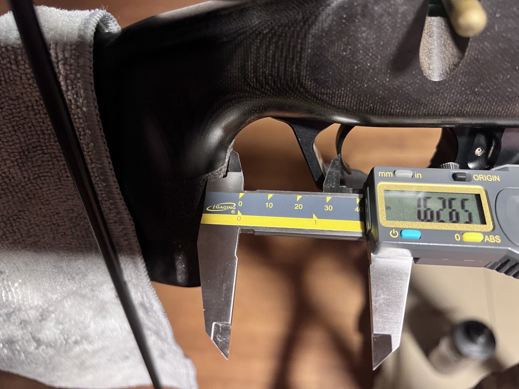

With a TT Diamond Pro-curve my grip to trigger measures around 1.95" for a Genesis MG2 and 1.75" for the Centurion. I don't have the Manners TCS stock but I do have a Manners EH1 and the Genesis MG2 feels more similar to it than the Centurion does. Centurion is closer and more vertical.
