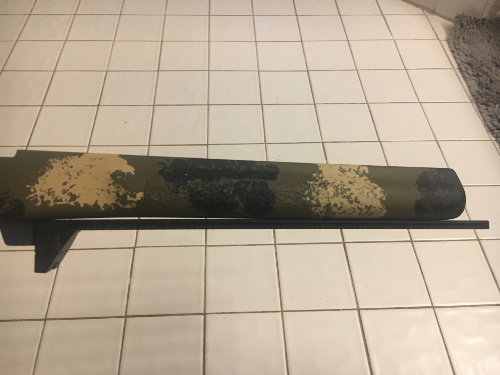

I am just installing an Area 419 Arcalock 14” rail on my brand new Manners TF4A with Gen 2 mini chassis. There is a big gap between them starting about a third of the way back. Is this normal? Any ideas on the best way to correct for it? If I install the middle or rear blind nuts and tighten it, it’s going to bend the rail. Open to ideas and suggestions.
I'm in the same boat.
I'm planning on inletting mine to sit flat. Right now the action screw is tight, I have two small screws on the fore end, and where the manners barricade stop was there is a spacer there. I don't like it, but won't have time to deal with it until June. It works for now. It's tight and doesn't flex or cause any stupid problems. Just looks like crap. I wanted the rail backed up to the mag well also. My V22 doesn't balance well on the tripod further forward. I was half tempted to bed the rail, to take up the gap. But I just can't make myself do it
