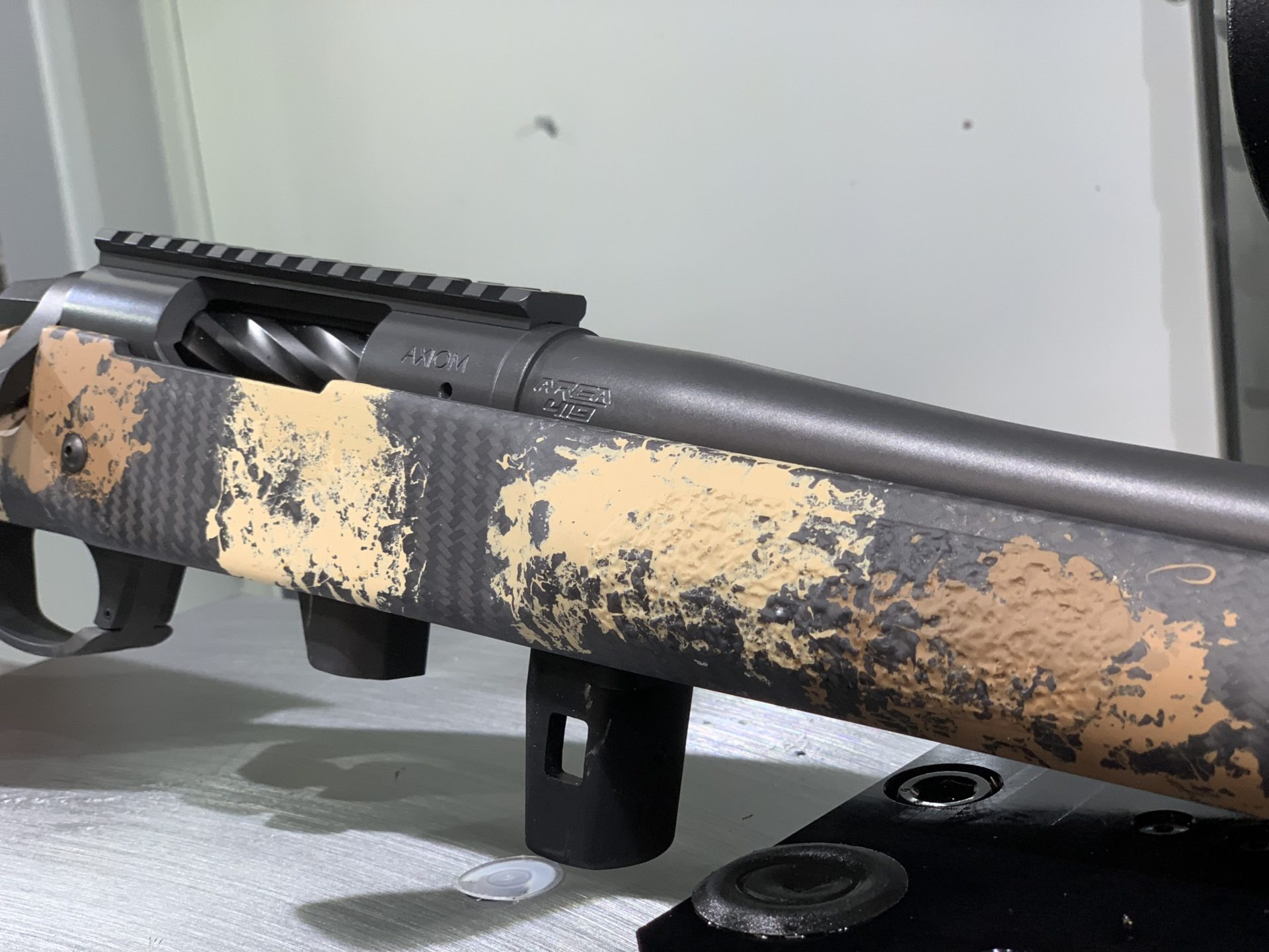

See how precise that inletting is for the bolt release? That won't work for my Terminus Zeus which has a vertical bolt release.
And look at this pic, this was not the action perfectly mated for this inlet. You can see that the ejection port is not perfectly aligned with the inlet. It'll shoot fine, just not perfect.
