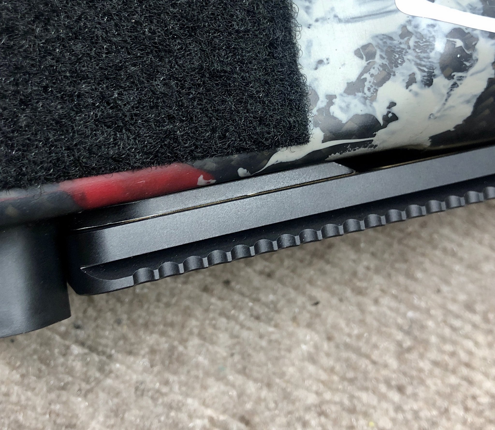

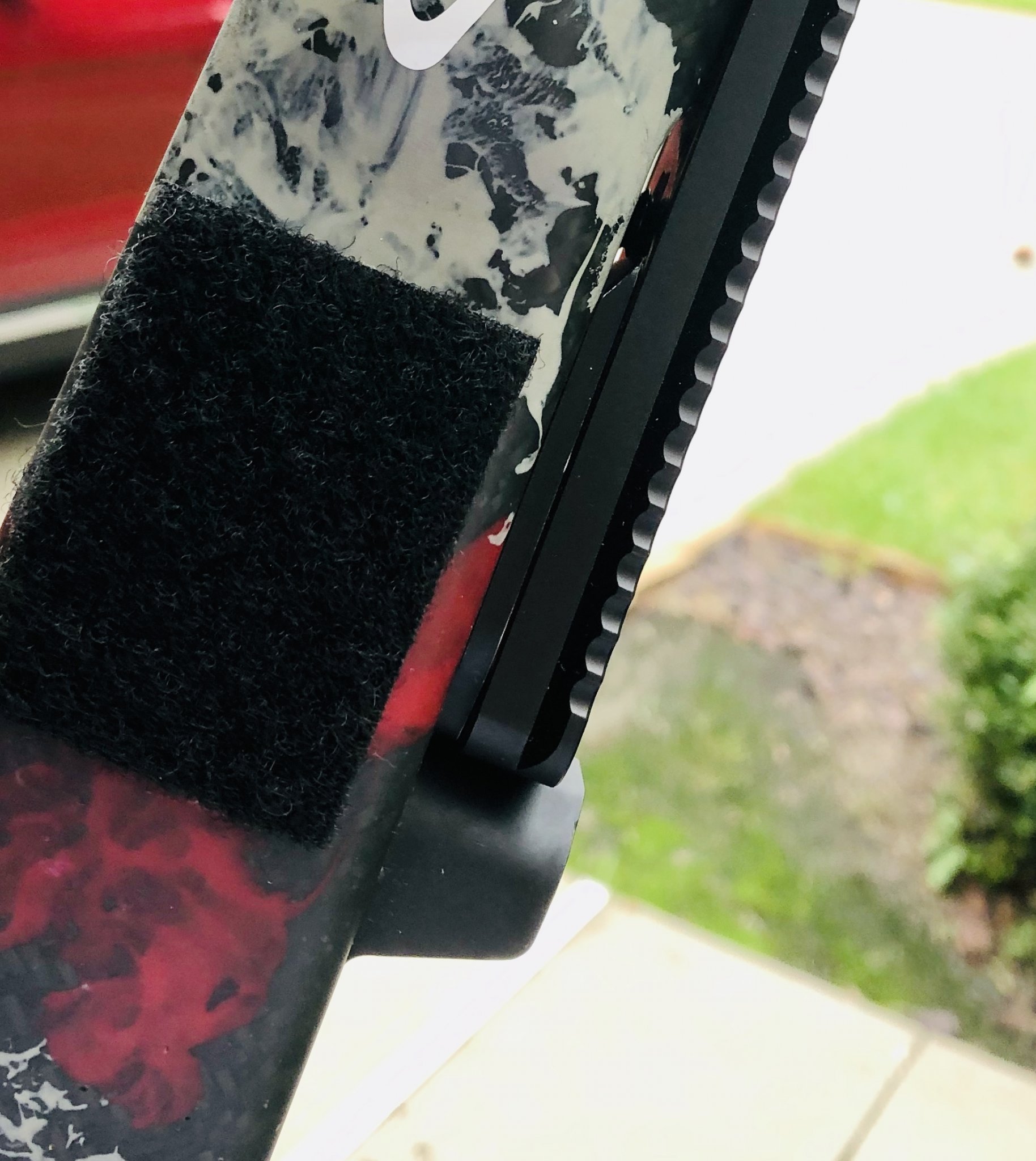

looking for pics on fit of an area 419 tunable arca swiss plate on the manners t4a since the bottom is not flat. I wanna get a look at the gap if someone has this set up id appreciate it. Thanks
Not a T4A, but just in case it helps, here’s a T5A. I had my Gunsmith from GCP Rifle Co., modify an Area 419 T6A plate. He had to cut it down to .115 and then screw it onto the rear weight to cover as much of the gap as possible. Figured you might be able to do something similar.
