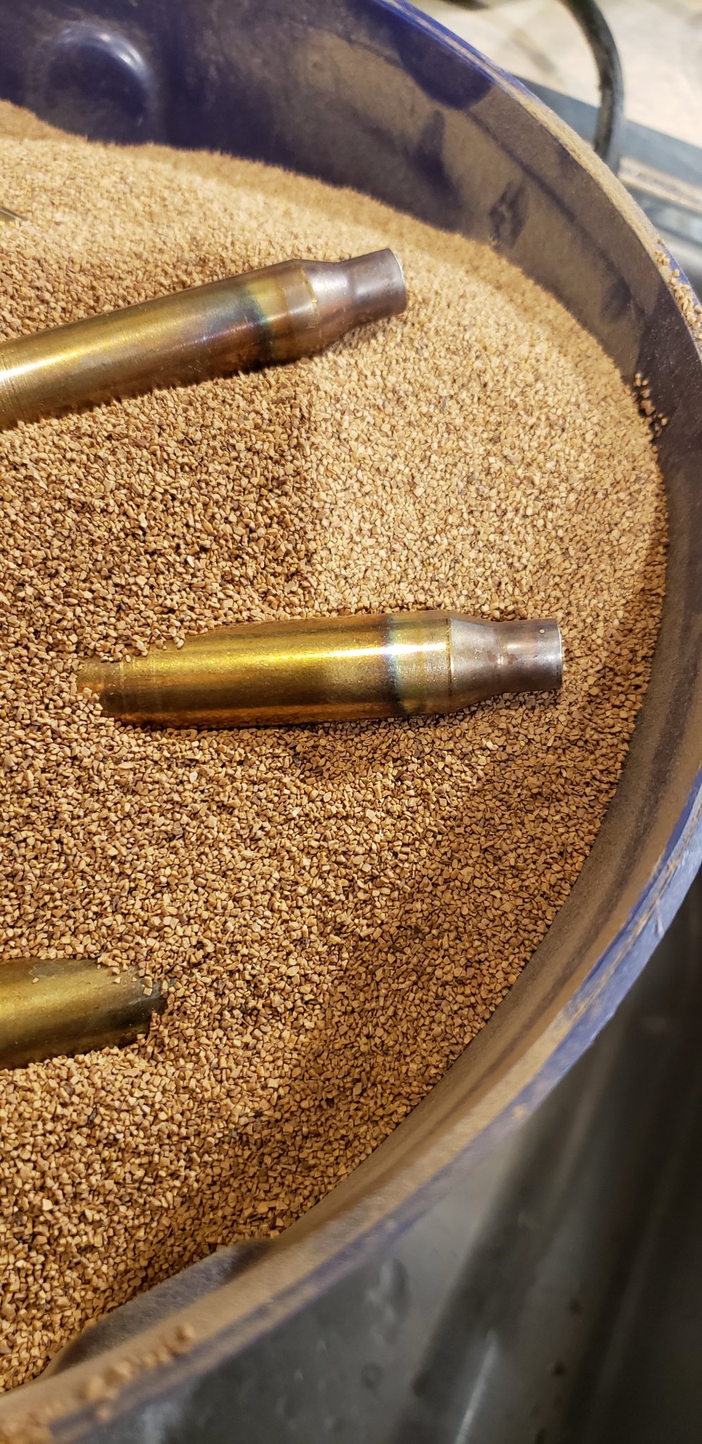

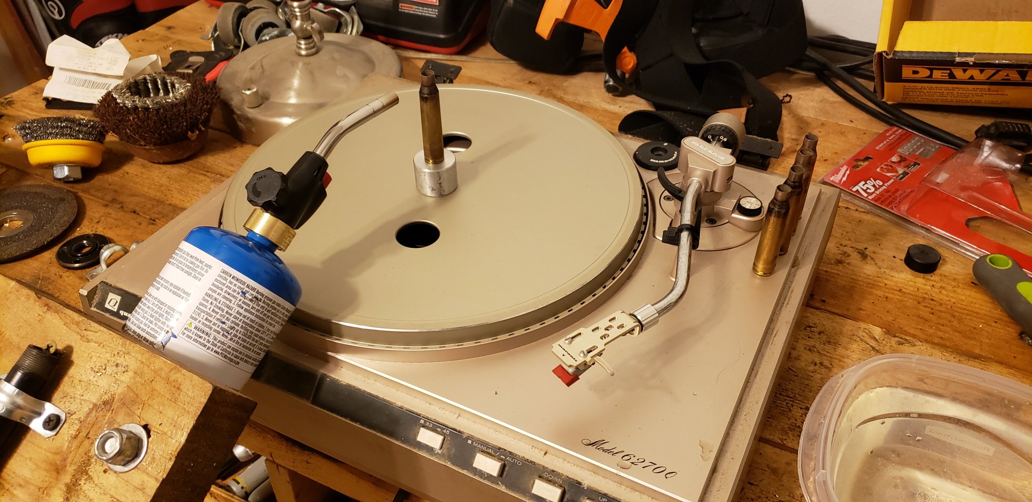

Marantz 6270 annealer....made an adapter that goes on the center pin of the turntable then the adapter has a nub that goes into the primer pocket. Continuous stable rotation. Brass on, brass off Danielson. The torch is on a boom mic stand. Angle and height adjustable

I selected the fastest speed. :D I wish it was faster but I tried a couple test rounds and it seems fine. The amount of time I have to leave it in the flame to get a good color change is pretty suprising. It was like 8 seconds
