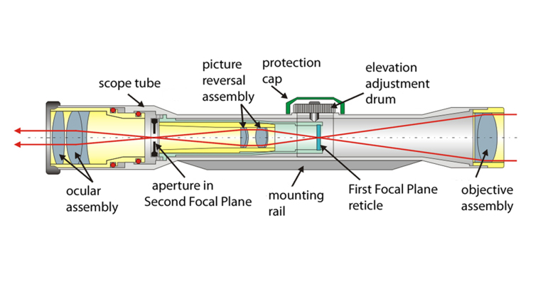

I don't have any technical knowledge in optics but maybe because the SFP and FFP reticles are slightly different distances from your eyes that it's hard for them to keep them both in focus at once?
A practical solution I guess would be to accept the slight blurriness for the SFP as it doesn't matter as much for short range shooting and go for clearest distance reticle since that's where a crisp reticle would be most useful?

The March 1-10 I owned had a very shallow DOF, so your parallax adjustments had to be spot on and, even then, objects in front and behind often were OOF. I
I’m wondering why the info is so contradictory then. Did you play with the diopter at all? Maybe the Gen 2 changed some things
It should be noted that there are at least 3 models of a March 1-10X24 LPVO. There is one that is over 10 inches long and weighs 19 oz. This is an earlier model. The next one is the 1-10X24 "Shorty" LPVO. It is 8 inches long and weighs in at about 17oz. This was the one with the 30mm tube and the 33mm objective diameter. This was replaced by the current March-FX 1-10X24 Shorty with the entire body at 34mm. It's still around 8 inches but weighs 20z. The two shorties have identical optics, as far as I know. The prior model is different. @freedom71 does not specify which model he has, but if the tube was 30mm and could be mounted in regular rings, that would be the earlier, longer version.

I'm wondering if you mean depth of field (DOF) instead of parallax when you mention it's "parallax sensitive".
If you mean DOF, then I will point out that at low magnification, the DOF is quite extensive, but since this is a 10X zoom, when you get towards the top end, the DOF will shrink rapidly. I think this is what surprise folks who are more familiar with 3X, 4X or even 5X zoom ratio. They just keep on trucking up to 10X zoom and realize the DOF has shrunk much more than they are used to when at the top magnification of a smaller zoom ratio optic.
It's the same with the 1-10X24, people are used to going up to say, 6X and the DOF is still quite good there, but it drops rapidly going to 10X, hence the criticality of the side focus in such optics.

Yup, DOF. But of course, you must use the parallax to reel that in. Having been a photographer back in the day, DOF used to be my friend.
When competing dynamically, it can be an annoyance.
If I shot statically all the time, I wouldn't give it a second thought.
