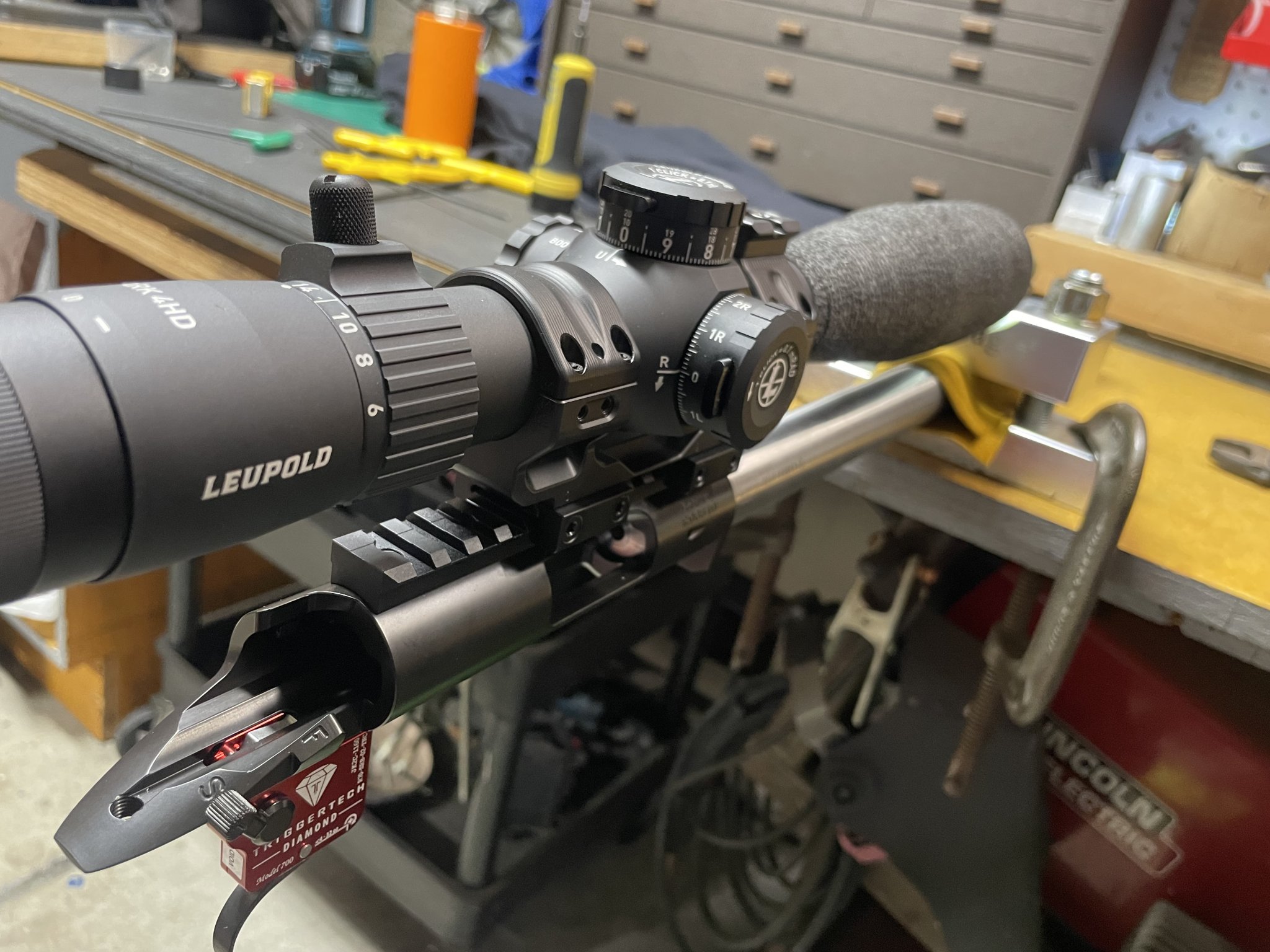

New MK4hd. Referenced scope bottom and turret for level. Mounted to spec, and checked reticle via flashlight, off by 1.2* from turret checked with pulse. Unmounted and verified everything 2 times with same results.
I dial so am planning to follow level scope and then verify via tall target.
Am I doing the right thing here? Did I miss a step? Should I just be sending this for warranty work?

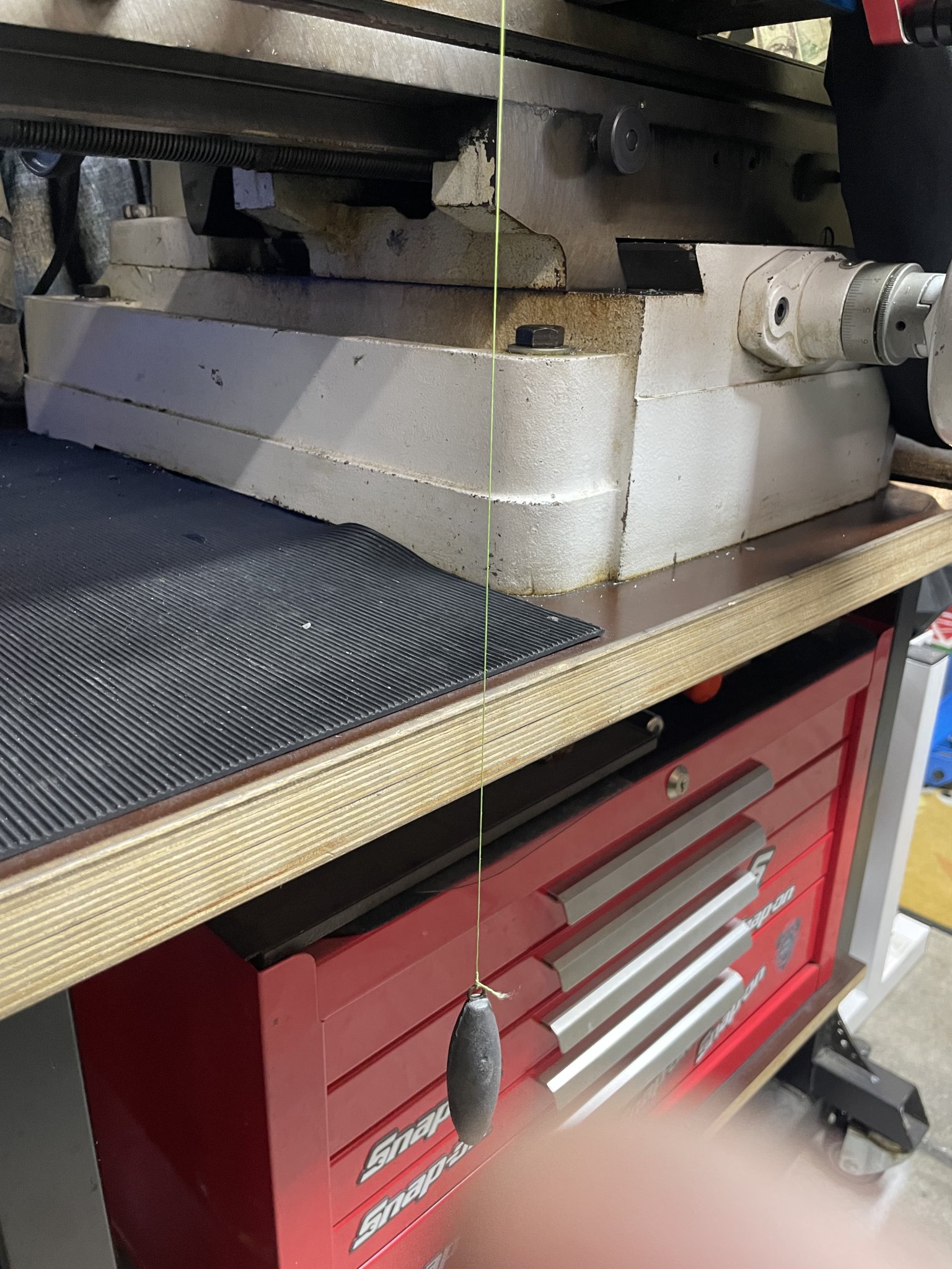

There are 3 things here. The orientation of the tube, the turret tracking and the cross hairs being plum with gravity. It's possible the turrets and the cross hairs line up but the tube is not perfect centered with the bottom of housing. Set the reticle with the plumb bob and a level and then do a tall target test. If everything tracks then just live with it. The bottom of the housing is really just a reference to get super close. It should be dead on but not the end of the world if the tracking lines up perfectly with reticle.

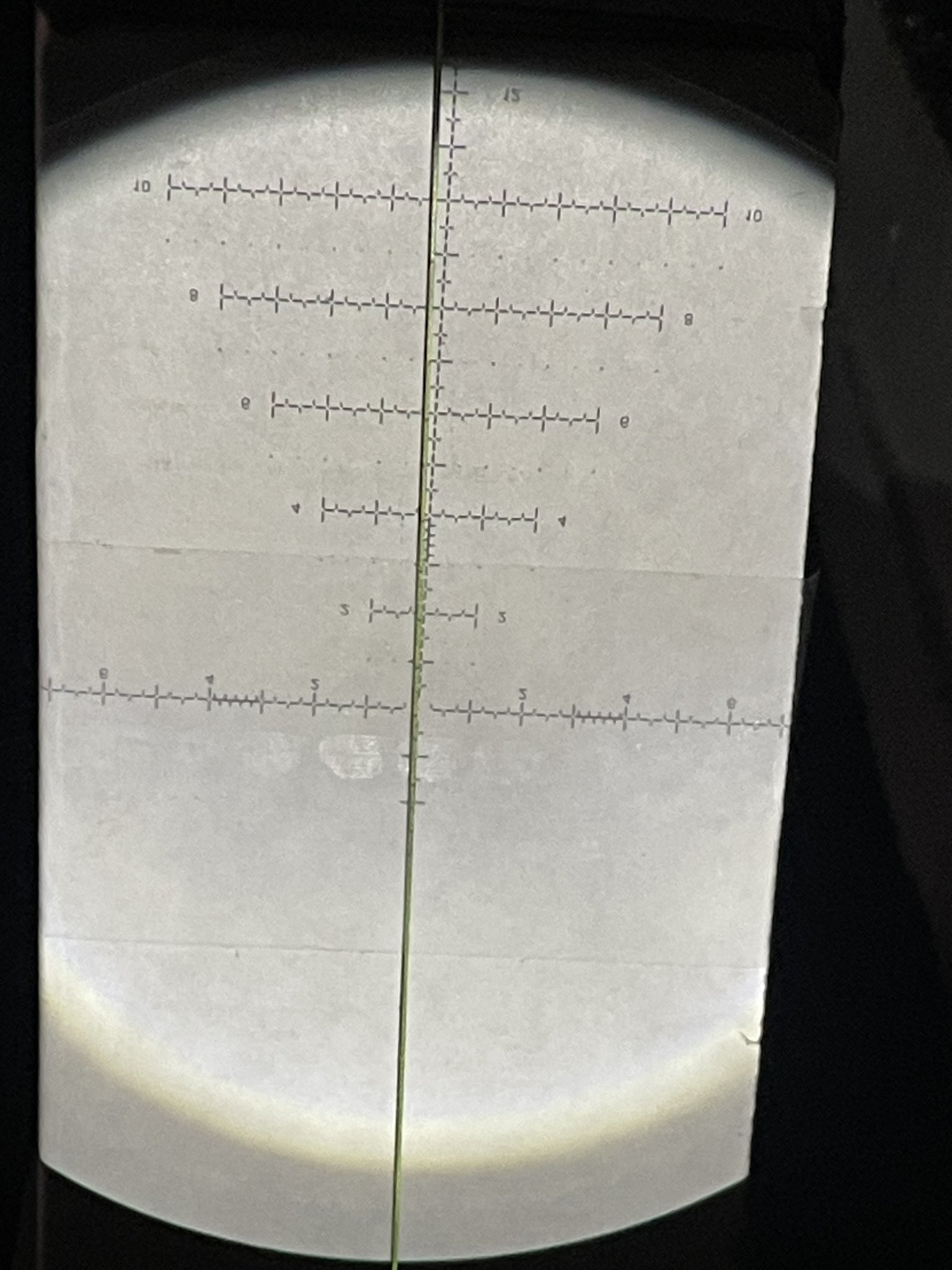

I would have leveled the reticle to the plumb line, and then dialed it fully through the travel. If they deviated then you have an issue. If they stay together then there's nothing wrong.

You’re probably right. I used a granite surface plate and gauge blocks to find repeatable surfaces on the housing. I’m relatively confident in the equipment, but maybe I over complicated the process. This just happens to be the first time that I could not get plumb & level results. I was actually surprised at how obvious it was when I got behind the scope.
I agree with the guys saying to level the reticle with the plumb line and then see if it tracks... if it tracks, then it's useable, and then you'd just have to decide if having the scope body canted bothers you enough to bother sending it in?

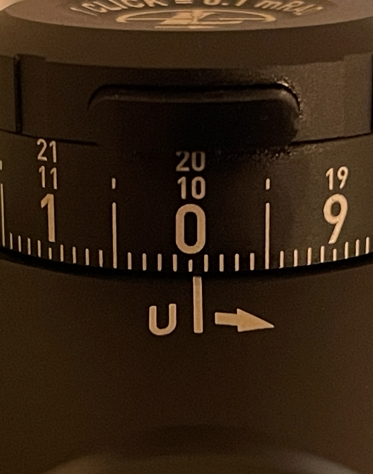

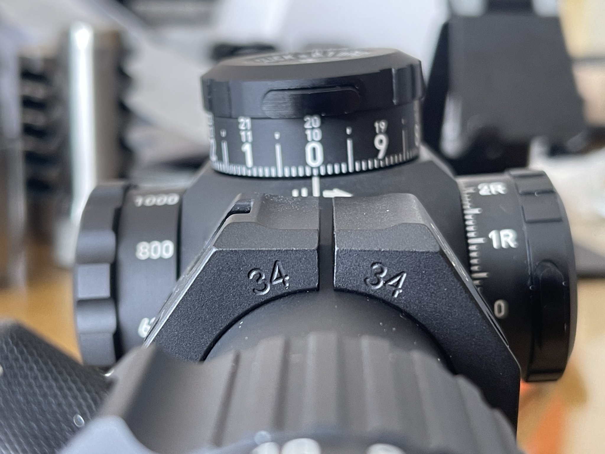

Got my MK4 back. Turnaround time was just a little over 6 weeks. Surprisingly they didn’t replace the scope which I’m fine with. I would rather they fix versus play the new scope I hope there is no issue lotto.
I sent it in for two issues. Turret marking alignment and for a canted reticle. The included service notes did not mention them addressing the reticle so I guess I’ll tall target test next time I’m out.
