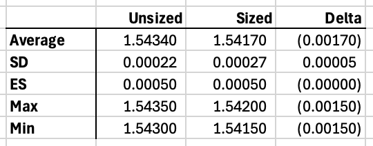

Variance on headspacing is very impressive - my headspacing ES works out to +/- 0.00075 (3/4 of 1 thou) across 200-300 pieces. I can't beat that with my Rockchucker. I've only once seen headspacing ES above +/-0.001", which was due to inconsistent application of lanolin. Seating bullets & primers are very consistent as well.

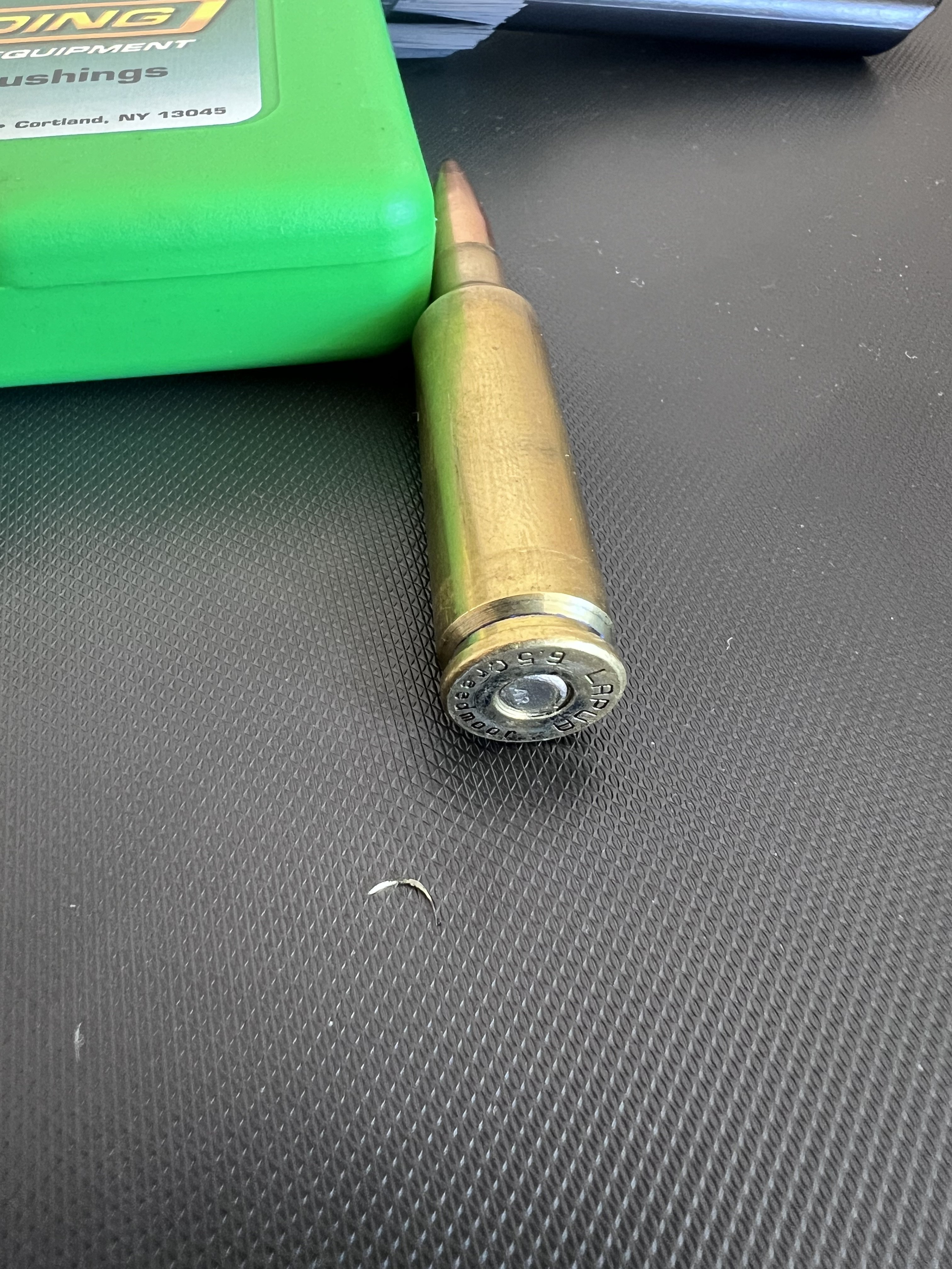

1) Everyone complains about priming, but they're doing it wrong. I was doing it wrong as well & had the same issues. After about 2k loaded rounds, I placed a Cortina mandrel die over the priming station to hold the case in place during primer seating That change immediately & completely resolved all priming issues - I haven't had a single priming issue since.

e: I have a better example than this, can't find the .xls right now...

I’m still surprised by the headspace numbers. It usually works out to something like 75% hitting my 0.0025” target, 10% under sizing to 0.0020”, & 15% over sizing to 0.0030-0.0035”. Again, your lubing process is critical. I never got One Shot to work as well as lanolin.

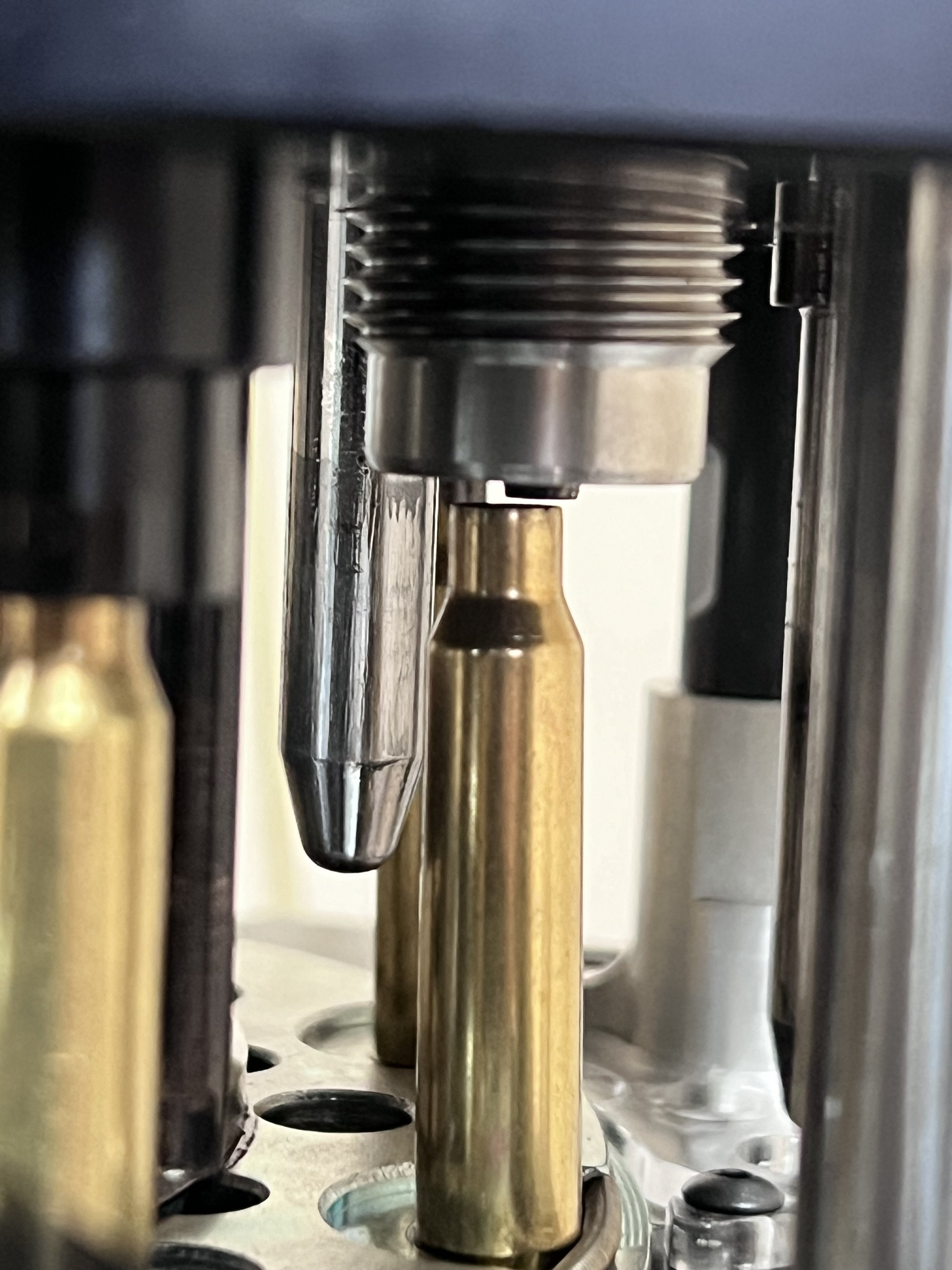

223 are a little more sensitive to the case retention spring around the shell plate. They’ll tip if it’s too tight & the necks will be crushed on part of the die. Very easy to set & adjust, just watch for it
Here, the case is tipped due to an overtight spring & the foot inside my Lyman holddown die would crush the neck if I didn’t stop cycling:
